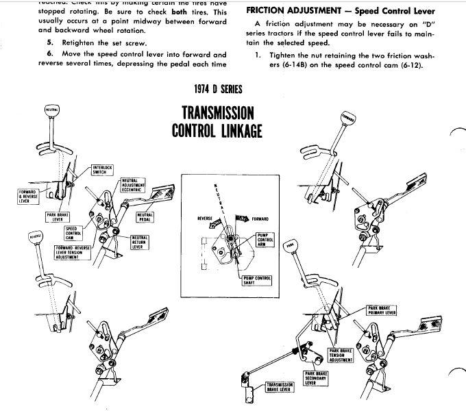

pfrederi 18,642 #3 Posted May 10, 2019 (edited) D series motion control linkages are complex and can be frustrating to get adjusted correctly. Try the friction adjustment shown in the picture . You can download the manual here. Edited May 10, 2019 by pfrederi 1 Share this post Link to post Share on other sites
giantsean 59 #4 Posted May 10, 2019 Thanks... I actually found the Sunstrand manual last night and that's exactly where I was heading when I started tearing into it, exactly right when it started raining lol. Leave it to WH to make an access plate upon which things bolt to and provide structure too... because why not? So anyway, I took apart the vestigial brake mechanism and rod (just hanging there) and tossed it in the pile as it does zilch at the moment, took the jam nuts out and found a spacer upon which the bracket pivots had fallen out and was jamming up between the plate and the stud. Trunion shaft nice and free... I think the entire neighborhood heard the sigh of relief :P. I have been grading dirt and knocking it around a bit, so it may have just come loose at some point. Got the mechanism back together and ditched the whole shebang until it stops raining. This is not the first time I've had to deal w/ the suspect engineering of the D-series motion control system. This frame in an earlier life was a 73 or 74 w/ the parking brake mechanism built into the motion control. The pivot point for the arm simply friction fits to the plate that moves all these rods and levers. When it comes loose, it just falls off and no more motion control. Unless you are already moving, and in that case, no more stopping lol. This happened to me exactly once and I was able to shut it down before it drove the the back of my garage. I luckily had a newer style spare which did the trick. Still I wonder what those engineers were smoking when they designed that. I also learned while in there that my hydro pump appears to be simply held in by gravity alone lol. I doubt that's actually true or it would be spinning all about, but there are several mounting holes w/o bolts. As it's a repower the PO may have had alignment problems and this was the only way to make it work, but something I'll have to look into later. I'll post pics later on another thread to get some ideas. Share this post Link to post Share on other sites
