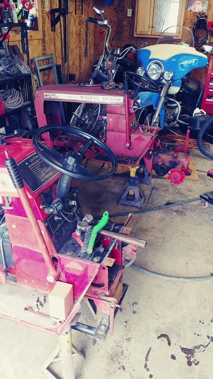

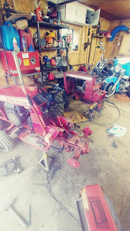

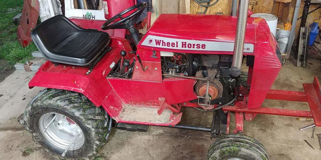

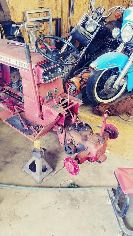

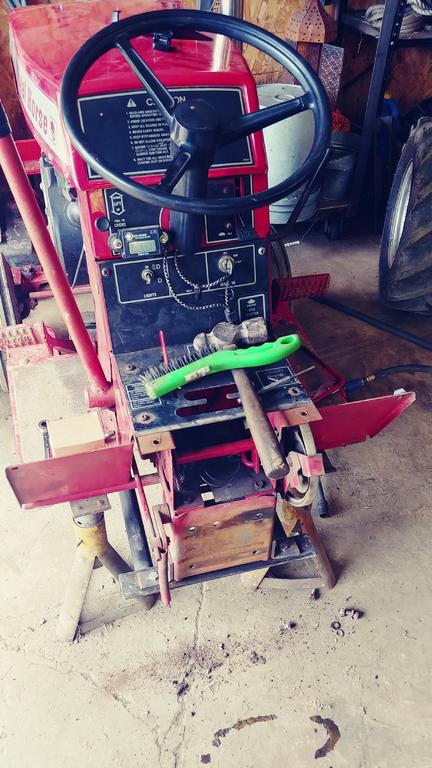

Ralph S 342 #1 Posted May 4, 2019 I broke something in the rear end of the 310-8 last week. A friend of mine donated a C-111 parts tractor to me and Bam ! I'm back in the game. 2 Share this post Link to post Share on other sites

Ralph S 342 #6 Posted May 4, 2019 The C-111 was one year only but the rear end was used in a lot of models. It does have the 1-1/8" axles and the 310-8 had 1" 2 Share this post Link to post Share on other sites
