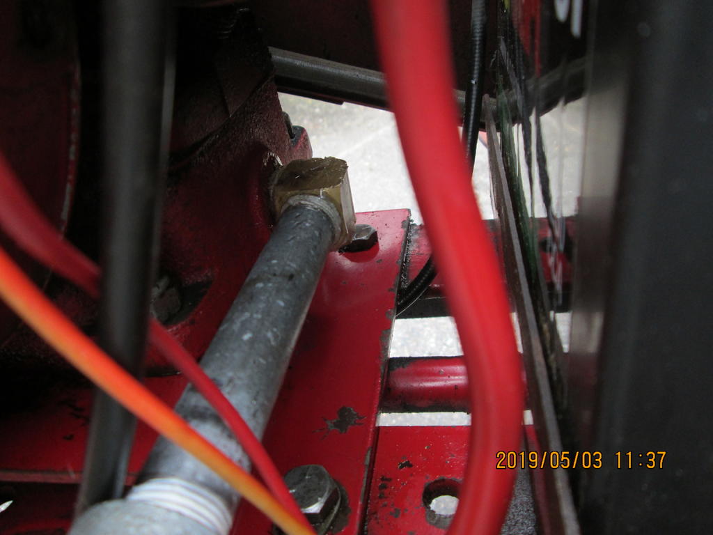

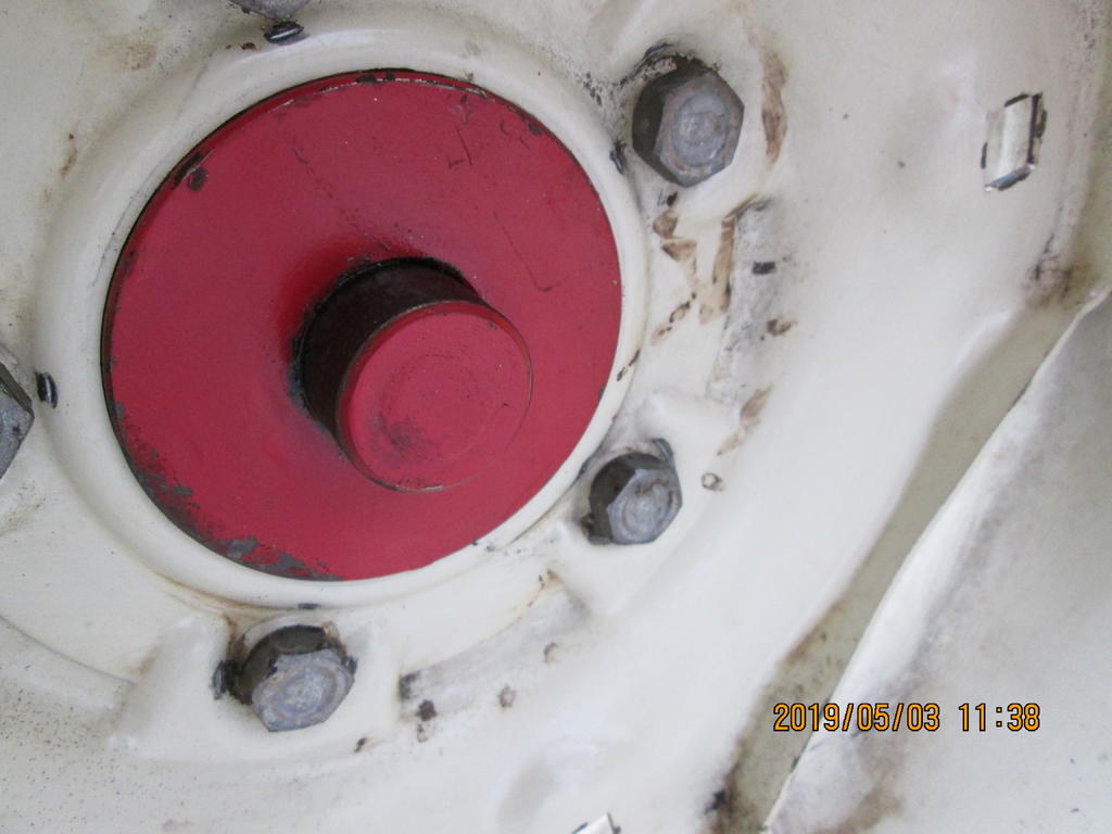

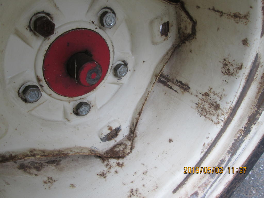

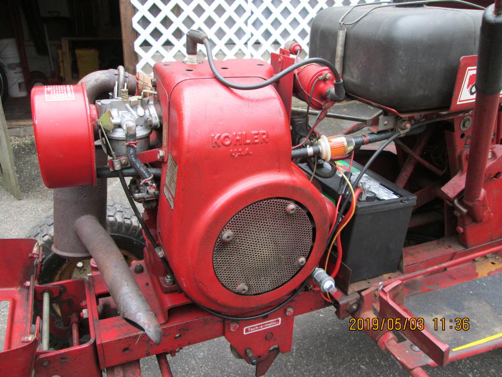

Retired Wrencher 6,114 #1 Posted May 3, 2019 Here is a few picks of what I found today. The shot with the oil drain was leaking very bad I know bad shot. So I have what they call Seal All. Resists gas and oil. So far no leaks. It never surprises me how things happen to these fine tractors. Not sure about the tranny with the shaft sticking out? I have never seen this. Any info is welcome. 2 2 Share this post Link to post Share on other sites
Sparky-(Admin) 23,909 #2 Posted May 3, 2019 Loosen the hub set-screws and move those hubs out to be flush with the end of the axle. All ya need is a 9/16 closed wrench and a 3/8 open end wrench 2 1 Share this post Link to post Share on other sites
Achto 30,054 #3 Posted May 3, 2019 Your hubs are most likely loose, this would be why they slid in. If it continues to happen, add a second set screw 90degrees to the original one. Looks pretty good in the rest of the shots. 2 Share this post Link to post Share on other sites

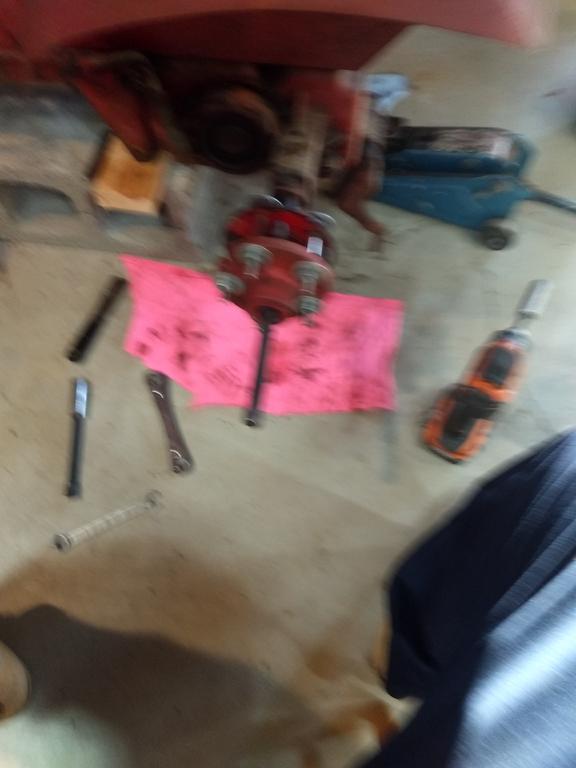

Retired Wrencher 6,114 #4 Posted May 3, 2019 1 hour ago, Sparky said: Loosen the hub set-screws and move those hubs out to be flush with the end of the axle. All ya need is a 9/16 closed wrench and a 3/8 open end wrench Mike & Achto. The left one is frozen there both off the key way. So they are tight on the shaft. I have no heat to move these. I guess I can use it as a summer tractor only. Or light plowing. Or find some heat to move them back on the Key way. 1 Share this post Link to post Share on other sites
JAinVA 4,638 #5 Posted May 3, 2019 (edited) If I understand correctly the keyway in the hub is not aligned to the key in the shaft.That key is a lot longer than the axle length sticking out.I would guess that the hub sheared off the remnant of the key and welded it self to the shaft.I'm glad I don't have to deal with it! Edited May 3, 2019 by JAinVA 1 Share this post Link to post Share on other sites
ebinmaine 75,067 #6 Posted May 4, 2019 Looks like at least one of the hubs is still in the correct place. As stated above, both are too far in. If they don't move because they're rusted in place don't worry about using the tractor. It isn't likely they'll come too loose if the tractor isn't abused. I've seen at least one of our tractors that had the hubs in like that when we got it. I remember being under the impression the PO thought it was correct. Share this post Link to post Share on other sites
Retired Wrencher 6,114 #7 Posted May 4, 2019 8 hours ago, ebinmaine said: Looks like at least one of the hubs is still in the correct place. As stated above, both are too far in. If they don't move because they're rusted in place don't worry about using the tractor. It isn't likely they'll come too loose if the tractor isn't abused. I've seen at least one of our tractors that had the hubs in like that when we got it. I remember being under the impression the PO thought it was correct. Thanks Eric but I would like to get the right one off it has a bad seal. I have some Map gas and maybe look into getting a puller for this. Share this post Link to post Share on other sites
ebinmaine 75,067 #8 Posted May 4, 2019 3 minutes ago, Retierd Wrencher said: getting a puller for this. You may be best off to make a puller. Use an old hub and 5 bolts. This is a tough picture to see but here's how we pull hubs. Old hub on the outside of the screw and center section of a large 3 jaw puller. Share this post Link to post Share on other sites

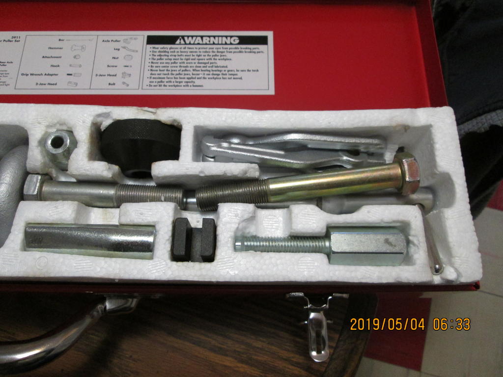

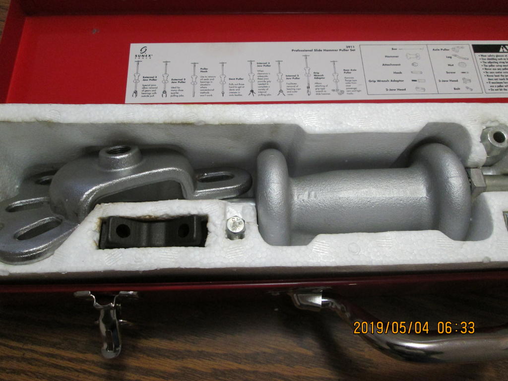

Retired Wrencher 6,114 #9 Posted May 4, 2019 17 minutes ago, ebinmaine said: You may be best off to make a puller. Use an old hub and 5 bolts. This is a tough picture to see but here's how we pull hubs. Old hub on the outside of the screw and center section of a large 3 jaw puller. Erick I have this that I forgot about. Fun to be old. It been awhile since I used this but I think it will work. The left one will take a while but that is the game. 1 Share this post Link to post Share on other sites
ebinmaine 75,067 #10 Posted May 4, 2019 Niiiice. Just remember that the cast hubs can be brittle..... Lots of heat. Penetrating oil. Patience. You'll win. Share this post Link to post Share on other sites
