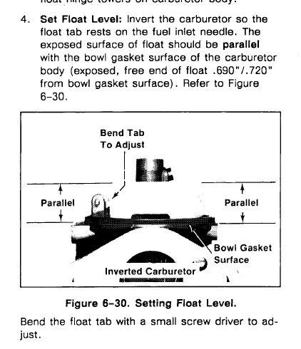

pfrederi 19,893 #4 Posted May 2, 2019 Float level is adjustable per manual, float drop is not. i was wrong about 11/64 for Walbros float should be parallel to the carb body when upside down 2 Share this post Link to post Share on other sites

AndyK149 62 #6 Posted May 3, 2019 I have very good spark, I pulled it out and can see a big bright spark when I crank. This plug is less than a year old. Boy I am really reluctant to bend the tab on the carb float, it does NOT look like the other carbs I have seen where there is a bendable tab. There is a tab that the needle clips to but it is extremely thin and fused to the plastic float and I am afraid to bend it. It looks fragile. I took everything apart again and blew air through it and re cleaned everything. It is very clean. The needle does seem to move freely when I move the float, but that is with the bowl off. I'll get some starting fluid. It wouldn't fire on brake clean or WD40. I gave up on it last night. Have had the carb off about 10 times and need a break - was getting frustrated. Never had anything like this happen before so I am at a loss. I really appreciate the suggestions. Share this post Link to post Share on other sites
