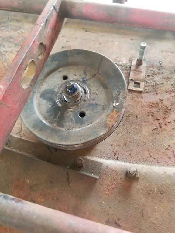

Oberg111 5 #1 Posted May 1, 2019 Can anyone help me out how does this pull come off .. I have zero side to side play but I have up and down play need to tighten it up Share this post Link to post Share on other sites
daveoman1966 3,882 #2 Posted May 1, 2019 1) Remove the grease fitting. 2)tap 2 or 3 wood wedges under pulley. 3)put BRASS drift (ball peen) hammer on top of shaft. 4) whack the brass hammer with a BFH.. That should free the pulley. Don't be bashful.. 1 Share this post Link to post Share on other sites
