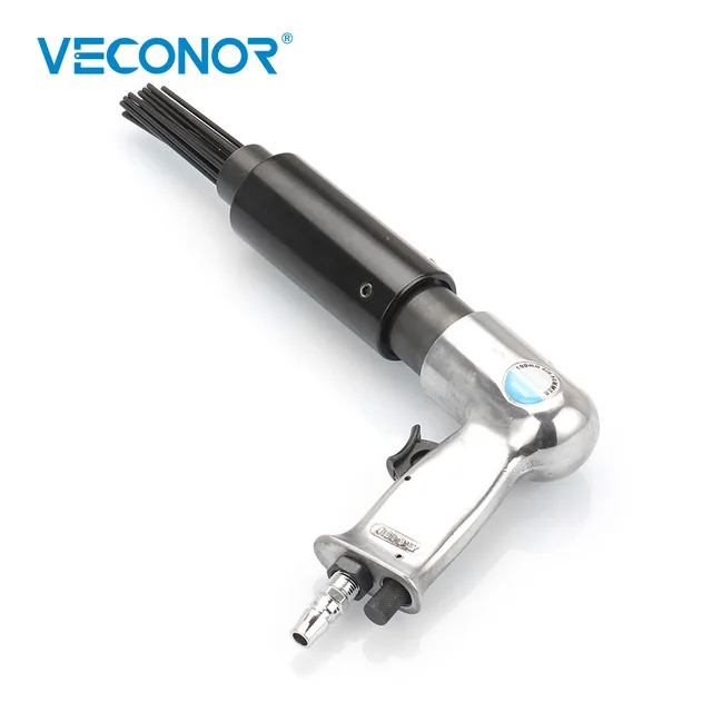

953 nut 69,571 #39 Posted May 8, 2019 As with anything that is stuck, position the offending part so you can give it several soakings of penetrating oil over the course of a week. A few members here have reported good results using a Needle Scaler on the exhaust nipple while applying constant pressure with a BIG pipe wrench. The vibration seems to help break up the rust. 1 Share this post Link to post Share on other sites
