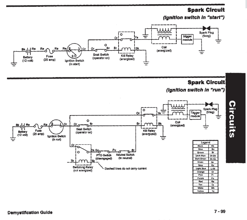

953 nut 63,123 #2 Posted April 28, 2019 There are several components between the battery and ignition coil. Any one of them being open could give the same symptoms. Be sure your PTO lever is all the way back, it could be the culprit. This guide has system by system drawings for all late model applications. Find your year and model and then locate the ignition drawing. Some times just cleaning and tightening connections is all that is needed. 1 Share this post Link to post Share on other sites
squonk 44,915 #3 Posted April 28, 2019 First place I'd look is the 9 pin connector. 1 Share this post Link to post Share on other sites

rmaynard 16,700 #5 Posted April 28, 2019 What year is your 520 assuming that is what you have? Here is page 443 of the demystification guide showing all of the possible safety switches and stuff involved to the circuit from battery to coil. Share this post Link to post Share on other sites
