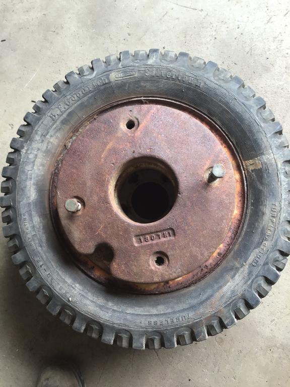

Pullstart 68,981 #1 Posted April 27, 2019 With the right sized tires, do you think the stack up would fare well to adapt a set of dual wheels? Share this post Link to post Share on other sites
ebinmaine 77,535 #2 Posted April 27, 2019 I don't know but I have to admit the possibilities look interesting there. 1 Share this post Link to post Share on other sites
AMC RULES 37,254 #3 Posted April 27, 2019 Might work... provided you run little to no air pressure in your additional set. Worth a try...what could it hurt? 1 Share this post Link to post Share on other sites

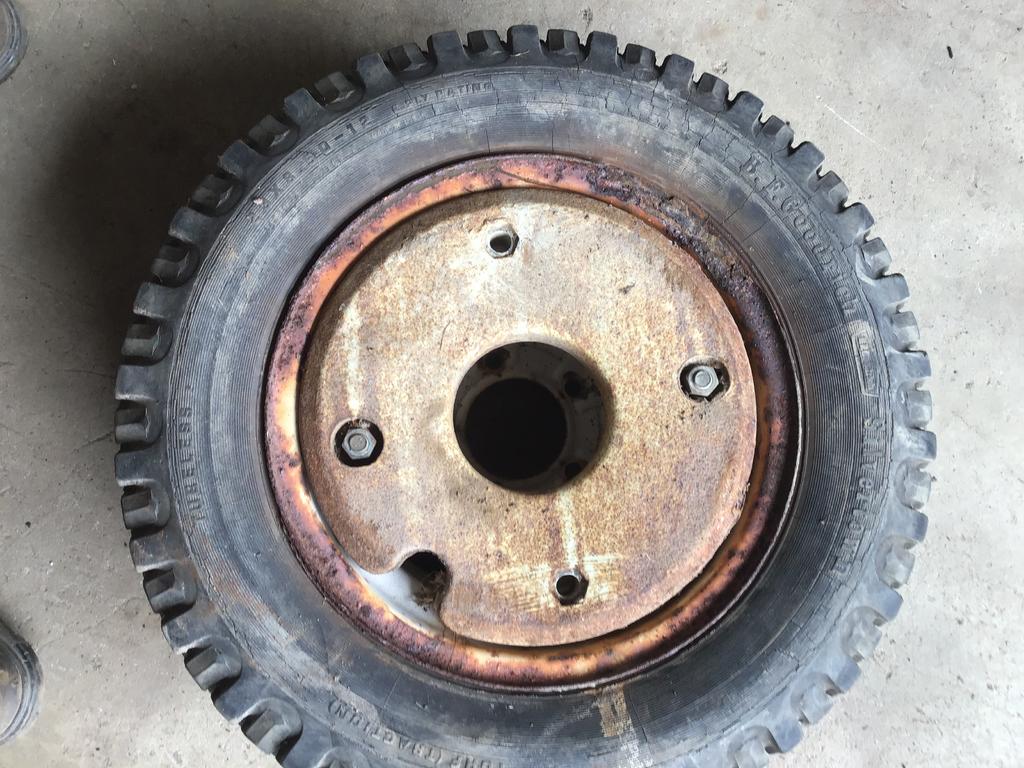

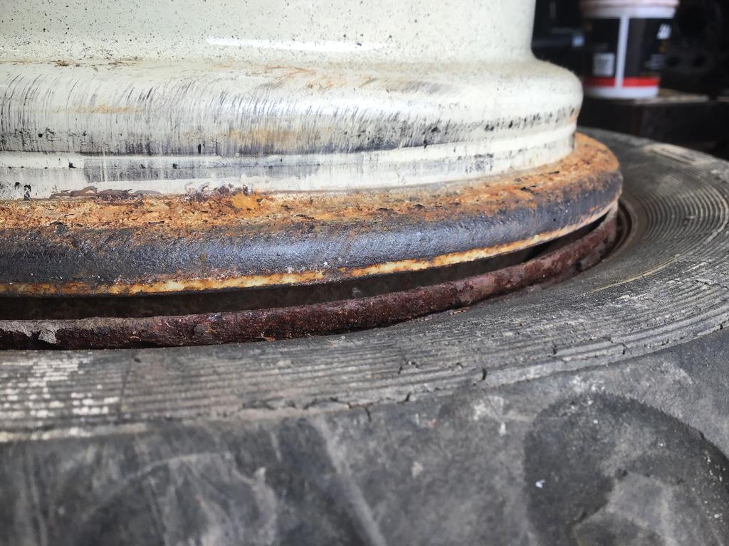

Pullstart 68,981 #4 Posted April 27, 2019 Obviously not with the actual bottom wheel the way it sits! It’s from Rylee’s new tractor, but the chloride rusted it out. Share this post Link to post Share on other sites
Achto 31,130 #5 Posted April 27, 2019 It should work. A spacer is a spacer I would think. 3 Share this post Link to post Share on other sites
oliver2-44 11,272 #6 Posted April 27, 2019 I like this idea, following along. Share this post Link to post Share on other sites
JoeM 9,646 #7 Posted April 28, 2019 I am not sure if this will work but to get more space could you use something like a piece of treated plywood, rubber belting, etc between the metal weights? Share this post Link to post Share on other sites
953 nut 64,319 #8 Posted April 28, 2019 I know that a dually has to have some space between the tires to allow heat to escape. As fast as you guys run through the corn fields it could get dicey! 2 Share this post Link to post Share on other sites
ebinmaine 77,535 #9 Posted April 28, 2019 15 minutes ago, 953 nut said: I know that a dually has to have some space between the tires to allow heat to escape. As fast as you guys run through the corn fields it could get dicey! As far as the DOT is concerned duallies pass a roadside inspection as long as the radial bulge at the bottom does NOT touch. That automatically leaves an inch or two the rest of the way around. In Kevin's case that could be important even though the tractor (probably) won't be road driven. Perhaps a wonderful beautiful old straight 6 will fall in one of his projects..... Extra traction might be required. 1 Share this post Link to post Share on other sites
