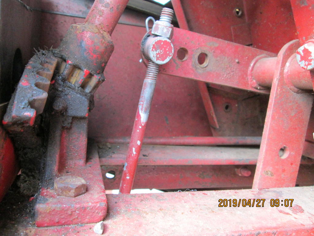

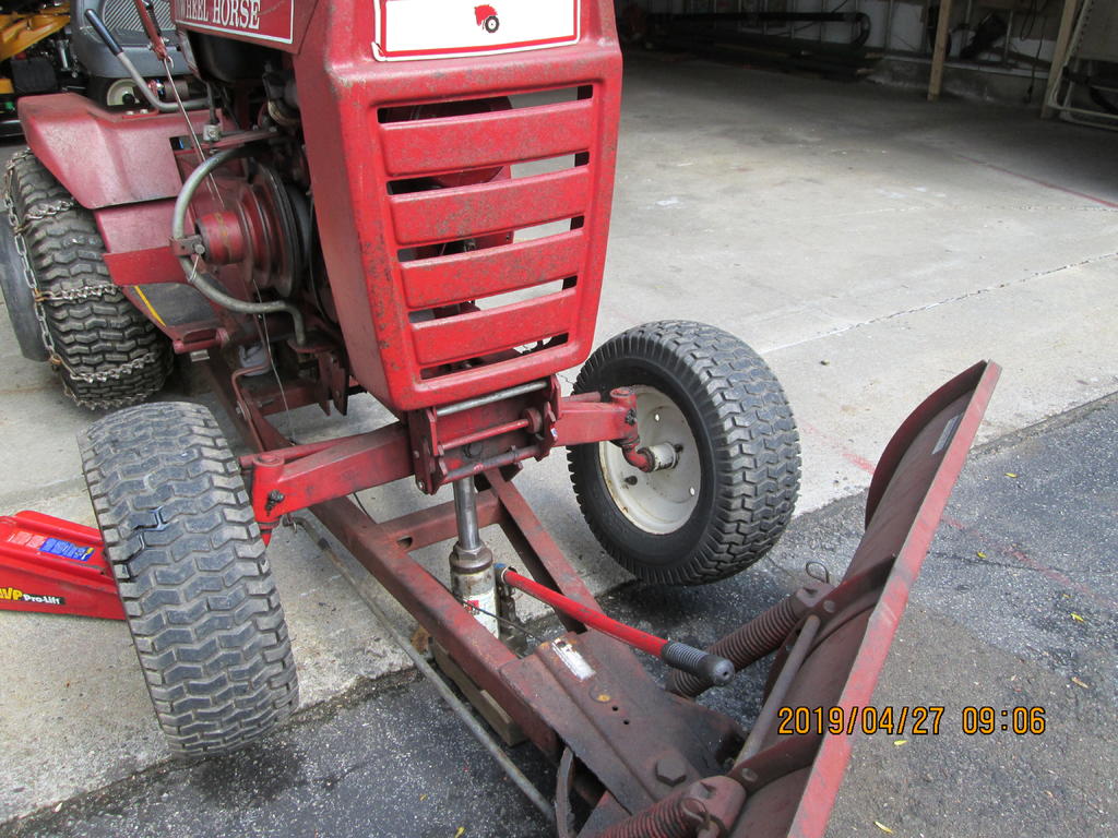

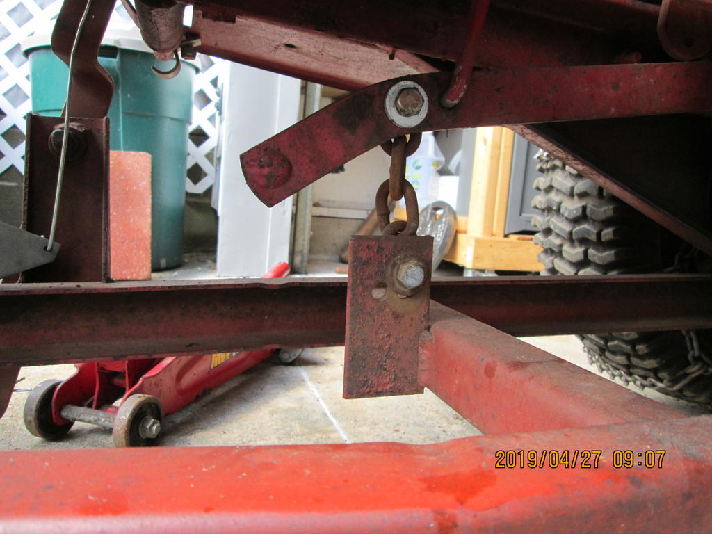

Retired Wrencher 6,451 #1 Posted April 27, 2019 Last day of PM`s doing the tranny change the fluids and flushing out the tranny. I have a question about the plow is this set up right? It has been a while. This the way I bought it. Thanks in advance. 1 Share this post Link to post Share on other sites
squonk 45,535 #2 Posted April 27, 2019 Looks good from my house. Watch out for the grease fitting on the front axle pivot pin with that bottle jack. It may already be snapped off. Your steering gear looks like it could use some grease based on the rust on the gear and the grease fitting in the block. 3 Share this post Link to post Share on other sites
Retired Wrencher 6,451 #3 Posted April 27, 2019 14 minutes ago, squonk said: Looks good from my house. Watch out for the grease fitting on the front axle pivot pin with that bottle jack. It may already be snapped off. Your steering gear looks like it could use some grease based on the rust on the gear and the grease fitting in the block. Mike what about the plow Share this post Link to post Share on other sites
ebinmaine 77,347 #4 Posted April 27, 2019 Looks good Gary. I have a solid link instead of a chain but otherwise yours is the same. Look at the levers on the axle and see if there are holes that you can put a pin in. That'll prevent the lever from lifting while you're plowing and dropping the plow. Share this post Link to post Share on other sites
Sparky-(Admin) 24,633 #5 Posted April 27, 2019 Plow looks to be attached correctly. Mine is also connected with a few links of chain on the lift arm. Share this post Link to post Share on other sites

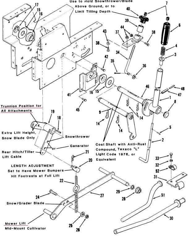

Retired Wrencher 6,451 #6 Posted April 27, 2019 1 hour ago, Sparky said: Plow looks to be attached correctly. Mine is also connected with a few links of chain on the lift arm. Mike should the lift arm be in the first hole or in the 3rd hole? or is that for a mid grader? Share this post Link to post Share on other sites
Retired Wrencher 6,451 #7 Posted April 27, 2019 1 hour ago, ebinmaine said: Looks good Gary. I have a solid link instead of a chain but otherwise yours is the same. Look at the levers on the axle and see if there are holes that you can put a pin in. That'll prevent the lever from lifting while you're plowing and dropping the plow. Just now, Retierd Wrencher said: Mike should the lift arm be in the first hole or in the 3rd hole? or is that for a mid grader? Eric my last had a solid mount with a quick pin for release. Thanks for the reply. Share this post Link to post Share on other sites
