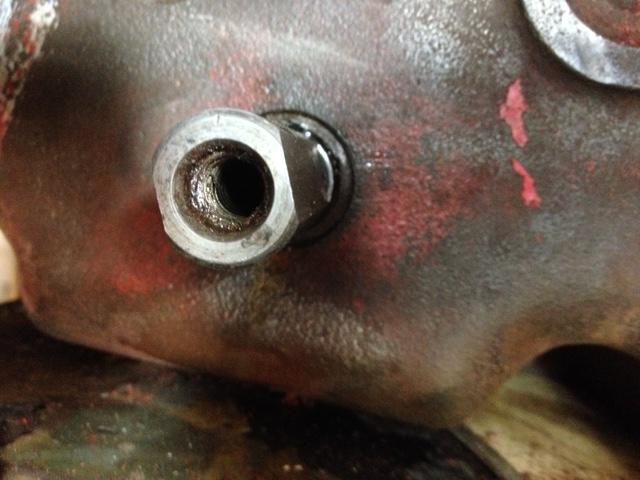

Alfienoalkes 9 #1 Posted April 27, 2019 Hello, Trying to replace a leaking oil seal on a C121 Can anyone tell me if the oil seal is also the metal ring around the shaft (pictured) or rubber only, and the metal ring stays in place , the gap is so narrow between rubber and shaft I cant get anything in there strong enough to pull it out ?? Thanks . Alfie Share this post Link to post Share on other sites
pfrederi 18,776 #2 Posted April 27, 2019 Rubber and metal come out a one piece. Drill a small hole in the metal part and use a bent pick to work it out. 4 Share this post Link to post Share on other sites
peter lena 9,332 #3 Posted April 27, 2019 you might try a packing puller , https://www.walmart.com/ip/PALMETTO-PACKING-1101-Packing-Extractor-Removable-7-1-2-In-L/40827471?wmlspartner=wlpa&selectedSellerId=1122&adid=22222222227000000000&wl0=&wl1=g&wl2=c&wl3=42423897272&wl4=pla-51320962143&wl5=9003291&wl6=&wl7=&wl8=&wl9=pla&wl10=101593696&wl11=online&wl12=40827471&wl13=&veh=sem&gclid=CjwKCAjw-4_mBRBuEiwA5xnFIBoFvdLSqPtaCBgBQ8KHbQQc3qYYz3z27FMdteHW_9dKBzOmt2_EzRoCEbAQAvD_BwE, used to repack a lot of gear drive agitator shafts , this is made to get into tight areas in the small size , pete Share this post Link to post Share on other sites
Alfienoalkes 9 #4 Posted April 27, 2019 Thanks for that ! didnt want to try and pull out something that wasnt meant to come out 2 Share this post Link to post Share on other sites
