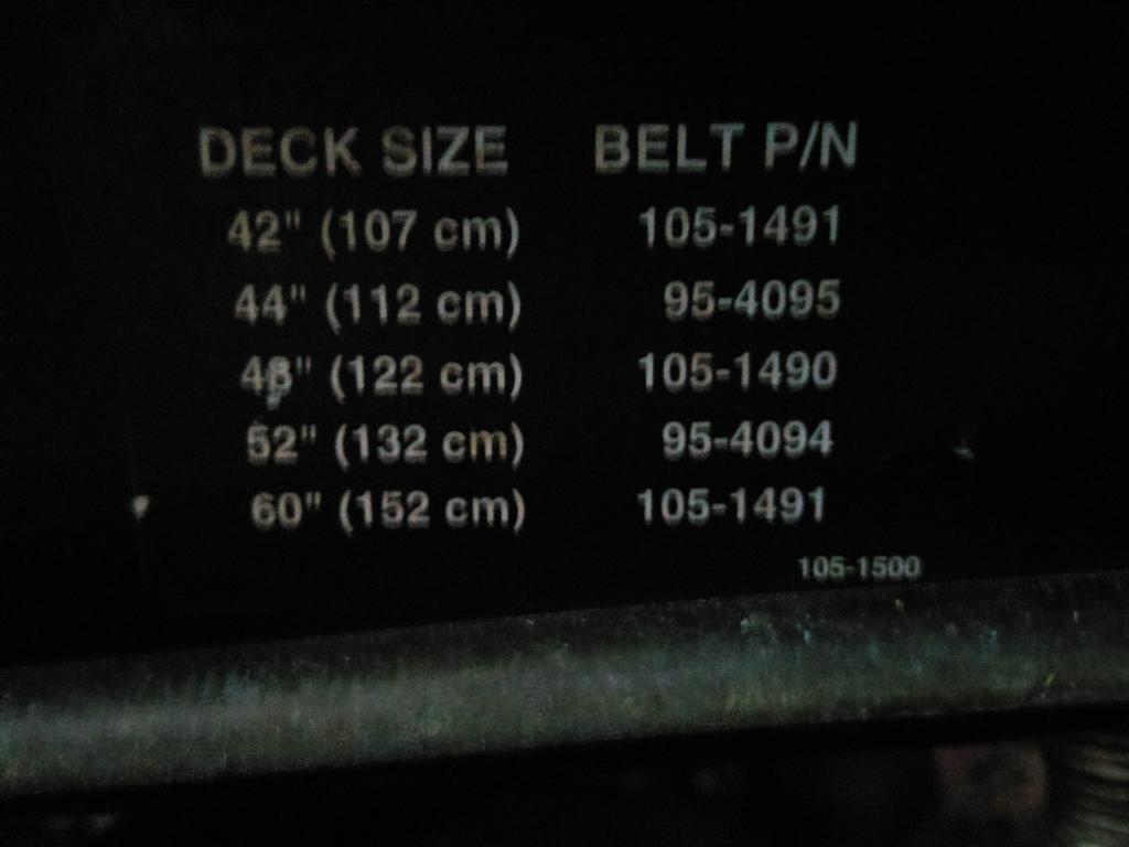

gwest_ca-(File Mod) 11,482 #4 Posted April 28, 2019 Have added many belt numbers and sizes to the page that describes the file for the deck's parts lists. Saves downloading a file to find out the belt sizes. The belt charts do have mistakes in them so when I see the opportunity to check numbers like above I do it. This time I think there is a mistake in the decal. 105-1491 (5/8" x 94") drive belt for 42" deck on decal - This is correct but the deck is a rear discharge 1998-2001. The 5xi never got a 42" side discharge deck. 95-4095 (5/8" x 98") drive belt for 44" deck on decal - This belt fits the 48" decks 1998-2001 when the front idler assembly had the adjustment knob on the front. 105-1490 (5/8" x 98.5") drive belt for 48" deck on decal - This belt fits the 48" decks 2002-on when the front idler assembly had the adjustment knob on the bottom. 95-4094 (5/8" x 96.7") drive belt for 52" deck on decal - This belt is correct but also used with 44" decks 105-1491 (5/8" x 94") drive belt for 60" deck on decal - This is correct The 105-1500 decal shows up 2002-2006 and was on the front panel of the idler assembly. Hope I have this right. Garry 1 Share this post Link to post Share on other sites
