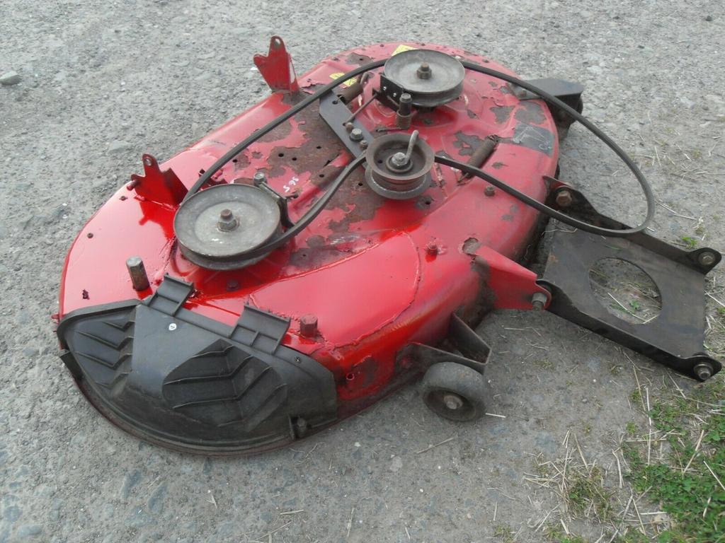

petefaeperth 19 #1 Posted April 25, 2019 Hi I was wondering if this would work with my 1972 Commando 800? I suspect it might be a little too modern. Pete H Share this post Link to post Share on other sites
stevasaurus 23,293 #2 Posted April 25, 2019 That deck looks to be for a vertical shaft tractor. It would certainly take some modification to make it work on a horizontal shaft tractor. I'd keep looking, it should not be too hard to find the right deck...even in Scotland. Share this post Link to post Share on other sites
