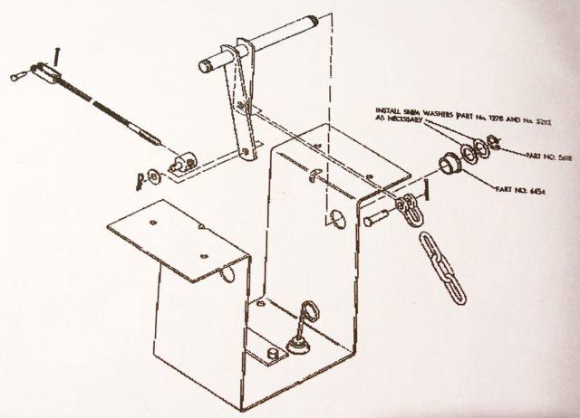

 I have a guy I know with a 1977 or so wheel horse C120 with a Sunstrand Hydro static transmission. He needs a seat support bracket, the thing that bolts to the top of the transmission and hold the fenders/seat pan in place so that he can pull his seat on top of it. I have a few different types here I can send him from various models, but all I have is Eaton’s and an old Charger that has the flip top seat...  The bits and pieces of other tractors I have are all from various models, but I’m not sure which, and I don’t know which one to send him. Can somebody send me a picture from his style of tractor so I know which one to put in the box?
daveoman1966

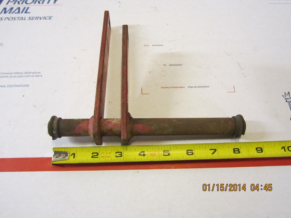

The 76 and 77 C-120 / C-160 are a bit unique as the seat pan bracket is wider than later years.  Secondly, the BELL CRANK shown here is also dedicated to that model(s) and ONLY for those tractors.  So...by reckoning,  pick the bracket that is between 8 - 9 inches wide at top .

Thank you! That was very helpful  while digging through the pile. I got one on the shelf for him. He’ll be tickled... thanks again!
