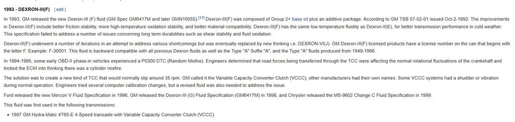

pfrederi 18,643 #3 Posted April 23, 2019 (edited) I use Dex/Merc Compatible with Dexron3 and earler. no problem in 5 different tractors. Use what ever you want Sundstrand built essentially the same pump/motor for several tractor brands. They all called for different fluids. Hy/Tran JD20 motor oil ATF take your pick. Edited April 23, 2019 by pfrederi 2 1 Share this post Link to post Share on other sites
pfrederi 18,643 #4 Posted April 23, 2019 Maybe Dexron 3 wasn't listed in this 1974 manual because it was not created until 1993 ?? 2 1 Share this post Link to post Share on other sites
