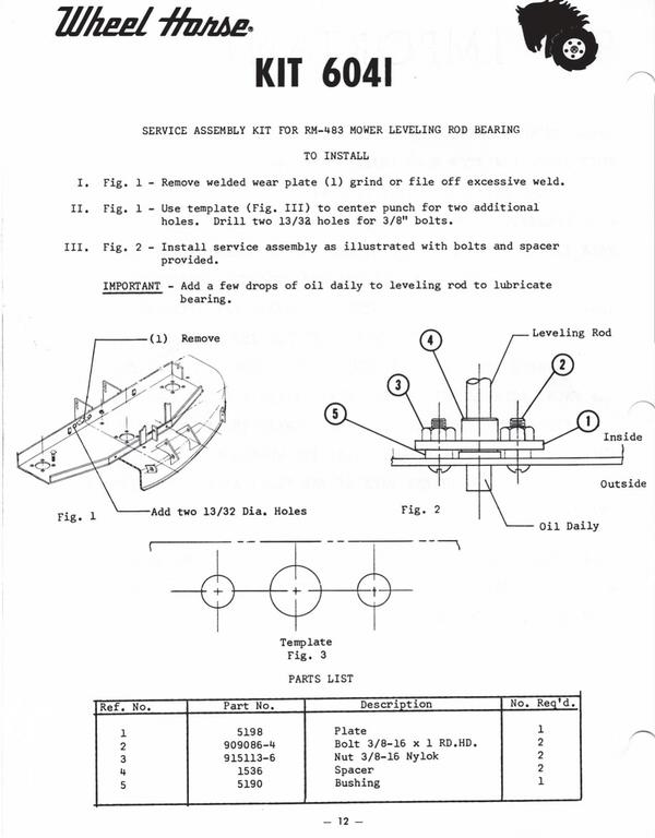

WHwest8597 85 #1 Posted April 20, 2019 The hole the in the frame where the bushing for the lift arm has worn. Any suggestions besides a bigger bushing? Share this post Link to post Share on other sites

WHwest8597 85 #4 Posted April 23, 2019 There is a lip on the hole the bushing goes in. The lip on the frame that broke off. It won't let me post pics. Says file is to big. Share this post Link to post Share on other sites

Sandyfer 0 #6 Posted April 26, 2019 I think we are having te same issue. This is what I found on the forum as a fix. Share this post Link to post Share on other sites
