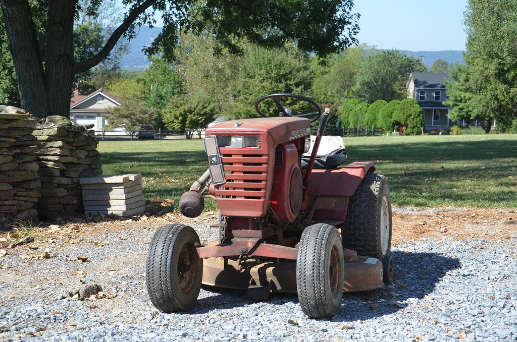

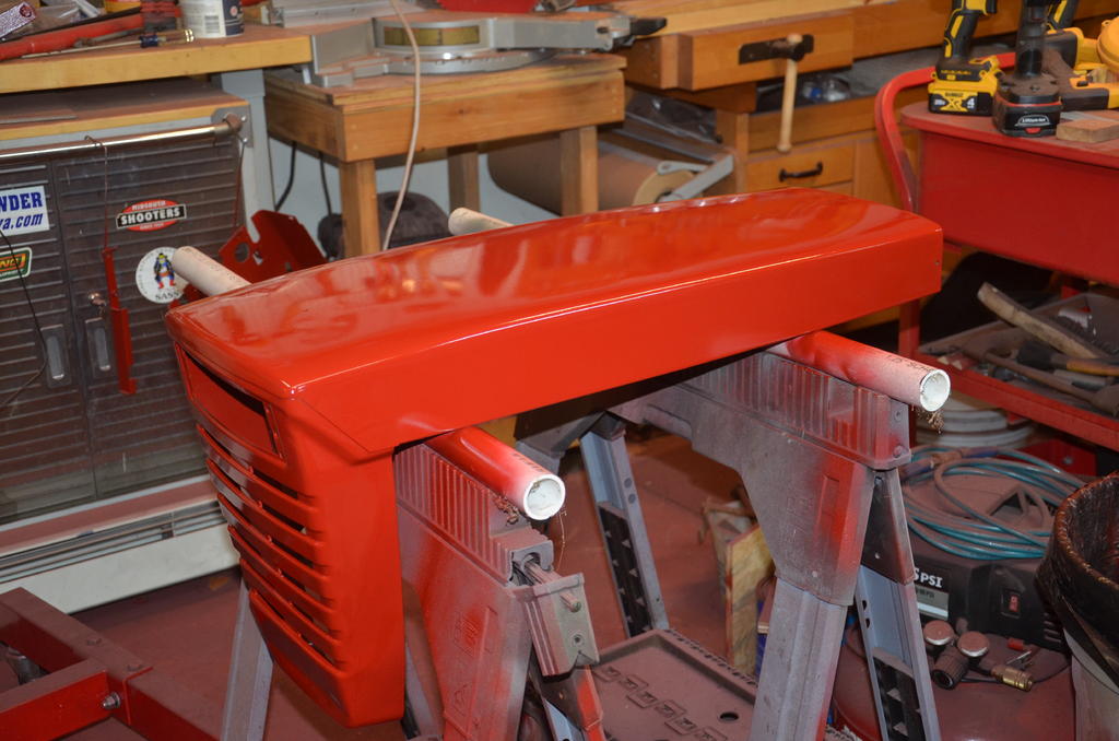

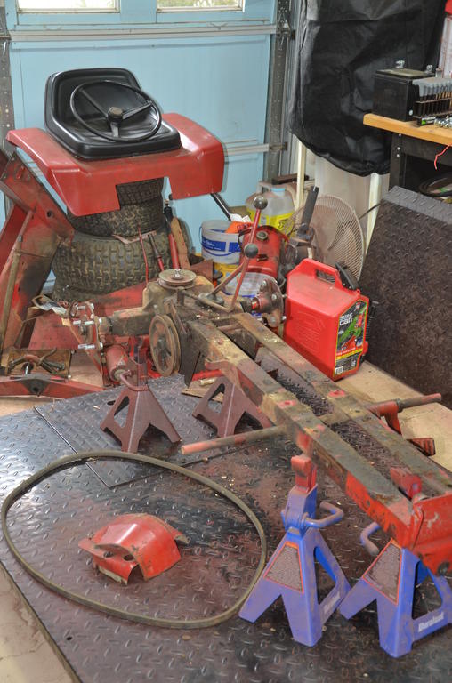

RJ Hamner 1,029 #1 Posted April 19, 2019 Bought this little guy three years ago. Was going to restore it but it keep being pushed back by other projects. Now it's its turn! What it looked like when I brought it home. What it looks like as of 4/19/19 6 2 Share this post Link to post Share on other sites

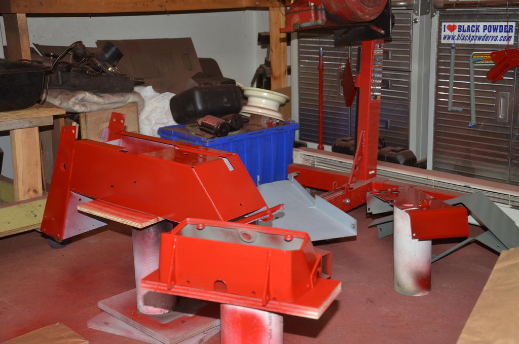

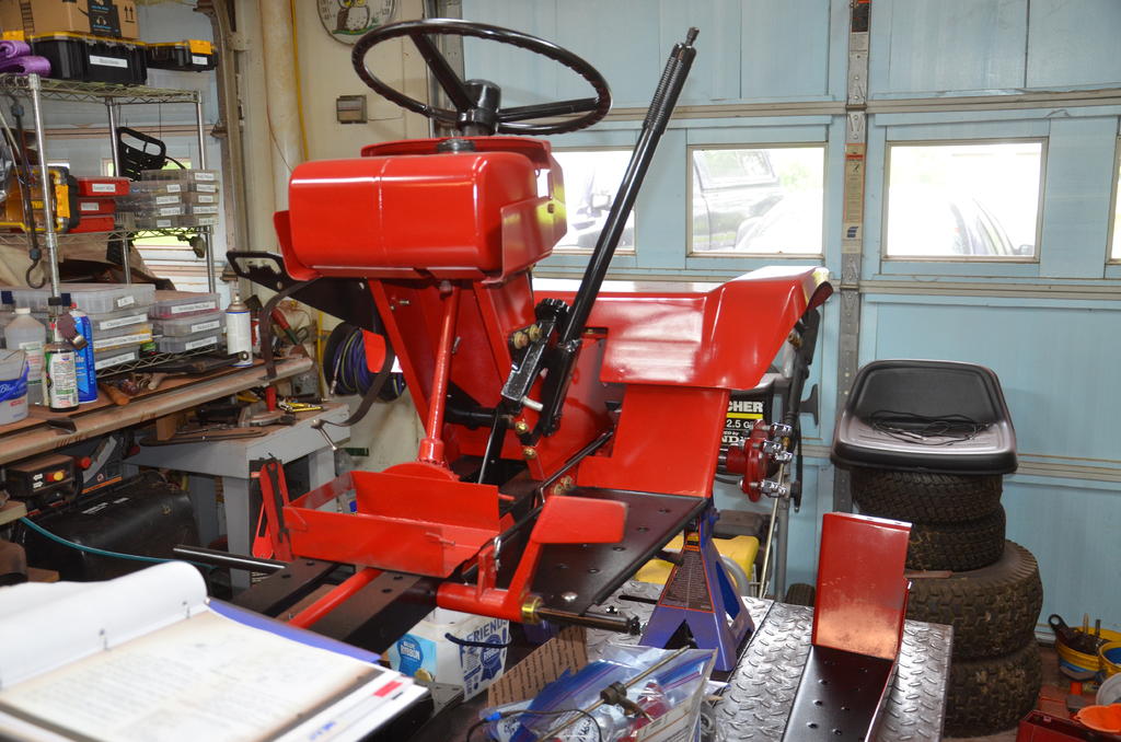

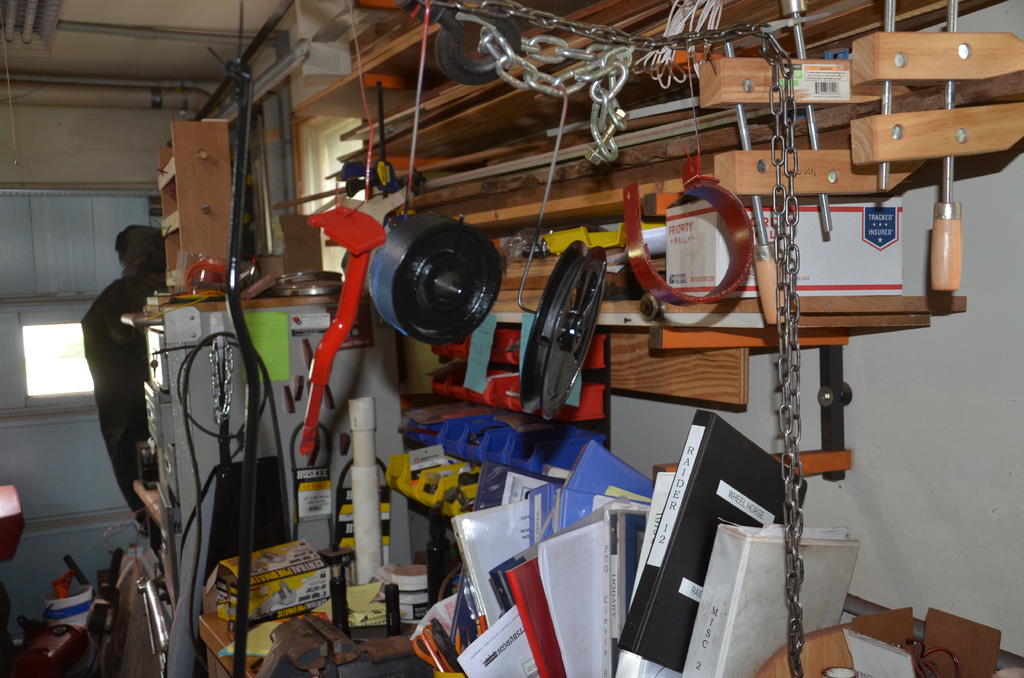

RJ Hamner 1,029 #7 Posted April 28, 2019 Have you ever found yourself praying for rain? Will I did. When you just started a new project and it's springtime. My wife is the nursery owners best friend as she brought in a pickup load of plants, bulbs and seeds. If its not raining I get the infamous "I need your help" or "Can you give me a hand? This will only take a minute" Uh right. Well it rained!!!!!! Since I am waiting on some parts for the transmission and am not one to waste a rainy day..... Thought I'd work on the frame and wondered if it would fit in the blast cabinet. IT DID! Changed out the grit, put on a new nozzle and fired up the compressor One thing led to another and almost ran out of places to hang things and wires to hang they with. But, it raining again and she's at work!!!!!!!! 4 3 2 1 Share this post Link to post Share on other sites
ebinmaine 77,075 #8 Posted April 28, 2019 3 hours ago, RJ Hamner said: almost ran out of places to hang things Just go toss some clothes out of the closet. Plenty of space in there. 1 1 Share this post Link to post Share on other sites

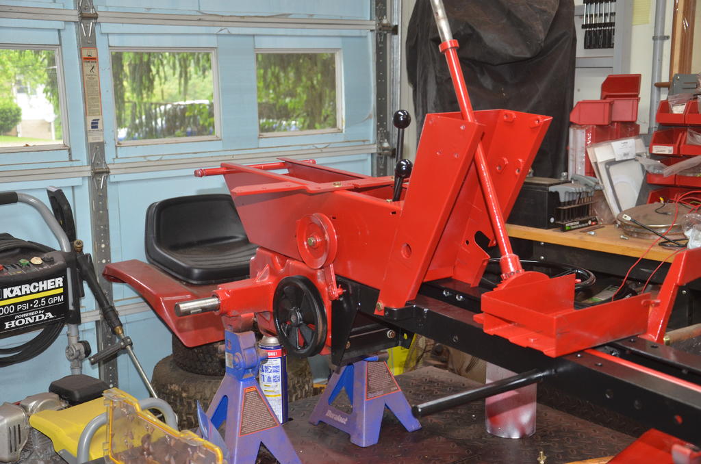

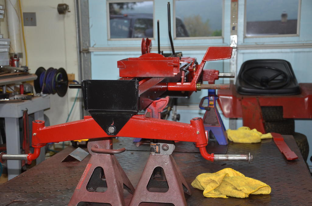

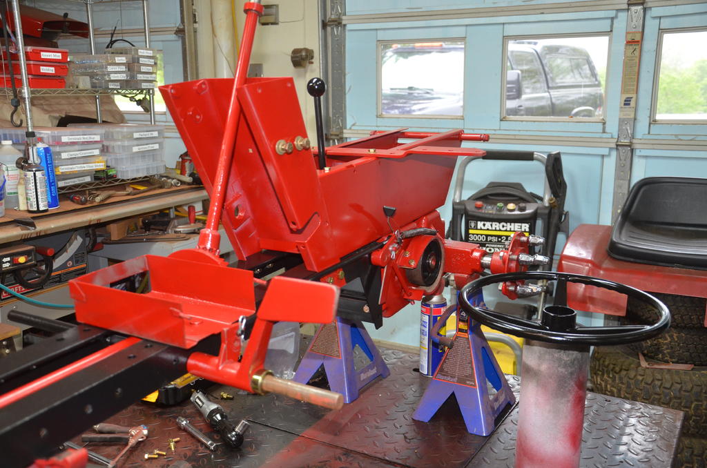

RJ Hamner 1,029 #9 Posted May 3, 2019 Got a chance to do some more work this afternoon. Suffered another "missing mass" problem. Can't find the parking brake lever. Know I have/had it. I know for sure I WILL find it because I ordered another one off ebay. I am positive that when it shows up the first one will instantly appear 5 3 1 Share this post Link to post Share on other sites

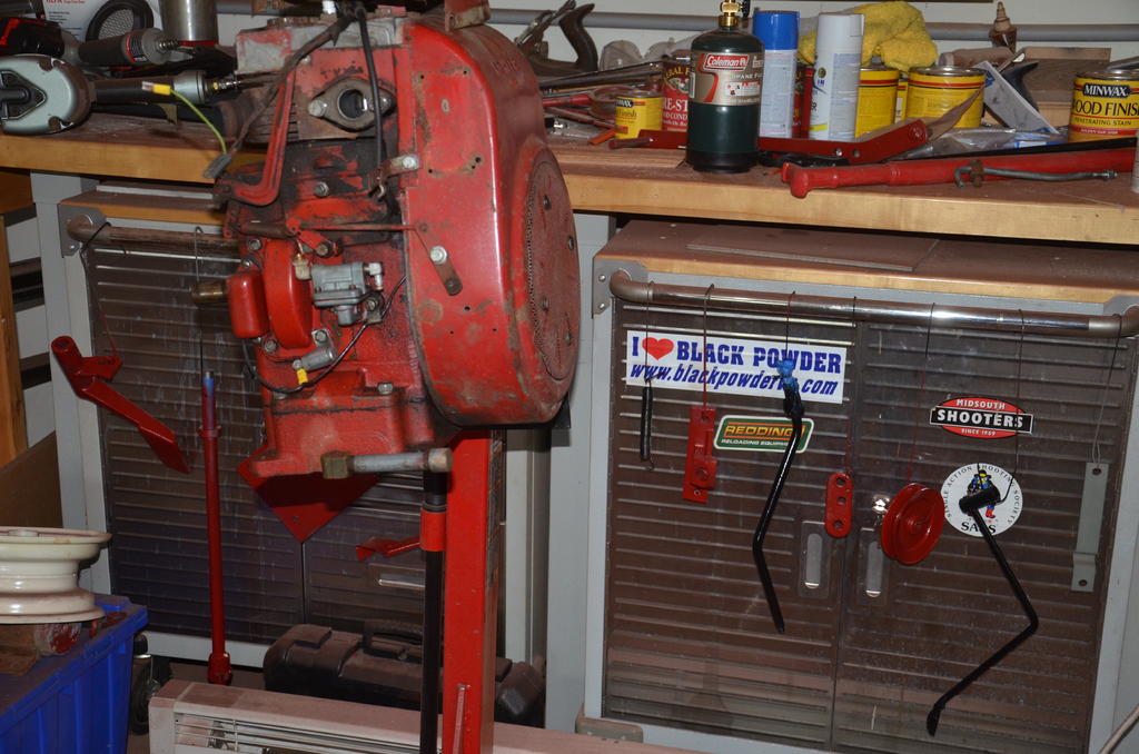

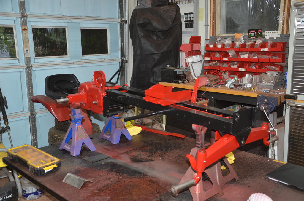

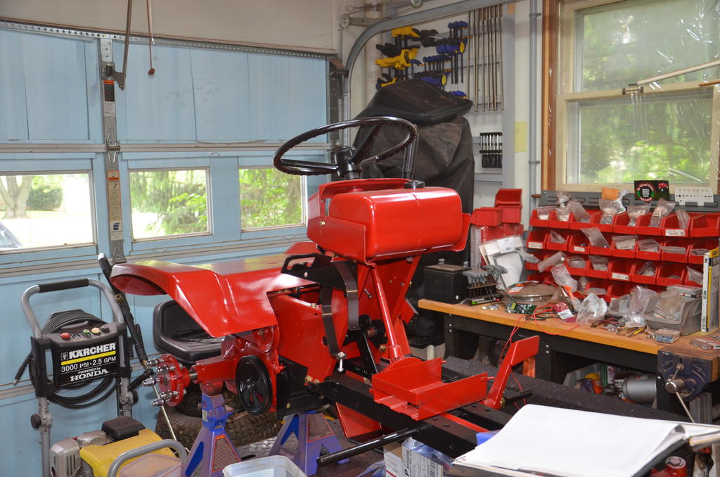

RJ Hamner 1,029 #15 Posted May 6, 2019 Raining again today so gotta work inside. If it doesn't quit soon I may have to bale the back yard I am not sure what the title of this picture should be. Impressionist Sculpture? Everything is Upside Down? or Cr@% I'm Running Out of Floor Space! The grey panel in the rear is going to have to wait for good weather. It needs some welding done on it and that's really hard to do in the rain 4 2 Share this post Link to post Share on other sites

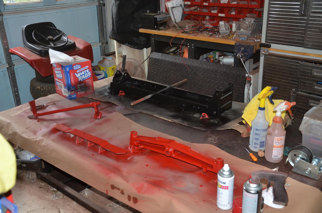

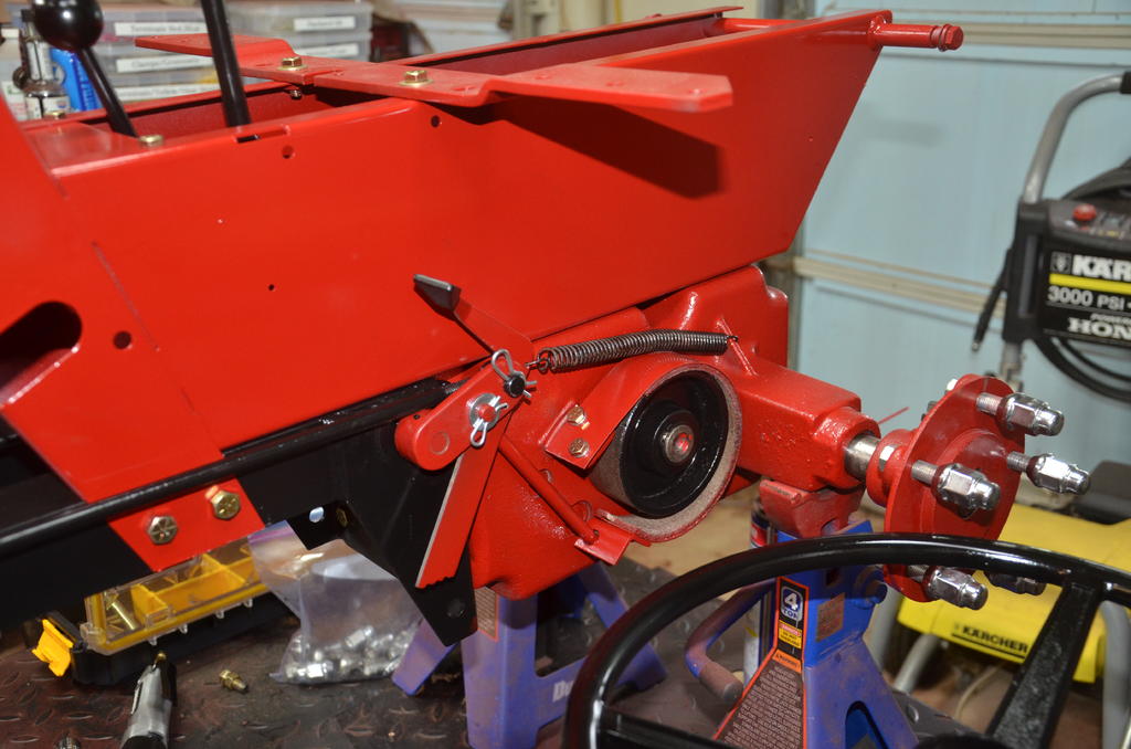

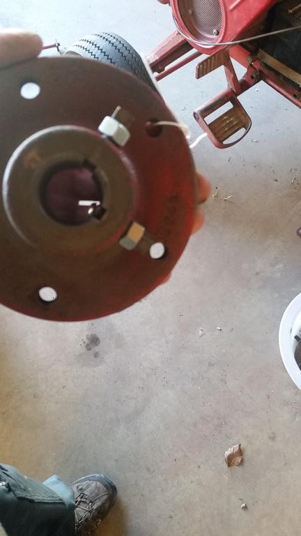

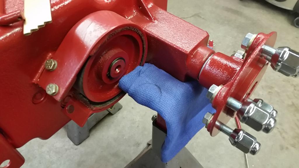

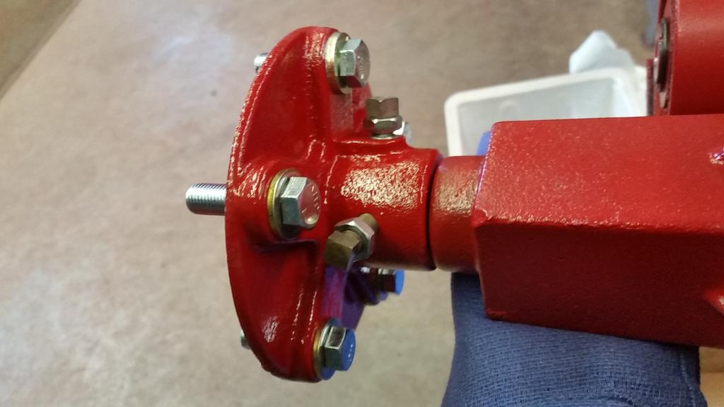

RJ Hamner 1,029 #16 Posted May 13, 2019 Suffered a minor (?) setback with a paint issue and had to re-blast all the parts for the tower. But with all the rain and the wife out of town at a meeting I had lots of time to spend fixing my screwup Must have got all my boo-boo's out of the way the first time cause the second go around looks pretty good Got the replacement parking brake arm (still haven't found the one I put in a safe place) cleaned, painted and installed. With the rain I've had to paint inside so it limits the number I can do at a time. And, since it turned real cool I've had to fire up the heater again to help dry the paint. I often ask myself "Are we havin' fun yet?" Ans: YEP! 1 5 Share this post Link to post Share on other sites
ebinmaine 77,075 #17 Posted May 13, 2019 Love those rear wheel studs. We do that to all of ours. 1 Share this post Link to post Share on other sites
WHX?? 54,512 #18 Posted May 13, 2019 Hey Bob you are missing a hub! Tip on those studs is use a lock washer or thick AN type washer behind the stud and blue lock tite. They will seat much better and help prevent loosening with the washers. Also torque the bling nuts, regular ones too, to the max a 7/16 fine thread bolt will take. A piece of tubing slid over that spring will keep the spring from rubbing off red on the brake band. 3 1 Share this post Link to post Share on other sites
RJ Hamner 1,029 #19 Posted May 13, 2019 Not a bad couple if ideas. AN hardware? Your old rating is showing. Grade 8 will probably work too Glad you pointed out the missing hub. Wonder where it went?? 2 Share this post Link to post Share on other sites
WHX?? 54,512 #20 Posted May 13, 2019 (edited) 15 minutes ago, RJ Hamner said: Wonder where it went?? Same place as the brake lever? Edited May 13, 2019 by WHX22 2 Share this post Link to post Share on other sites

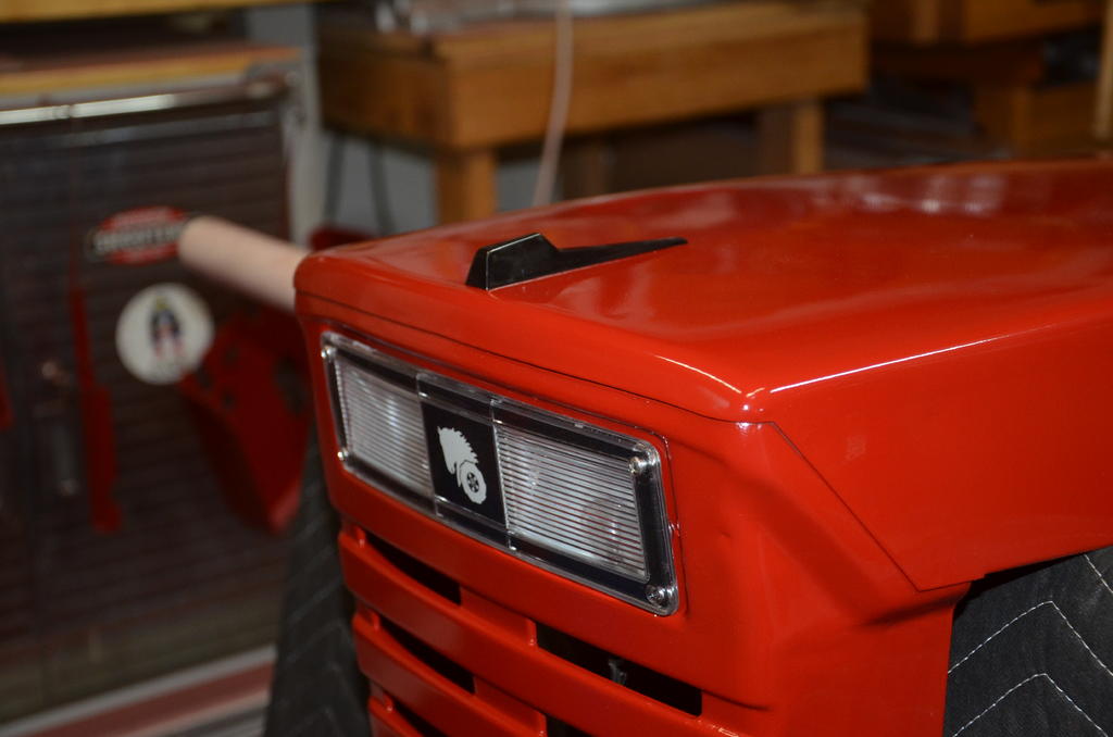

RJ Hamner 1,029 #25 Posted June 12, 2019 Noticed while I was starting to assemble the hood that I only had two hood ornaments. One with one of the "legs" broken off and the other was full of pits and cracks in the chrome. I tried cleaning up the unbroken one (used to work pretty good on some of the chrome on a couple of cars when I was a LOT younger) It wasn't working too well. Then I thought.....well maybe... Sanded the ornament down to smooth and gave it a shot of gloss. So what do ya think of my solution????? 4 2 Share this post Link to post Share on other sites
