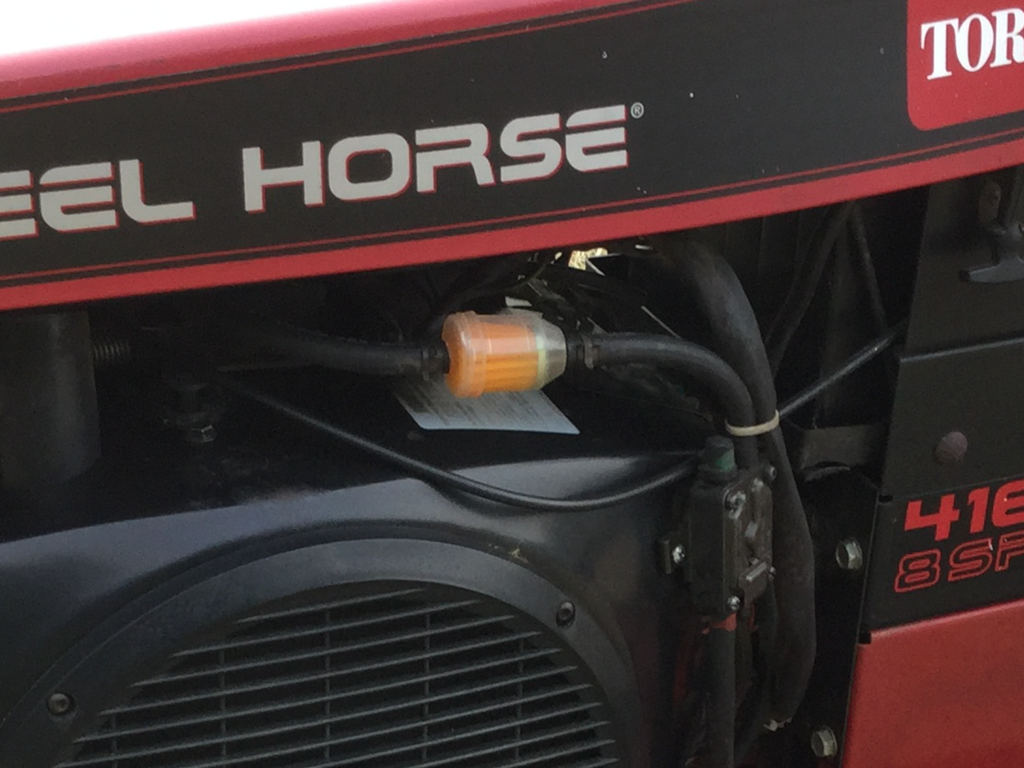

RetroMower 350 #3 Posted April 18, 2019 1 hour ago, WHwest8597 said: Any suggestions for adding at fuel filter to models that did not come with filters originally. My 50th Anniversary 314-8 did not come with a fuel filter. What filter should I use? Any small inline fuel filter thats double barbed or flared to fit inside rubber fuel lines will work. Some like the clear filters which act as a visual aid for fuel flow or even the small briggs and Stratton plastic discs that are basically just an inline screen to capture particles will work. They are WH red to boot 1 Share this post Link to post Share on other sites

formariz 12,381 #7 Posted April 19, 2019 I now always use two of them. I remove the screen from inside tank since eventually always gets clogged and it is a pain to clean tank. I place the first one right out side tank. That one gets changed frequently since it always show crud in it. Share this post Link to post Share on other sites
