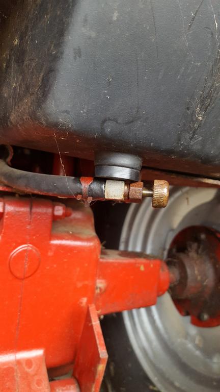

Cadmandu 67 #36 Posted April 23, 2019 Hi all i got my shutoff and grommet yesterday. When I remove and install is this the correct method? 1) pull the valve first then pry out grommet 2) then install new grommet first then push in valve. or install and remove as an assembly thanks Share this post Link to post Share on other sites
WVHillbilly520H 10,378 #37 Posted April 23, 2019 (edited) 54 minutes ago, Cadmandu said: When I remove and install is this the correct method? 1) pull the valve first then pry out grommet 2) then install new grommet first then push in valve. thanks and use a bit of motor oil to lube up that grommet first. Edited April 23, 2019 by WVHillbilly520H Share this post Link to post Share on other sites
Cadmandu 67 #38 Posted April 23, 2019 Okay thanks, so do not install as an assembly correct? Oil is a good idea. Share this post Link to post Share on other sites
ericj 1,580 #39 Posted April 24, 2019 I do not like to put oil on rubber fittings, I've used a little squirt of carb and choke cleaner. Anything wet will help it slid together easier. eric j Share this post Link to post Share on other sites
Cadmandu 67 #40 Posted April 24, 2019 How about vasaline Share this post Link to post Share on other sites
richmondred01 2,372 #41 Posted April 24, 2019 Spray silicon works well Share this post Link to post Share on other sites
Cadmandu 67 #42 Posted April 24, 2019 Okay I have some for motorcycle chain lube Share this post Link to post Share on other sites
WVHillbilly520H 10,378 #43 Posted April 24, 2019 38 minutes ago, Cadmandu said: How about vasaline That works too, and just a small bit of oil wont hurt even WD40 just something to lube it before installing. Share this post Link to post Share on other sites
