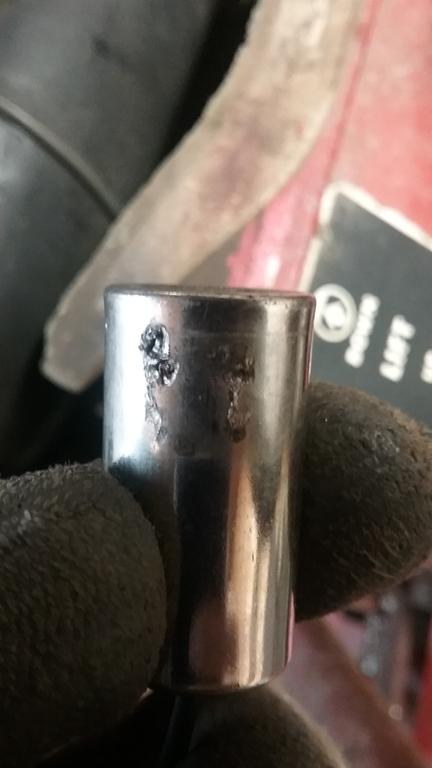

RetroMower 350 #16 Posted April 17, 2019 4 hours ago, Mike'sHorseBarn said: I'd try points and condenser first before I worried about planing the head unless you know for a fact it is leaking. I've used a lot of points and condensers from isavetractors.com and have never had a problem with them. https://isavetractors.com/points-and-condenser-set-for-kohler-k-series/ I think I do have a leaky head gasket because of some black on the bottom cooling fins. I know its not my #1 problem but removing the head will tell me a lot more of this motors condition. As for Isavetractors i believe that place will be hearing from me soon. But on another note i did swap out the brand new condenser for the original one and it backfired like a machine gun so i used the one off the b100. Runs ok but no better than before. I did notice someting odd on the new condenser I removed. What is the problem here? Share this post Link to post Share on other sites
gwest_ca-(File Mod) 11,921 #17 Posted April 20, 2019 Looks like it has been arcing. The body of the condenser requires a good ground. Is it mounted to fresh paint by chance so the bracket is not grounded? Is the tower on the coil leaking high voltage to the (-) coil terminal when it fires? If it is cracked that can happen. Sounds like you have another coil so try swapping it out. Garry 1 Share this post Link to post Share on other sites
