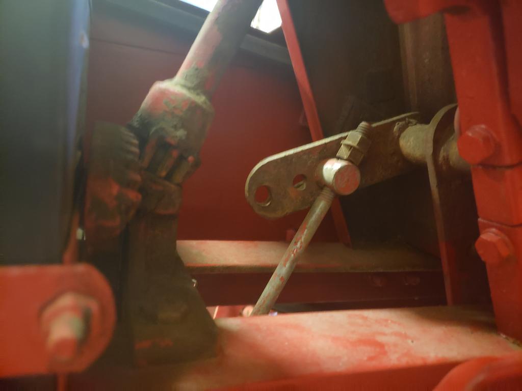

Larry Chamberlain 22 #1 Posted April 16, 2019 I cantbthe death of me get my mower deck on just put the mounts on yesterday and tried for about 1/2 hour this morning to get it on but cant Share this post Link to post Share on other sites

gwest_ca-(File Mod) 11,512 #3 Posted April 16, 2019 This manual may help The lift link was changed to a chain Garry Share this post Link to post Share on other sites
Larry Chamberlain 22 #4 Posted April 16, 2019 I finally got the front in now it wont lift it's in a bind the lift pin is clear in the front of the slotted hole it's not allowing it to shift back to lift Share this post Link to post Share on other sites
The Tuul Crib 7,339 #5 Posted April 16, 2019 (edited) By the looks of it that adjustment rod I’m thinking it should be in the front hole and should have a chain on it Edited April 16, 2019 by The Tool Crib 1 Share this post Link to post Share on other sites
Larry Chamberlain 22 #6 Posted April 16, 2019 Ok I flipped the front peice around that had the fork it hooked right up the issue I'm having now is it has the deck maxed out on lift the deck wheels are against the tractor tires other words needs a longer rod the above gentleman game me a diagram of a revised version with a chain I'm going to go with that and see how it goes Share this post Link to post Share on other sites
Larry Chamberlain 22 #7 Posted April 16, 2019 Ok I got it done works great cost me 9 bucks for some reason it's not letting me insert pics 1 Share this post Link to post Share on other sites
