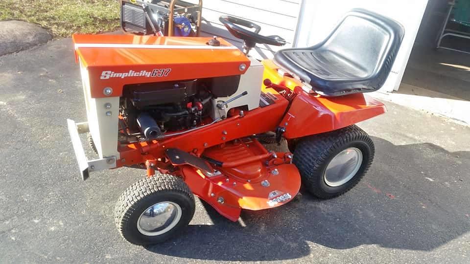

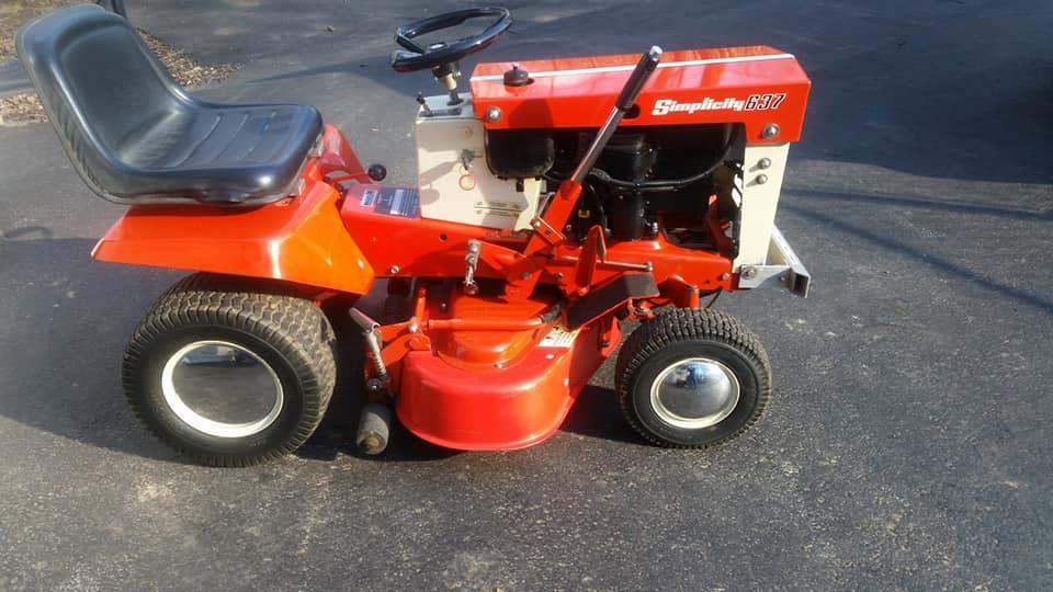

Metal225 29 #1 Posted April 13, 2019 (edited) well its not new but new to me i got a simplicity 937 tractor in really nice looking shape , But today i was testing out the mower part, and the tractor started moving in different directions from front to back, Turns out the frame was welded at some point and has re-broken its self again no wonde5r i got it soo cheap 400 bucks Edited April 13, 2019 by Metal225 4 1 1 Share this post Link to post Share on other sites
Stormin 9,987 #2 Posted April 13, 2019 Looks good. Pity about the frame. Re-welding and plating should sort it I hope? Share this post Link to post Share on other sites
wildman 205 #3 Posted April 14, 2019 Still a nice little rig 1 Share this post Link to post Share on other sites

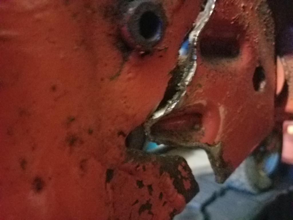

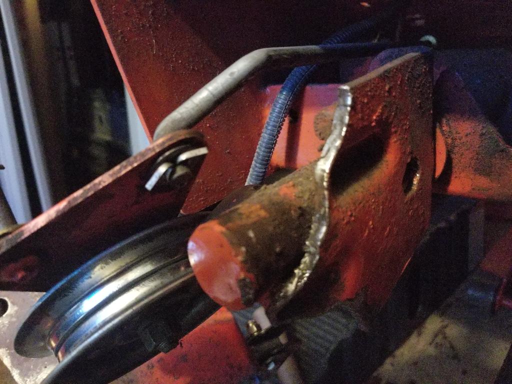

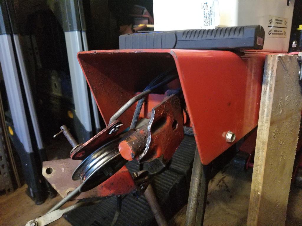

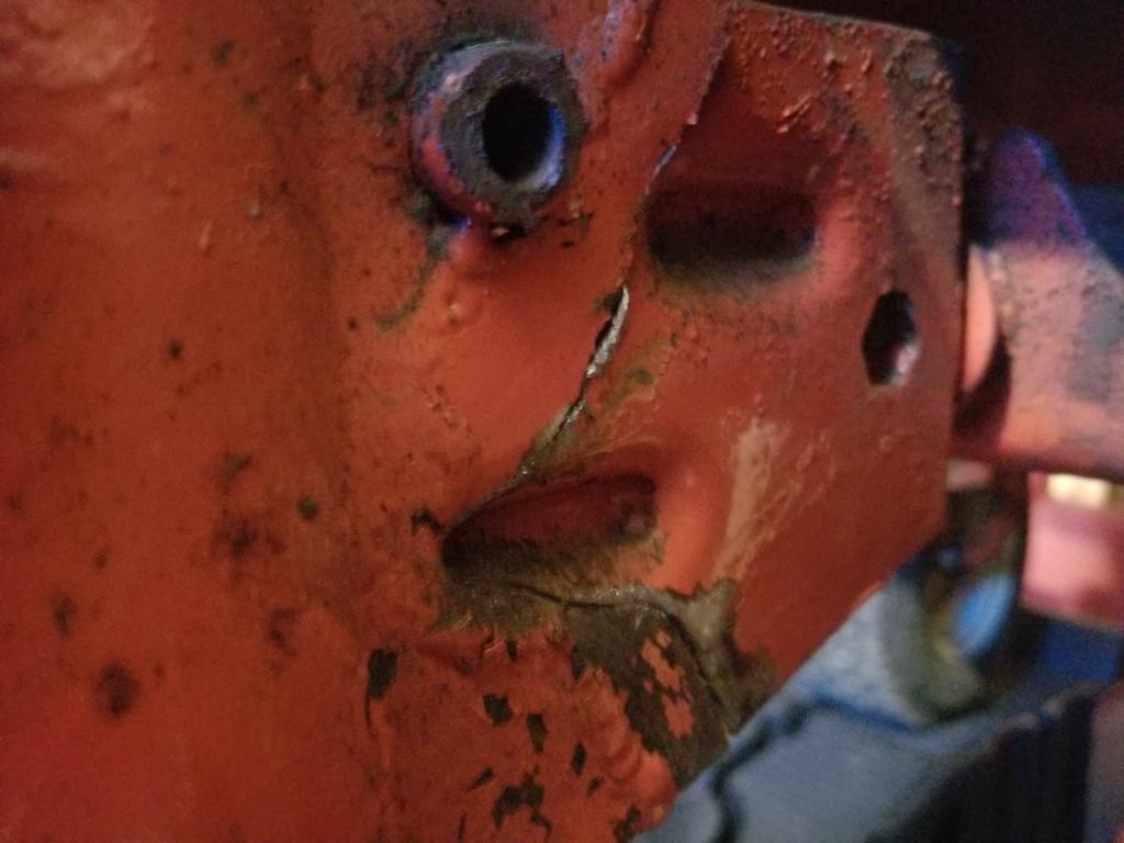

Metal225 29 #8 Posted April 14, 2019 19 hours ago, Achto said: Confused a bit. The front axle should be welded solid to the frame. The rear trans axle, fenders, & seat should pivot side to side on this tractor. It is a strange feeling at first, but this is how it should work. Is this what is going on?? where it pivots is broken on one side and was welded solid at one point also heres some picks as i got it apart now 1 3 Share this post Link to post Share on other sites
wildman 205 #9 Posted April 15, 2019 Looks like the 738 shares the same frame sections. Share this post Link to post Share on other sites
diesel cowboy 263 #10 Posted April 15, 2019 4 hours ago, Metal225 said: where it pivots is broken on one side and was welded solid at one point also heres some picks as i got it apart now Yikes. Have to wonder sometimes what people did to break things like that. I could be wrong but that doesn't appear to be a thin piece of metal to me Share this post Link to post Share on other sites
Sarge 3,470 #11 Posted April 15, 2019 That design is known to fracture over time from metal fatigue. I always wondered how many tons of force it took to stamp out that heavy frame section. They way they designed the thing there just isn't enough support for that type of joint. From what I understand, any type of rough terrain will eventually crack that area of the frame pivot. Sarge Share this post Link to post Share on other sites
Stormin 9,987 #12 Posted April 15, 2019 The welding doesn't look great either. Looks like it wasn't prep'd. I'd reweld it and add some reinforcing plates. Share this post Link to post Share on other sites
The Tuul Crib 7,340 #13 Posted April 15, 2019 2 hours ago, Stormin said: The welding doesn't look great either. Looks like it wasn't prep'd. I'd reweld it and add some reinforcing plates. take to a trusted welding shop. Share this post Link to post Share on other sites
Metal225 29 #14 Posted May 4, 2019 On 4/13/2019 at 9:59 PM, Achto said: Confused a bit. The front axle should be welded solid to the frame. The rear trans axle, fenders, & seat should pivot side to side on this tractor. It is a strange feeling at first, but this is how it should work. Is this what is going on?? yes it is the part that is welded broke it was welded together once before from a break and now has broken again, well the new weld did not take the 2 supports do not line up on is about 2 inches higher then the other the tractor now drives like a car with a bent frame, so i went to ebay and found a frame really close in looks but we when i transferred all the parts to the new frame the front was different no cut out and its a longer frame as well its going to take a while to fix it right, just wish i really had the time to put into it i have 500 into this now lol i dont wanna loose that much so ill make the time some how Share this post Link to post Share on other sites
