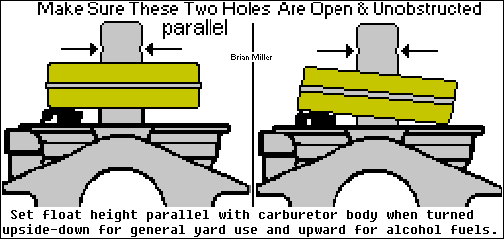

AMC RULES 37,232 #4 Posted April 13, 2019 Check your float adjustment. Share this post Link to post Share on other sites
johncissel 0 #5 Posted April 13, 2019 Ive cleaned the carb twice. First time i did find some grit in the bowl. Second time was ok. Ill replace the lines as they are old. How would the float adjustment be changed? I have the fuel screws set at 2.5 turns out from seated which is what the manual calls for. Thanks for the replies! Also, is there a way to remove the main jet fpr cleaning? Or qhats the best way to ebsure theres no issue with it? Share this post Link to post Share on other sites

AMC RULES 37,232 #8 Posted April 13, 2019 http://gardentractorpullingtips.com/carbfuel.htm 1 Share this post Link to post Share on other sites
oliver2-44 10,976 #9 Posted April 13, 2019 (edited) As shown in the picture posted by AMC, make sure those two holes are open. Also pull the long needle and make sure the tiny holes near the tip and further up it are open. You may need to use a tiny wire from a torch tip cleaner to clean them. You should be able to put the tip in you mouth (with it clean of course) and blow air from the tip holes to the upper holes. If there plugged sometime I have to use a magnifier glass to find them. If it was an aftermarket carb theirs a chance it's just junk. I bought several chinese carbs that worked great, then put one on a 12 hp Kohler and never could get it to stop flooding. Bought another one from Isavetractors and it worked great. It seems there's no quality control on them and 1 in 10 is junk, but there cheap. Also if the problem with your original carb was the throttle shaft was worn, you can get some little 1/4" ID brass washers from your hardware store that has all those drawers full of odd things. Put the in the recess boss on the top of the carb where the shaft comes out, they will tighten it up nicely and block the air flow. Edited April 13, 2019 by oliver2-44 1 Share this post Link to post Share on other sites
