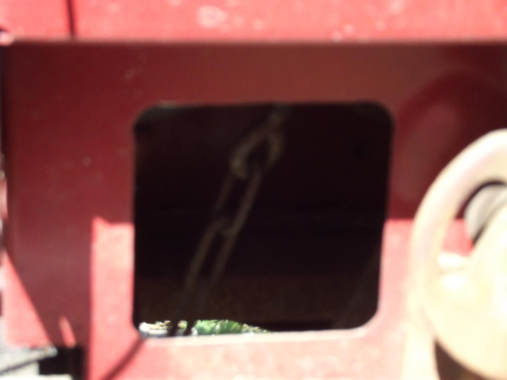

Lee1977 7,399 #3 Posted April 10, 2019 The Deck, plow and grader will all attach the same. It just makes it a little harder to attach to the lift as it's all enclose on three sides and with the two cylinder models you might as well say four sides. Share this post Link to post Share on other sites

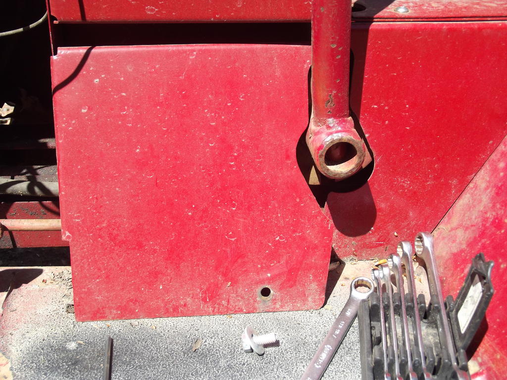

JAinVA 4,638 #4 Posted April 10, 2019 Previous post is spot on about how difficult c101 and later horses are to deal with.When I moved up from a c120 to a c101 I was truly amazed at the lack of access to the center lift compared to older machines.I was also puzzled at the side cover being cut in two.I removed the side cover and saw that a previous owner had taken an industrial can opener to the hood stand.What a rusty mess.A member here provided a replacement hood stand and I modified it to allow hand access.The stock round hole will only allow a five year old access. 1 Share this post Link to post Share on other sites
