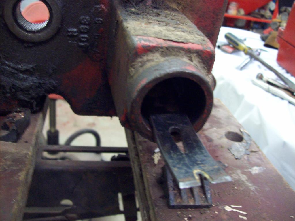

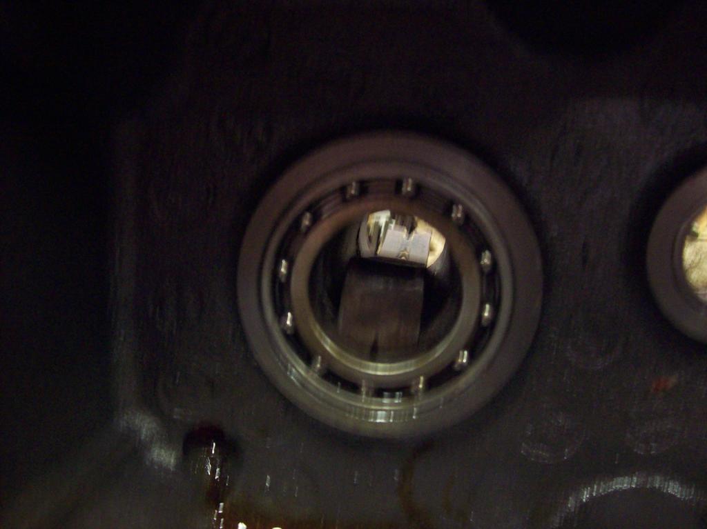

953 nut 64,283 #12 Posted April 14, 2019 1 hour ago, ET160 said: Will do. What the best way to remove it? Can i pry it up with a screw driver? I found a good substitute for a large blind gear/bearing puller. A 6" pry bar and light hammer work for removing the 1533 bearing. With the bar in place you tap on the end that sticks out, rotate it slightly and tap again until it pops out. The pry bar end is against the outer race. 1 2 Share this post Link to post Share on other sites
ET160 30 #13 Posted April 15, 2019 953 nut, I wish I had seen you post earlier. I went and bought a cheap puller. 1 Share this post Link to post Share on other sites
