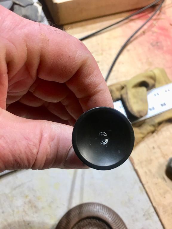

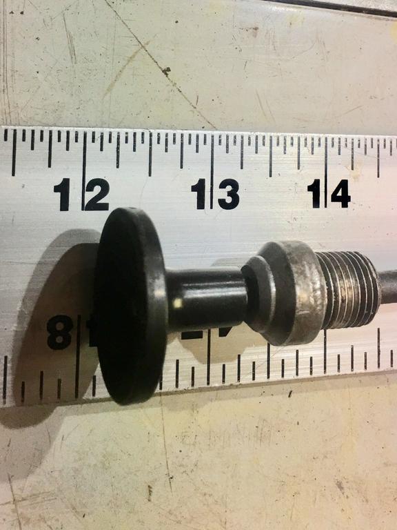

Ok here is what I have . This was on my 1067 . It had a 10  Tecumseh 10 hp
on it . I transplanted a K321 in its place .

That helps a lot.Is this cable plastic wrapped?It would help to see the cable down stream of threaded fitting.Again I am just trying to help.
The Tuul Crib
It’s plastic coated.
JAinVA
That helps.How is the cable retained at the knob end.Is it retained by crimping or some other method?
The Tuul Crib
It’s molded to the end of the cable
JAinVA
My guess is that the metal was crimped to the cable sheath.The only fix for this is to split the crimp at the cable end with something like a Dremel tool and an abrasive disk.Later throttle cables would be source for cores.Unless you can find a direct replacement,you have a chore ahead.My guess is you already know this.Sorry I could not be of more help
