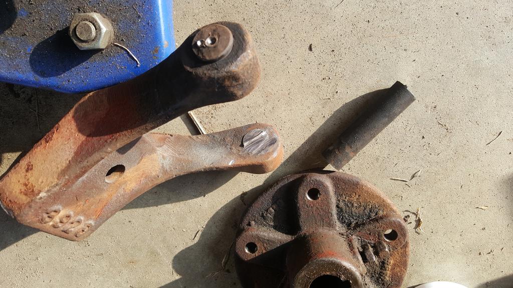

Racinbob 12,812 #6 Posted April 10, 2019 I had the same issue with an 854 I picked up last summer. I kept soaking it for weeks. Finally I was able to get it to move in the trans case but not the slot hitch. I ended up cutting the pin on both sides of the case and remove the hitch. Then the pin came out of the case. The hitch is still sitting out there with a piece of the pin in it. Someday I'll find someone with a press to get it out. Share this post Link to post Share on other sites

bellevillerod 835 #9 Posted April 10, 2019 (edited) Just went through this myself. Got to be careful that you don't mushroom the pin over on the ends. I used a large punch to strike at the center of the pin. Mine still refused to come out. Once I cut it out I was able to use a large torch and cherry red the ends. When I did this I was able to tap the ends out and made a new pin. Good Luck. Edited April 10, 2019 by bellevillerod 1 Share this post Link to post Share on other sites
