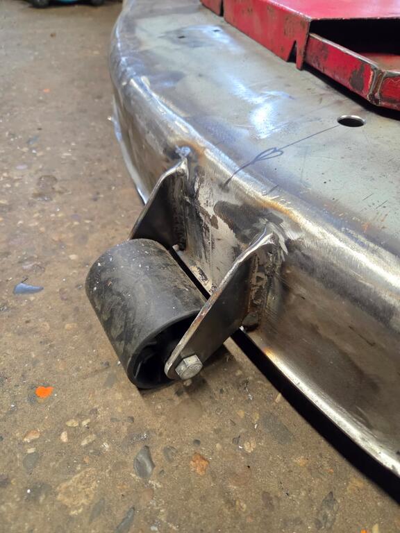

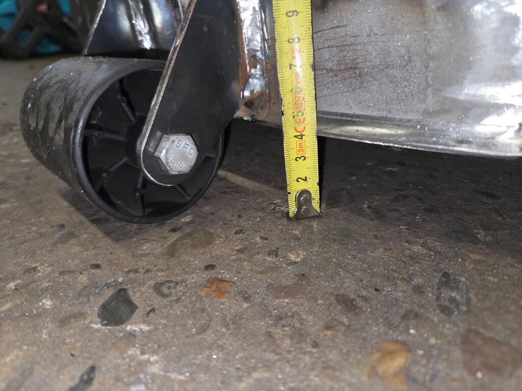

Joan Dorst 41 #26 Posted September 9, 2025 On 9/6/2025 at 6:56 PM, Lee1977 said: The center roller bracket is mounted one inch from the bottom of the deck in good old USA Freedom Units. thank you! I think we're about the same height. the distance between the ground level and the mowing deck is now 4cm (1.5''). would that be okay? 2 1 Share this post Link to post Share on other sites
Lee1977 7,813 #27 Posted September 9, 2025 I think that should work fine. 3 Share this post Link to post Share on other sites
