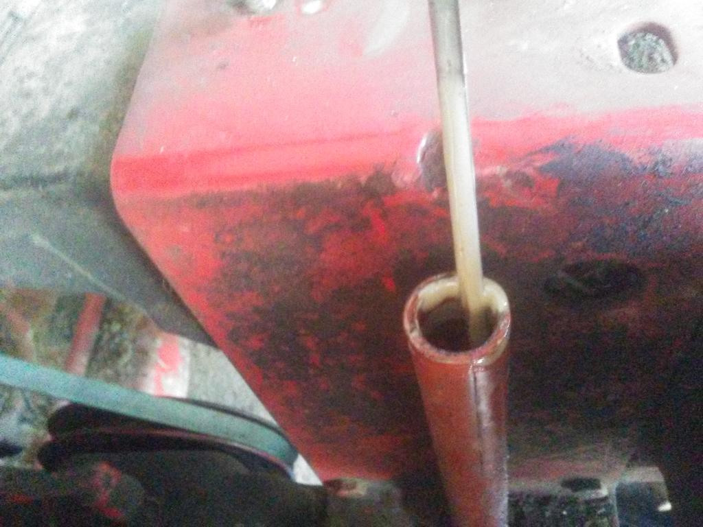

Fish Crawford 13 #1 Posted April 4, 2019 New wheelhorse owner 85 310-8...was told had issues freezing during winter and "supposedly" changed fluid last yr. Checkd distick and thick white almost like melted milkshake consistency. Is 80 w 90 gear oil whats suppose to be wat it calls for? Need suggestions... Share this post Link to post Share on other sites
WHX?? 53,081 #2 Posted April 4, 2019 You got water in the transmission no doubt. . Drain completely and refill with fresh 80/90. Then run it and do it again. Whoever told you it was "just changed" might be on crack. Don't tell me lemme guess I bet this tractor sits outside? Please tell me I'm wrong. In case I haven't done so 2 Share this post Link to post Share on other sites
Fish Crawford 13 #3 Posted April 4, 2019 11 minutes ago, WHX22 said: You got water in the transmission no doubt. . Drain completely and refill with fresh 80/90. Then run it and do it again. Whoever told you it was "just changed" might be on crack. Don't tell me lemme guess I bet this tractor sits outside? Please tell me I'm wrong. In case I haven't done so Yes sir u are right it has been stored outside...i will change it out as u said and then do it again. Thank u! Share this post Link to post Share on other sites

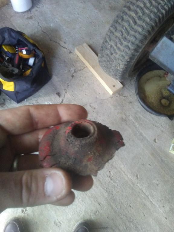

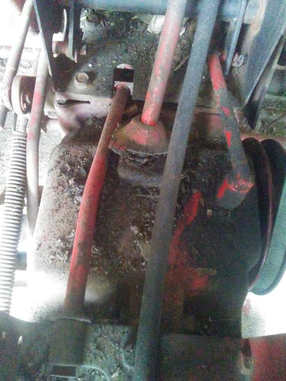

Achto 30,054 #4 Posted April 4, 2019 1 minute ago, Fish Crawford said: Yes sir u are right it has been stored outside...i will change it out as u said and then do it again If the shifter boot is bad, water will find it's way into the tranny quite easily. If the boot is bad, i suggest changing it. 3 Share this post Link to post Share on other sites
Fish Crawford 13 #5 Posted April 4, 2019 Shifter boot is torn as well..darn im glad i found this website! ☺👌 3 Share this post Link to post Share on other sites

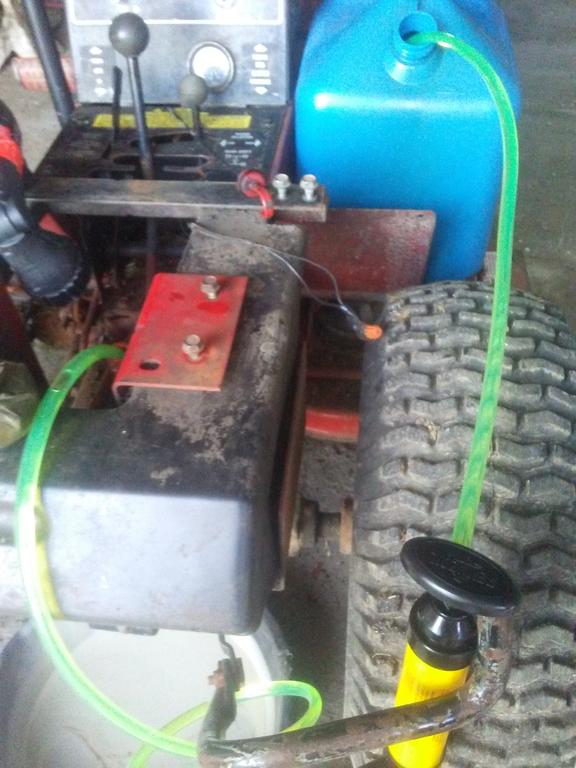

Fish Crawford 13 #13 Posted April 6, 2019 Well slow progress is still progress.drained the " milkshake" and filled with diesel. Removed what was left of the boot..just waitn on new one to arrive and a few more rounds of drain- fill- flush n drive! 2 Share this post Link to post Share on other sites
