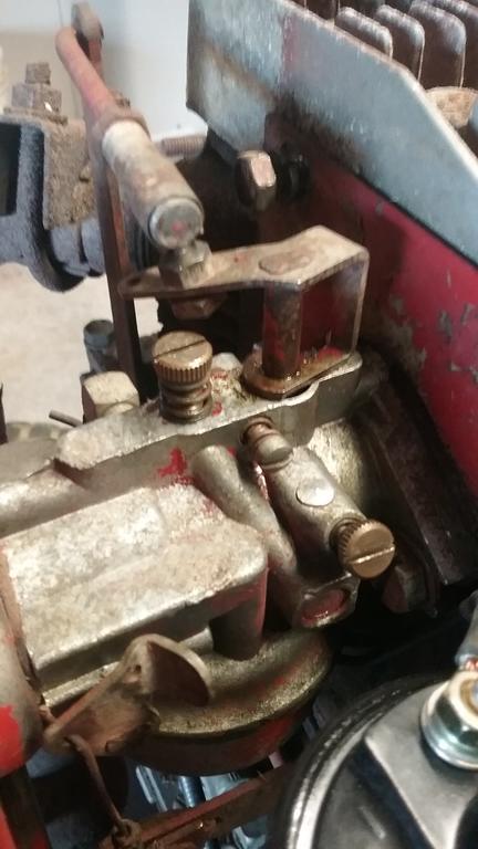

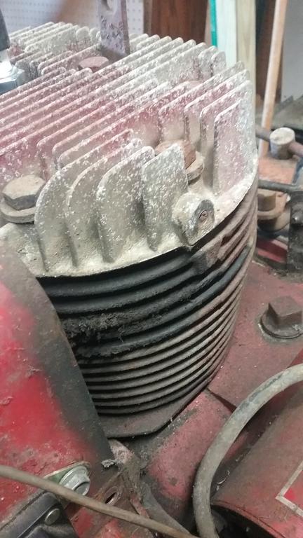

RetroMower 350 #1 Posted April 3, 2019 Finally had time to spend with my recent acquisition and replace some wiring, and a new coil. She must have liked the new parts because she ran pretty well without much fuss for about 30 seconds. Seemed to load up and stop in a white puff as if running really rich. My question is, what do the two brass carb screws control? Idle and mixture most likely but which is which and i would like a good starting point so it can run a little longer for further tuning. Other question is do i have a head gasket leak? I sure hope not Share this post Link to post Share on other sites
Achto 30,214 #2 Posted April 4, 2019 2 hours ago, RetroMower said: and a new coil. She must have liked the new parts because she ran pretty well without much fuss for about 30 seconds. Seemed to load up and stop in a white puff as if running really rich. The new coil? With what you have described I was just wondering if you did not by chance end up with the wrong coil? Some coils require a resistor wire or a resistor ( this is usually written on the coil some place ), if you ended up with one of these it will cause the issue that you described. It does look like you head gasket may be leaking a little. 2 Share this post Link to post Share on other sites

pacer 3,177 #6 Posted April 4, 2019 You said 'white' puff of smoke? White smoke will indicate oil burning - fuel smoke will be black, and a small leak that your head gasket seems to show would not give this indication. A sudden stop with white smoke unfortunately often indicates an internal problem allowing oil to get into the combustion chamber...... Confirm you have spark and fuel and if so and it had been running --- 2 Share this post Link to post Share on other sites

pfrederi 19,280 #8 Posted April 4, 2019 Looking at at the service manual will answer your question about the brass screws and tell you how to adjust them. 1 1 Share this post Link to post Share on other sites
RetroMower 350 #9 Posted April 4, 2019 (edited) 7 hours ago, pfrederi said: Looking at at the service manual will answer your question about the brass screws and tell you how to adjust them. Thank you so much for this. At least this will point me in the right direction when im poking around. The help is much appreciated. With this i can hopefully stop pestering with silly questions Edited April 4, 2019 by RetroMower 1 Share this post Link to post Share on other sites
