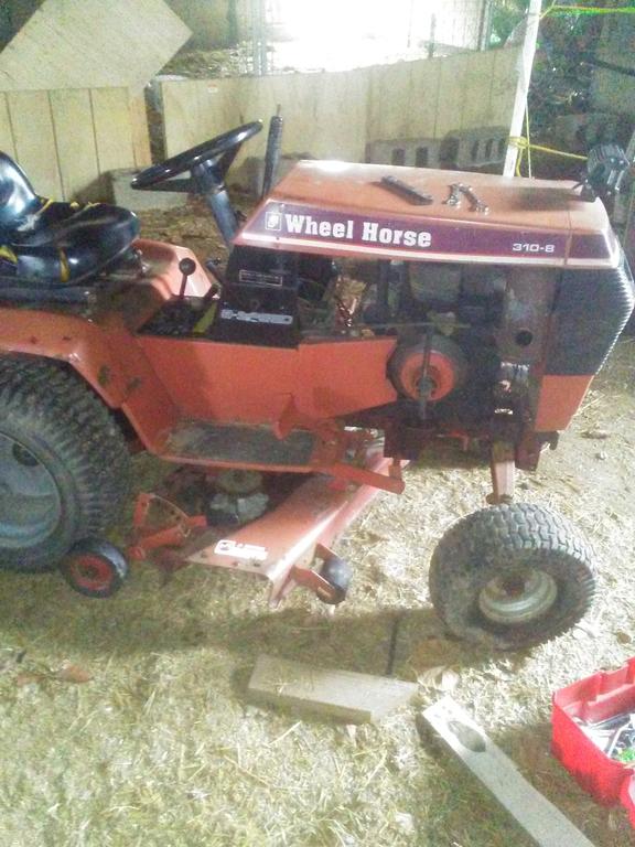

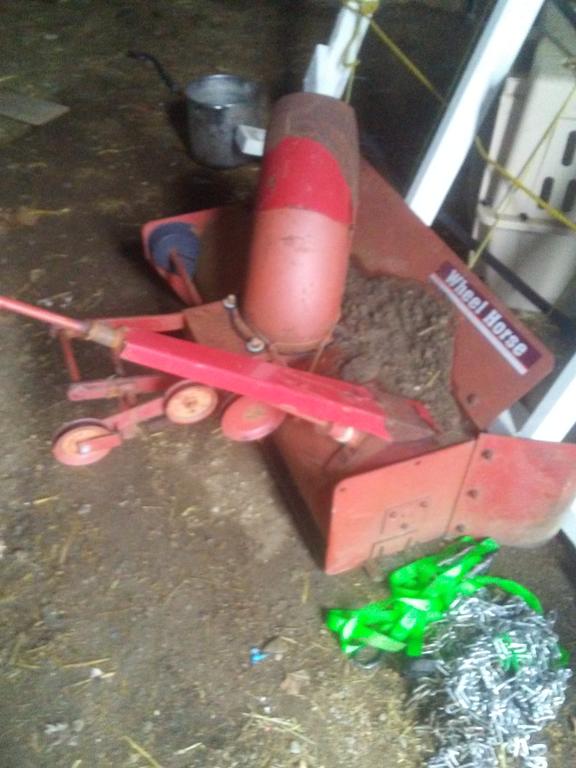

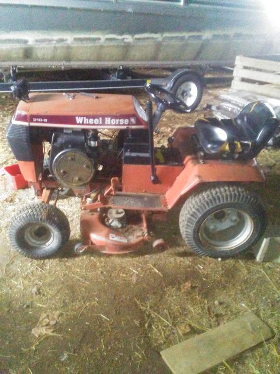

Fish Crawford 13 #1 Posted March 30, 2019 (edited) Just picked up this 310-8 with snow blower from a buddy. Anyone know what belt sizes i need??and possibly wat year it is? 1 for deck and 1 for blower. Kohler 10hp model # k241s..serial number 1604909073 Edited March 30, 2019 by Fish Crawford Misspell 1 Share this post Link to post Share on other sites
WVHillbilly520H 10,378 #2 Posted March 30, 2019 The single stage thrower takes a 5/8"x69" belt, the deck IDK, but from your pictures the mule drive (idler pulleys) is missing from the front attachment to the deck...maroon stripe on hood puts in the 1980s. 2 Share this post Link to post Share on other sites
953 nut 64,127 #3 Posted March 30, 2019 Looks like a 1985, that was the first year of the 310-8 and the only year that they offered the K-241 engine, later ones had the M-10.. There is a model number tag on the fender under the seat, if it still legible it will tell the true year. 1985 Model 21-10K801 1 1 Share this post Link to post Share on other sites
gwest_ca-(File Mod) 12,000 #4 Posted March 30, 2019 That deck looks like a 2-blade 37" side discharge. Click on the picture. Garry 1 1 Share this post Link to post Share on other sites
Fish Crawford 13 #5 Posted March 30, 2019 Yes gwest_ca it is a 37 in side discharge deck Share this post Link to post Share on other sites
gwest_ca-(File Mod) 12,000 #6 Posted March 30, 2019 If it uses the 6-sided drive belt print out this page and have it with you when you put it together. Later decks used some flat idlers and a regular 4-sided belt. Garry 1 Share this post Link to post Share on other sites
