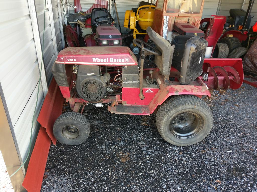

Robert ODonnell 0 #1 Posted March 29, 2019 (edited) Can a mower deck off a 86 Wheel Horse be made to fit a 83 Work Horse? Edited March 29, 2019 by Robert ODonnell Share this post Link to post Share on other sites
WVHillbilly520H 10,378 #2 Posted March 29, 2019 8 minutes ago, Robert ODonnell said: Can a mower deck off a 86 Wheel Horse be made to fit a 83 Work Horse? As long as they are the same type ie 300/400 series are basically the same but a 200 series won't work on the 3-400 series, So what model #s are both tractors you referring to...on the hood decal is the model designations 1 Share this post Link to post Share on other sites
953 nut 64,322 #3 Posted March 30, 2019 Basically any wheel Horse with a horizontal crankshaft engine, Mule drive and a Mid Mount Attach-O-Matic will accept the mower from any other similar tractor as long as the horse power is great enough to swing the blades. This list will confirm the direct fitment for you. file:///C:/Users/dickf/Downloads/WH Interchange 1955-2000.pdf 1 1 Share this post Link to post Share on other sites
