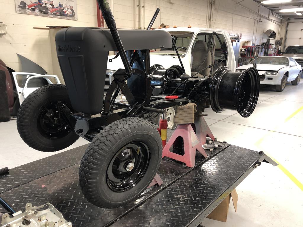

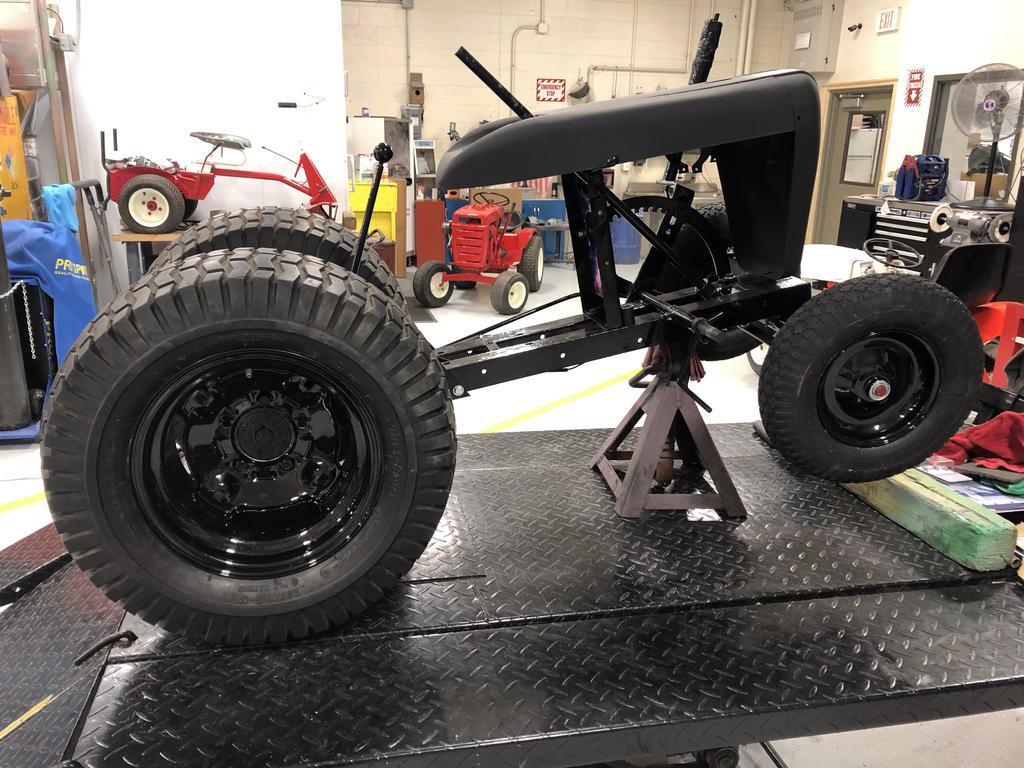

BHunter
We got the tires on today and picking up a motor this weekend.
  • Like 3
  • Excellent 2
  • Thanks 1
WHNJ701
a red pin strip around the rim would look sharp
  • Like 3
BHunter
I agree
71_Bronco
That looks sharp.
I think it would be kinda cool all gloss black, with dark grey wheels. Either way, I that's gonna be a sweet ride.
BHunter
4 hours ago, 71_Bronco said:
That looks sharp.
Thanks

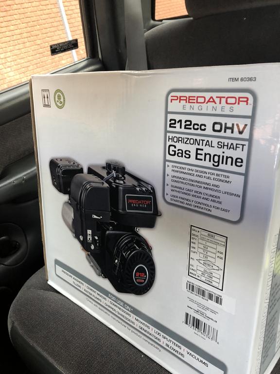

WHNJ701
what engine is going in it?
BHunter
6.5 hp predator for now. I tried to fit a 10 hp Briggs but it hit the hood support. I might make a custom hood support after the Big Show. I’ll leave it alone If the predator runs good enough .

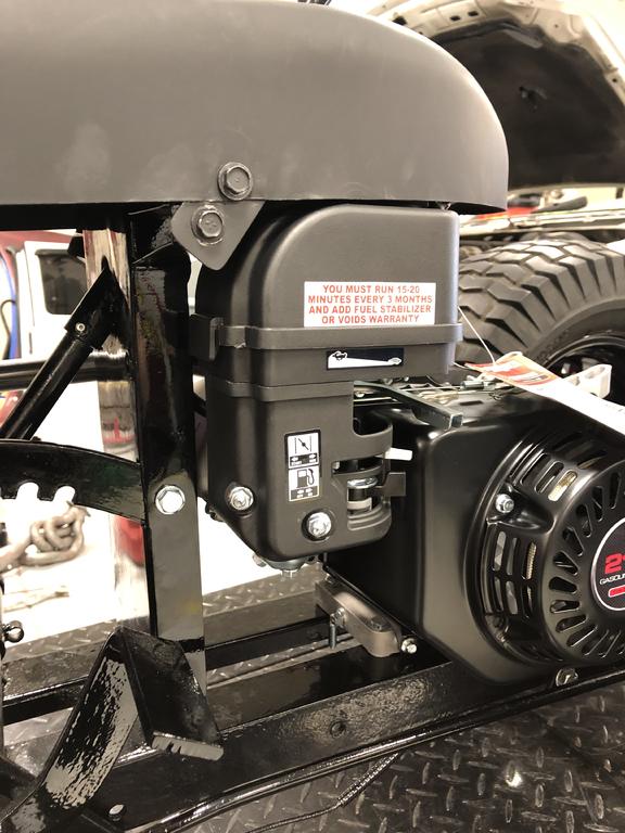

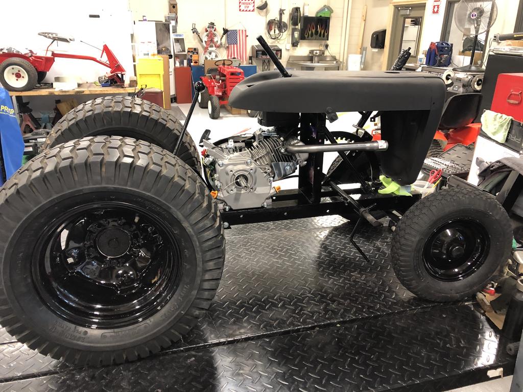

BHunter
Got the engine in. It bolted right up. Had to add spacers to the hood to lift it.
I need to to locate a belt guard. I saw reproduction ones on eBay but now they aren’t there anymore.
I think I’m going to name it Fifty Shades of Black because of all the different black parts on it.
  • Like 2
  • Excellent 1
  • Thanks 1
  • Haha 3

stevebo
I actually dig the look of that predator in there.
BHunter
Thanks Steve.
I was hoping to use the predator gas tank for now until I find a suburban one at the Show but the shifter hits it and I can’t. I might have to warm the shifter up with a torch and put a slight bend in it if I can’t find one.
dells68
I wouldn’t want to mess with the shifter.  What about zip ties to temporarily hang the predator tank under the hood?  Or search flebay for a small cheap used tank to use until you find the right one?
