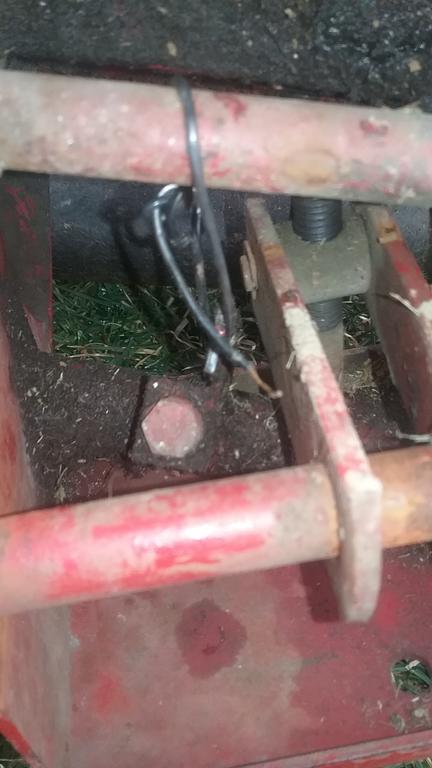

Randy520-8 6 #9 Posted April 14, 2019 Spring number 15 hooks into bracket 12. where does it go on the other side? It looks like it may have went into the corner of the mule drive at least looks like where the wear of the previous spring was. Share this post Link to post Share on other sites
lynnmor 7,847 #10 Posted April 14, 2019 That is correct. Share this post Link to post Share on other sites
Randy520-8 6 #11 Posted April 14, 2019 Cool thank you very much Share this post Link to post Share on other sites
