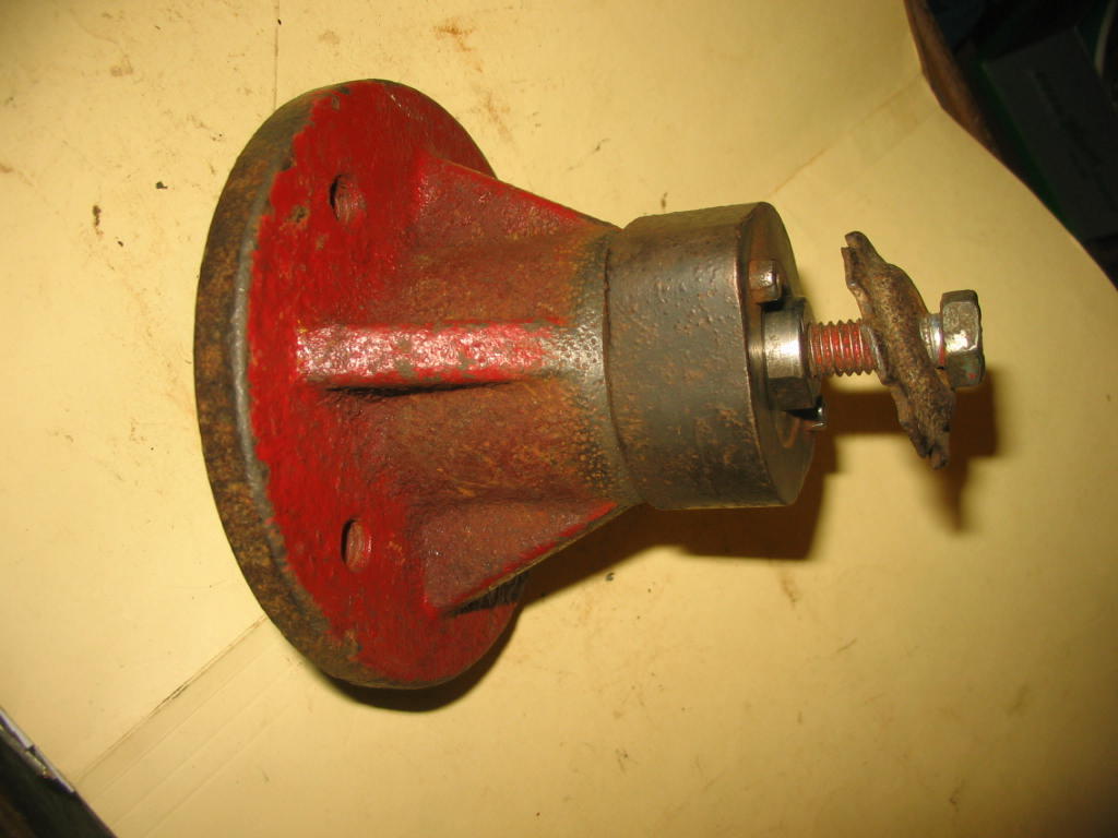

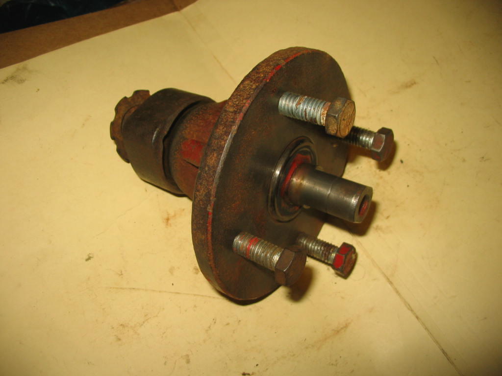

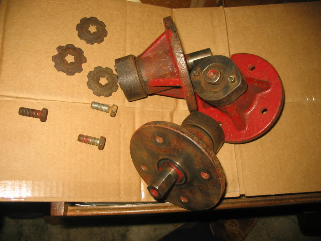

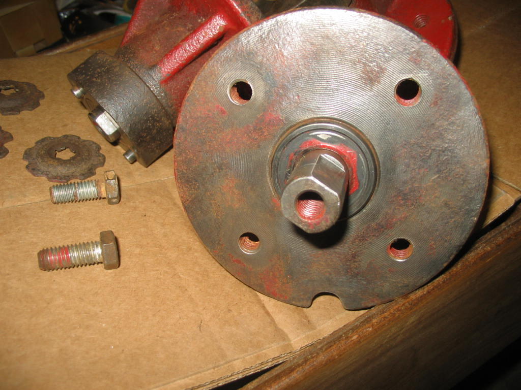

daveoman1966 3,882 #6 Posted March 25, 2019 Charge 10 was made in 1969 (1-7041) and in 1972 (1-0410). Presuming the latter 1-0410 the 36" deck was model 5-0601 and the spindles / pullies / blades were known as the Double-D configuration. Here are THREE spindle assemblies with GOOD bearings, spindle cups, and dome washers that I took from a deck last year. I MAY also have useable side pulleys...will have to check on blades. For further details / pics / prices...send me an OFF-SITE email. my email address is: daveoman@windstream.net 1 Share this post Link to post Share on other sites
