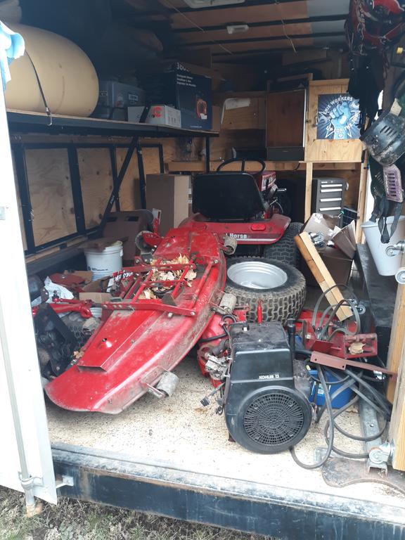

We had a shed fire last August.  I was able to save my much loved 97 416h but lost 80% of tools, benches ect...  I have a few other WH's that I'd like protected from the weather.
The old and replacement shed is 10x20ft.
Insurance helped us through it and I got a fair settlement on building and contents lost.
I have had problems in moving the old burnt shed and having the new one built.  Now this wasn't a problem because I am storing all my stuff a good friends enclosed trailer.
He needs it back asap because of unforeseen life things happening to him.
So, today I picked up a 10 x 17 "garage" from HF to store everything till I get my shed built in 1-2 months.

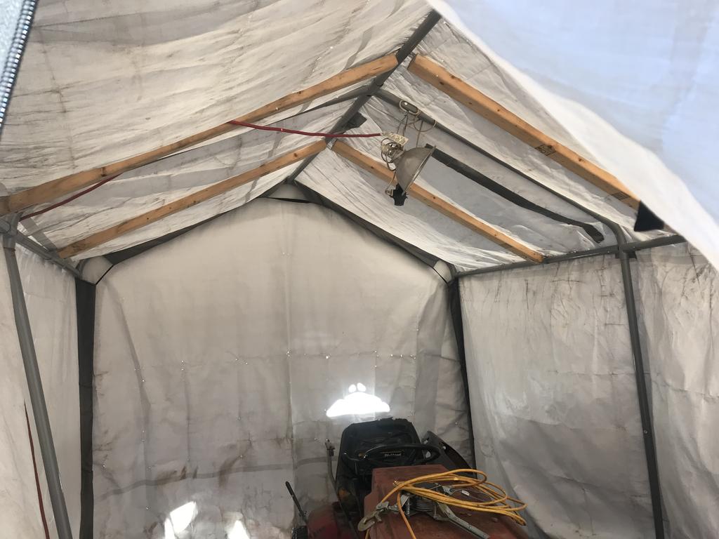

I use one for the my tractor that is used for snow plowing.  Because of the snow I had to add extra supports rafters on the roof.  They got put on after the shed was together and have worked out good for me.  The major problem I had is that i hit it with my boat trailer on the corner and bent one of the main poles.  Besides my mistake it has been a good shed for the tractor.  If you want pictures of what I did for extra support to handle the snow I can get them tonight.

Toasty
I just used 2x4s and plumbers tape to attach them.  After the first winter I had to also add Tarp tap in the inside where some of the supports rubbed a lot again the tarp.  One of my anchors came out when the ground turned to mud and got some wind which is why the side is pulled in.  Adding the supports help the tarp from just collecting a ton of snow between the supports.

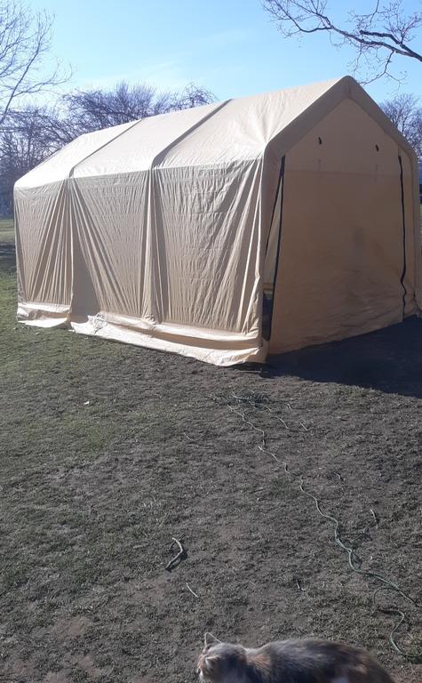

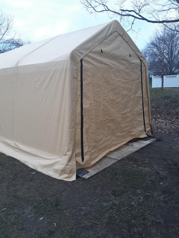

Got the temporary shed put up today. I can make it work but I'm not too impressed by the bottom part of it.
OEM, the canvas sits too high off the ground which will cause issues.
Its "ok" overall. The quality is what I expected.
I basically learned that an about $175 temporary (<5 years) shed is a $175 temporary shed! Lol. Lots of extra supports etc. have been added and more needed.
Cory
Cee245
This is NOT on level ground hence the wrinkles.
  • Like 1

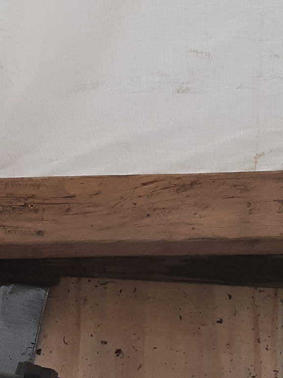

I put a tarp on the "floor" and put a bunch of 40" x 40" x 1" plywood on it. (Free from work) Also put 4x4s around the 3 sides.
I'm not sure how to tackle the door part of my big tent. Lol
