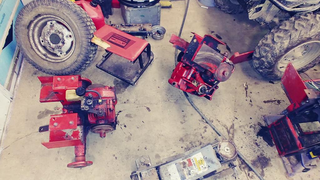

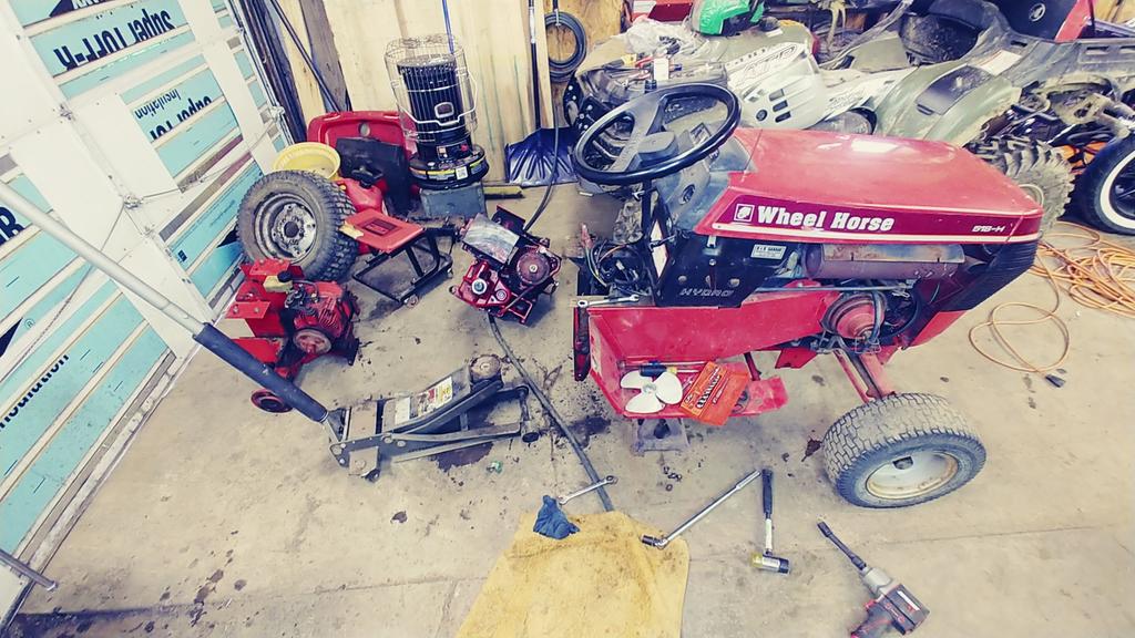

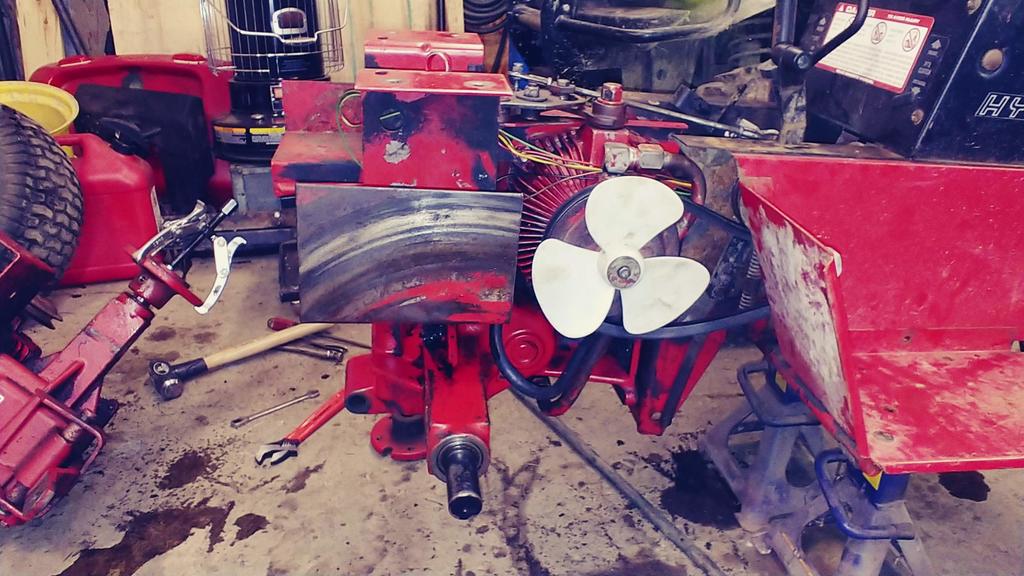

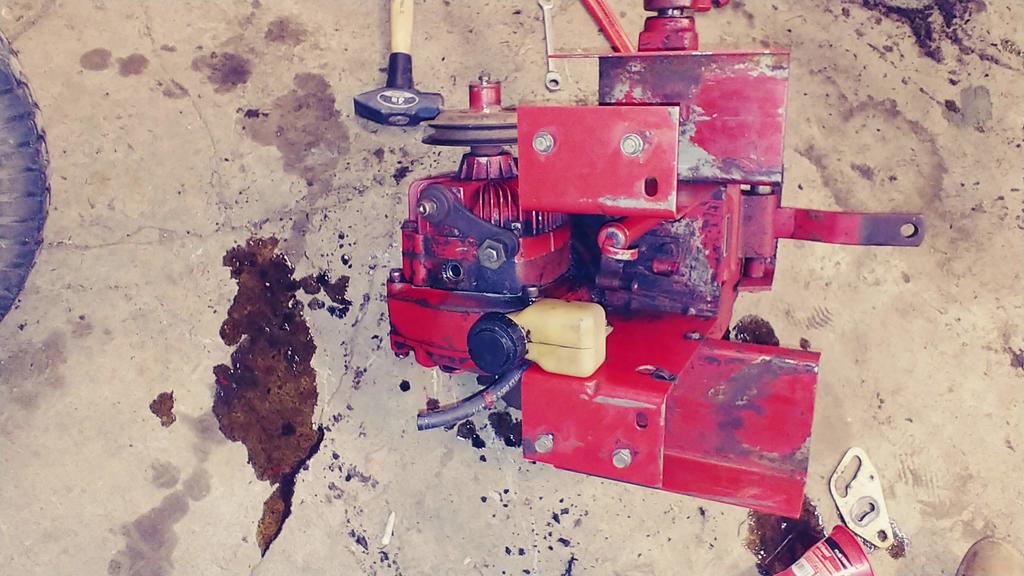

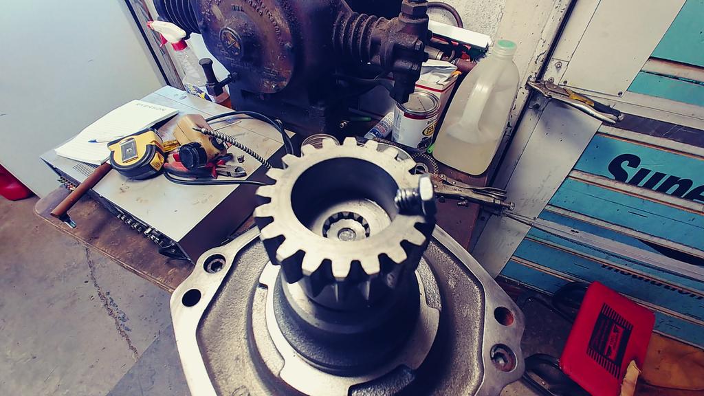

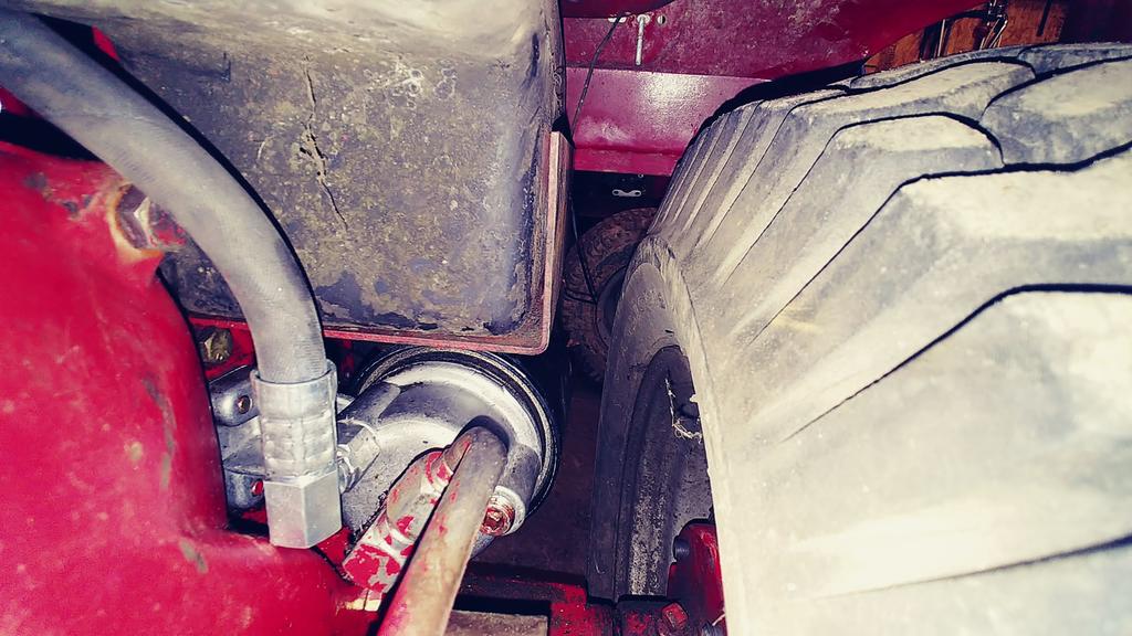

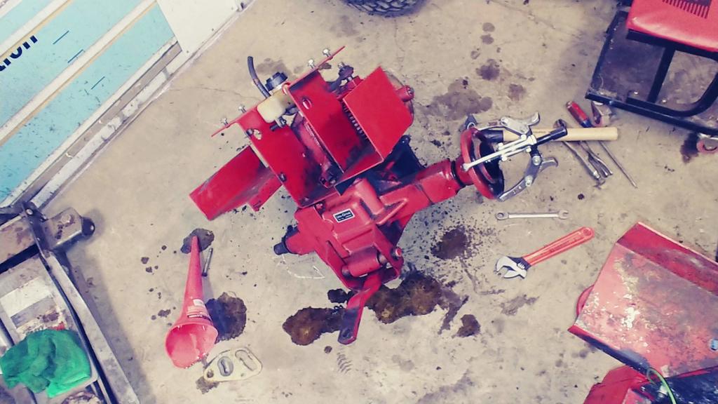

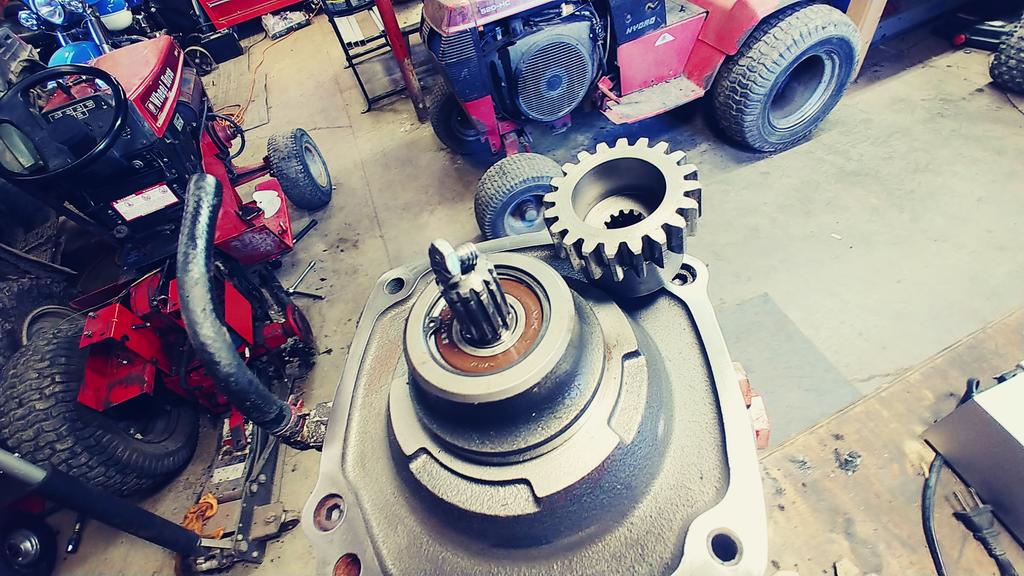

Ralph S 342 #1 Posted March 23, 2019 I need a blown up drawing of the parts digram for the 700 series pump. I think I lost a washer in the gear housing. Any help would be very much welcome.The pictures will show you what I'm up against. Share this post Link to post Share on other sites

gwest_ca-(File Mod) 12,387 #3 Posted March 23, 2019 item #3 is a 103995 washer https://www.partstree.com/parts/toro/parts/103995/ Garry 1 Share this post Link to post Share on other sites

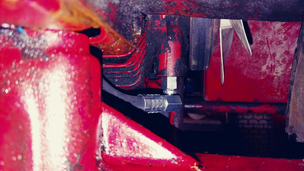

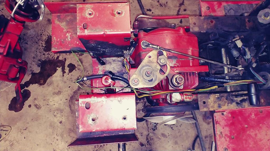

Ralph S 342 #5 Posted April 1, 2019 Well, I recieved my parts order and put everything back together. That didn't fix anything. I removed the whole rear end and installed an 1100 series trans axle in it and tested it. Still nothing ! I realized that I may have to get a hydraulic line made to bypass the hydralic lifting cylinder so that the fluid can circulate through the pump properly. Pluging the bottom hole of the pump and one of the holes in the filter housing didn't work and that would be my only other option.Does anyone have any thoughts on this solution ? Share this post Link to post Share on other sites
gwest_ca-(File Mod) 12,387 #6 Posted April 1, 2019 I there a chance the missing washer is hiding in the transaxle somewhere? If you jack up the back end and turn one rear wheel what does the other wheel do? Garry Share this post Link to post Share on other sites
Ralph S 342 #7 Posted April 1, 2019 (edited) 34 minutes ago, gwest_ca said: I there a chance the missing washer is hiding in the transaxle somewhere? If you jack up the back end and turn one rear wheel what does the other wheel do? Garry the other wheel spins opposite direction. I swapped out the 700 for the 1100 and now I have to get a bypass hose made for it and it should be fine. I'd still like to know what went wrong on the 700 though. I will definately split the cases to find that washer. LOL Edited April 1, 2019 by Ralph S Share this post Link to post Share on other sites
Ralph S 342 #8 Posted April 1, 2019 33 minutes ago, gwest_ca said: I there a chance the missing washer is hiding in the transaxle somewhere? If you jack up the back end and turn one rear wheel what does the other wheel do? Garry the other wheel spins opposite direction. I swapped out the 700 for the 1100 and now I have to get a bypass hose made for it and it should be fine. I'd still like to know what went wrong on the 700 though. Share this post Link to post Share on other sites
Ralph S 342 #9 Posted April 10, 2019 (edited) The transplant went well. The bypass hose worked perfect and it moves on its own power now. Edited April 10, 2019 by Ralph S Share this post Link to post Share on other sites
