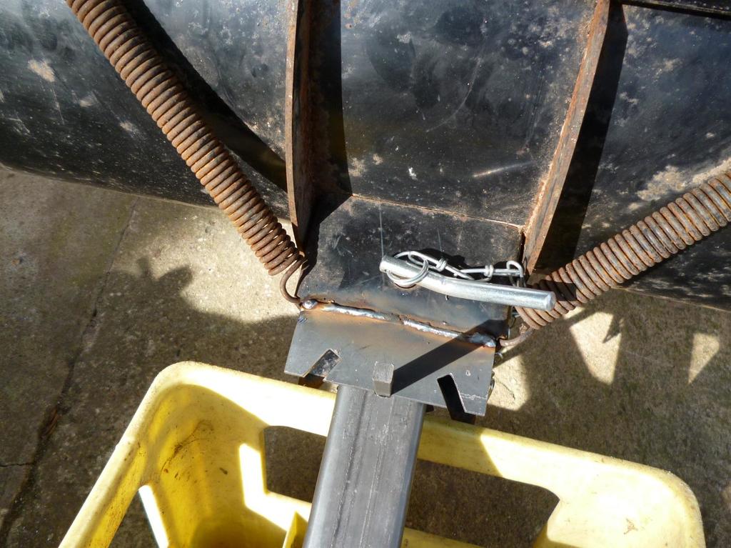

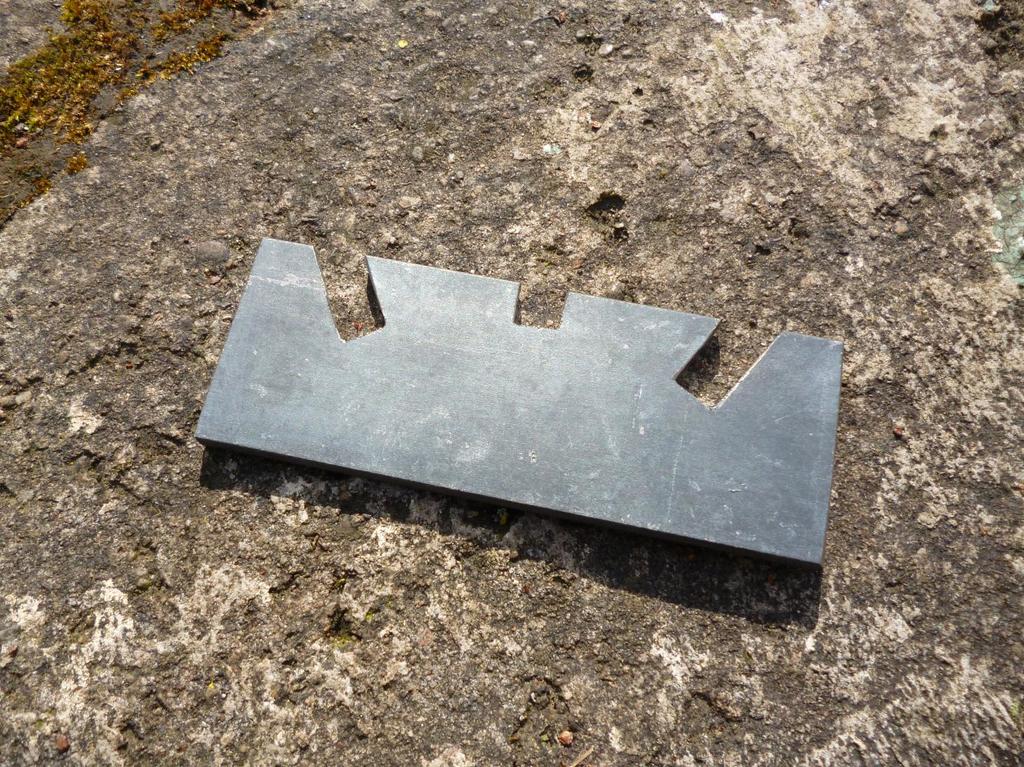

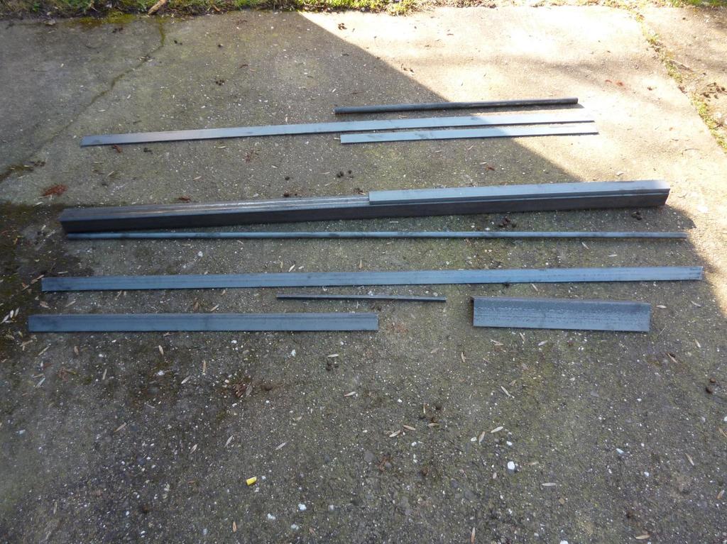

wheeliepower 141 #1 Posted March 23, 2019 (edited) Start of construction homemade snowplow As an example I use a youtube video of a homemade snowplow Delivery steel First fitting First I drilled a 20mm hole for attaching the bolt of the snow blade. It looks like this with snow blade. Then I drew a second plate to lock the snow blade. After i have filed everything fitting the plate looks like this now. Then I made a square hole in the steel profile. Now you can lock the plow in different positions. Then I welded iron blocks to the profile to compensate for the difference in the profile. It continues the next days........................................................................ Edited March 23, 2019 by wheeliepower 3 4 Share this post Link to post Share on other sites

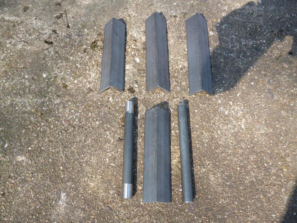

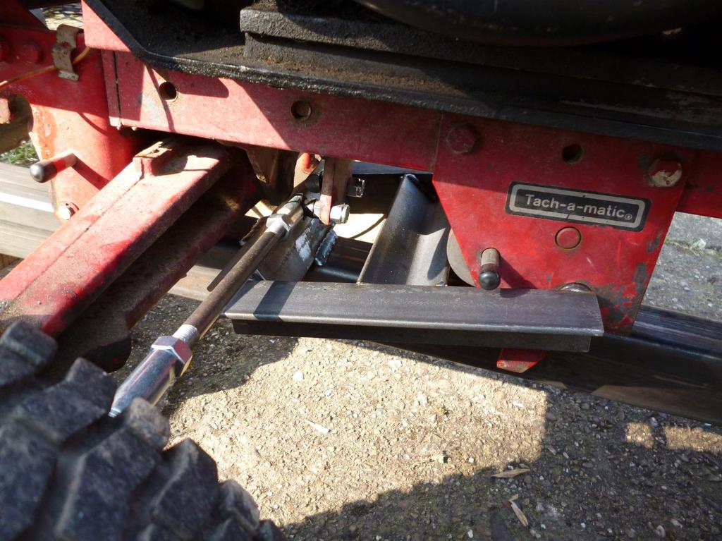

wheeliepower 141 #4 Posted March 23, 2019 (edited) it continues with the homemade Today sawed as the first individual profiles fitting. Then I welded out of these parts a frame. Then I attached this frame to my hollow profile. So it looks finished welded. .....and so incorporated. Then I started making the tail. The u-rail serves as a guide later. This is what the finished hollow profile looks like. On the tractor, this hollow profile is plugged into the trailer hitch. Then I built another angle to raise and lower the hollow profile and thus the snow blade. Now it is dark and I am closing time, because I no longer see the tool !!!!!!!!!!!!!!!!!!!!!!!!!!! Edited March 23, 2019 by wheeliepower 4 Share this post Link to post Share on other sites
