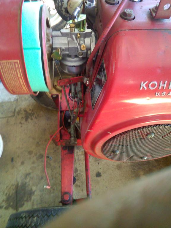

The Tuul Crib 7,340 #1 Posted March 21, 2019 I just ordered an air filter off of fleabay and received the wrong filter. Now the seller told me it was my fault because I didn’t know the correct part number. Said on his ad clearly will fit 241 321 and 341. Now does anyone know a correct part number for a air filter for a K321? Share this post Link to post Share on other sites
Herder 2,355 #2 Posted March 21, 2019 Is the height of filter the issue? K241 to 341 could use a short air filter and cover, this air filter is about 1 1/2" high. The K321 & 341 may have either a short or tall air filter and cover. the taller filter is about 2 1/2" high. This one is a taller air filters being used on a K302, I have extended the threaded rod in order to use it in the shorter style air cleaner cover. Sorry don't have the part # if you have a Tractor Supply store they carry Kohler air filter. Share this post Link to post Share on other sites
gwest_ca-(File Mod) 11,853 #3 Posted March 21, 2019 Look through this list. Click on the picture Garry 2 Share this post Link to post Share on other sites
squonk 44,918 #4 Posted March 21, 2019 Kohler filters aren't engine specific as it all depends on what it's on or what cover is used. I had people wanting Kohler air filters all the time. We stocked all of them so I told them to bring in the old one or the cover Share this post Link to post Share on other sites
JoeM 9,327 #5 Posted March 21, 2019 I use this one on my 12HP. This site give the dimensions. https://www.mfgsupply.com/19-1386.html Filter fits Kohler models K241, K301, K321, & M8 (8 thru 14 hp) Magnum engines Kohler 235116 Height 1-7/8" Diameter OD 6" ID 4-3/4" 1 Share this post Link to post Share on other sites
