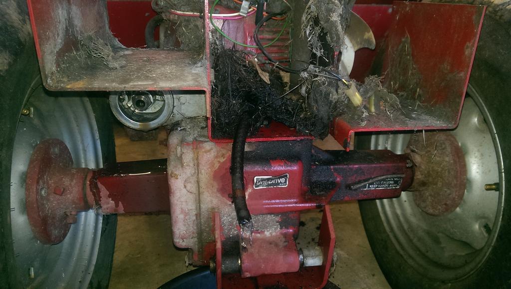

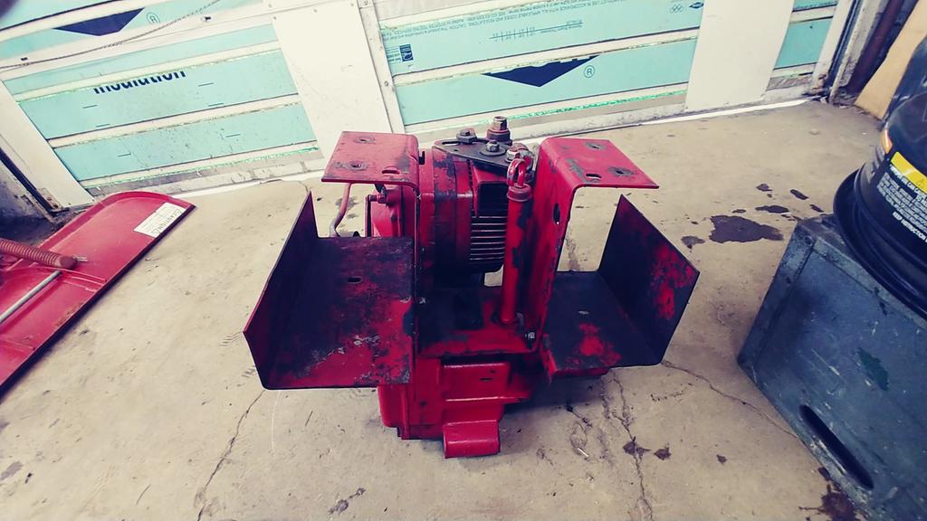

Ralph S 342 #6 Posted March 22, 2019 8 minutes ago, Dirtdog524 said: just find a good 1100 series transmission . very few changes need to be made for it to work I have a complete rear end out of a 520 HC. the conrtol part is totally diferent than the one that is in it. only marks i see on the broke one is a tag that says Uni Drive. Share this post Link to post Share on other sites

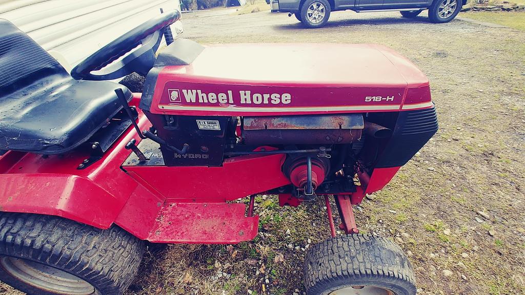

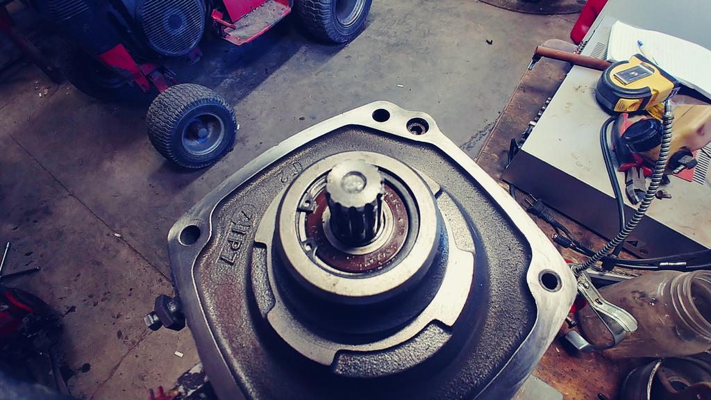

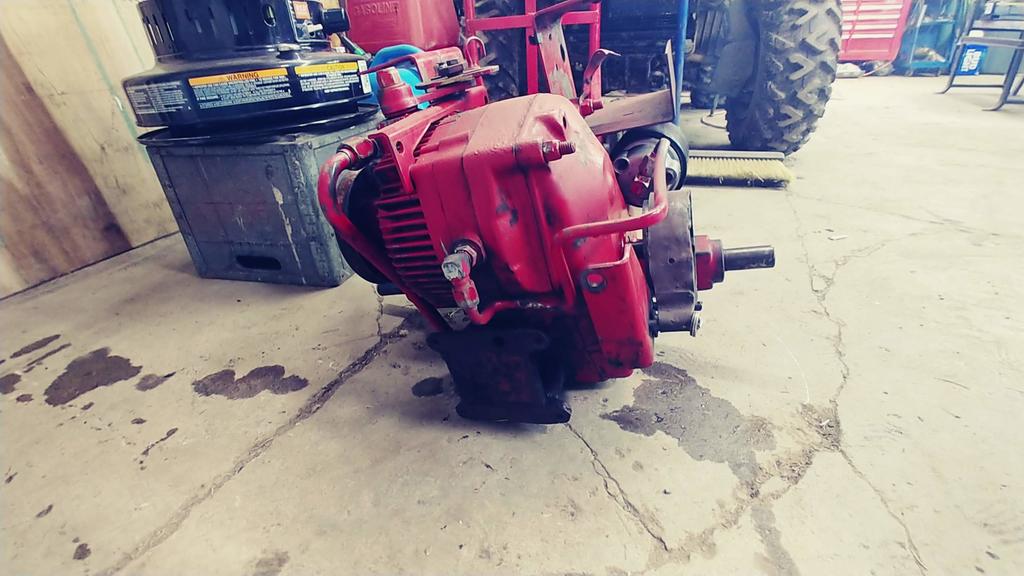

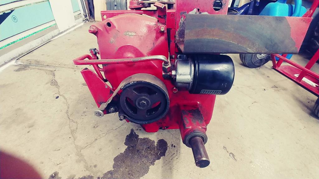

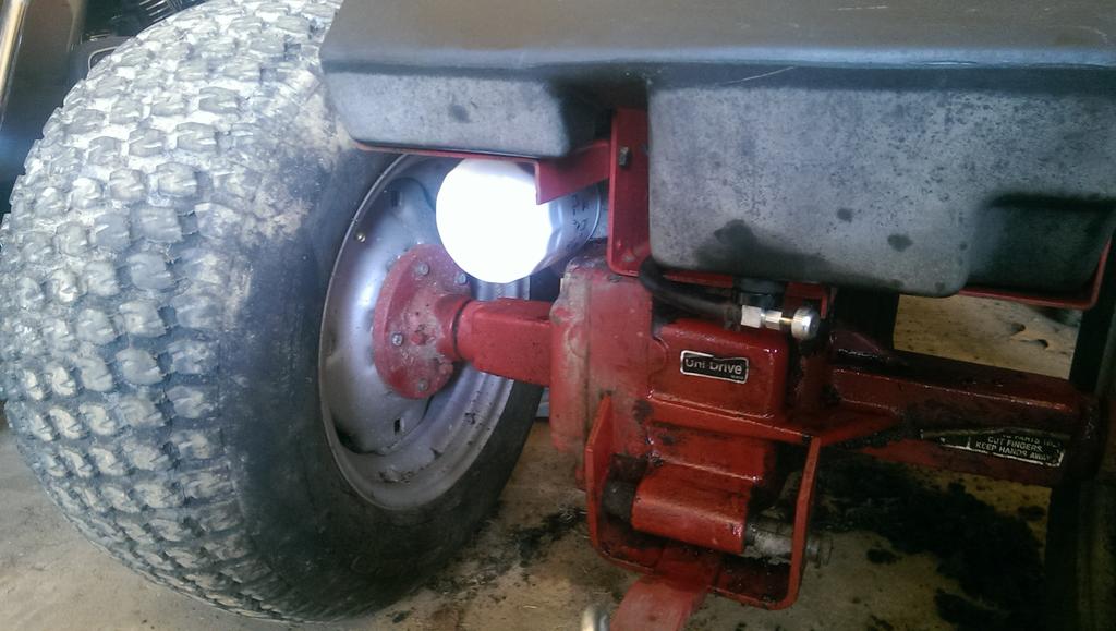

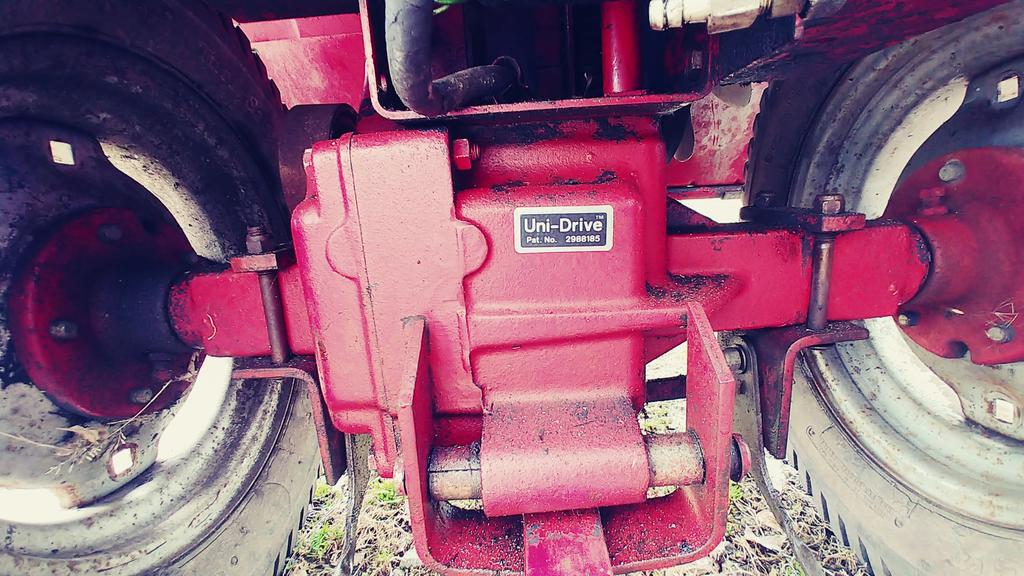

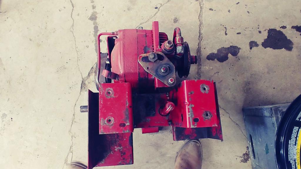

Ralph S 342 #8 Posted March 22, 2019 the first pic is what is in the 518 H and the rest of those pics are of the spare that I have. will I be able to modify the second one to work ? Share this post Link to post Share on other sites
Ralph S 342 #10 Posted March 22, 2019 5 minutes ago, Ralph S said: Thats the only Tag i can see on the rear end. is this an 1100 series ? Share this post Link to post Share on other sites
WVHillbilly520H 10,378 #11 Posted March 23, 2019 (edited) 3 hours ago, Ralph S said: Thats the only Tag i can see on the rear end. is this an 1100 series ? The 1100 series has a filter to the left side as I'm showing in my pictures, the 700 series which is normally found in the 516-518H and the 312A doesn't have a filter or hydraulic lift but usually the manual lift arm on the left side of the tractor just like yours. Edited March 23, 2019 by WVHillbilly520H 1 1 Share this post Link to post Share on other sites

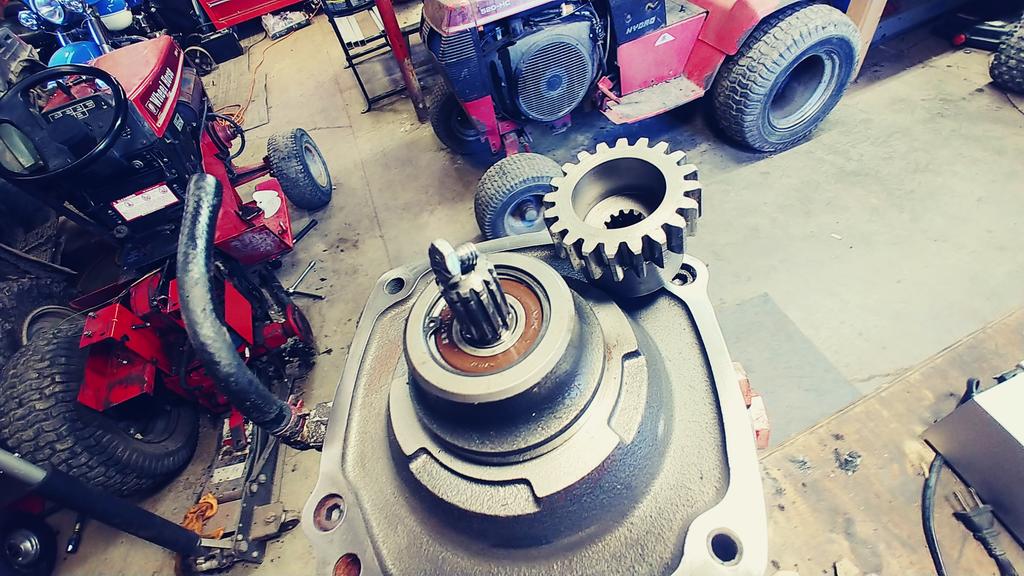

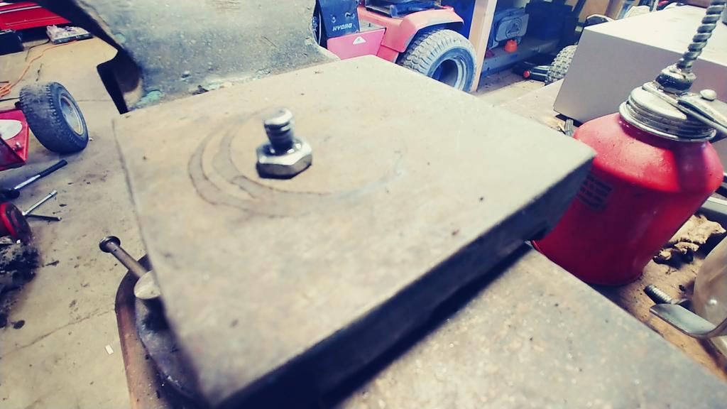

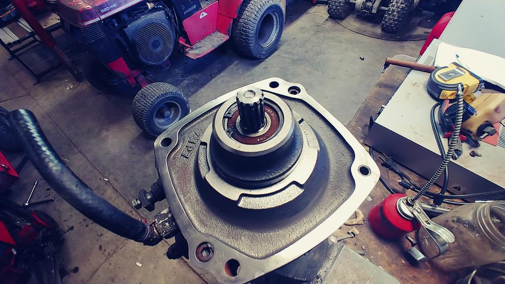

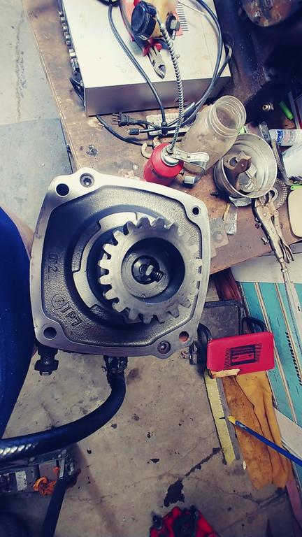

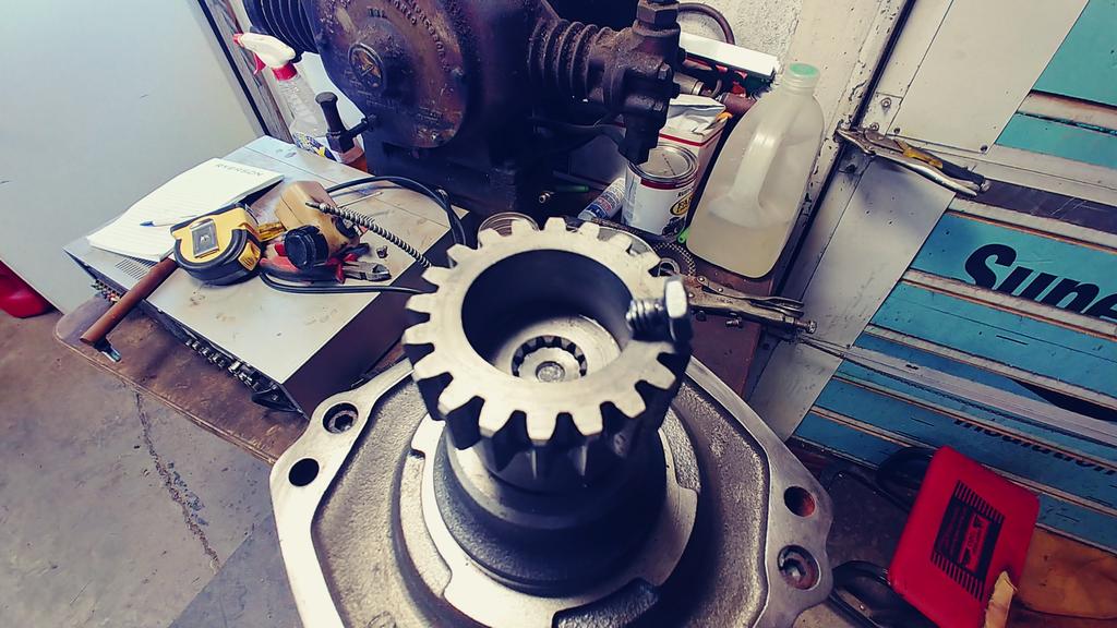

Ralph S 342 #12 Posted March 23, 2019 I found my problem. I took the pump off and found that the bolt that hold the gear on the end of the shaft snapped off. Once I remove the broken bolt, which is going to be tricky, and fish around for a washer in the bottom of the transaxle housing my problem should be resolved with a new bolt and washer. A cheap fix with a little bit if time and a new gasket. Share this post Link to post Share on other sites
Ralph S 342 #13 Posted March 23, 2019 On 3/21/2019 at 3:55 AM, lynnmor said: Make sure that the control is moving the plate on top of the transmission properly. Check the oil level and let it run a few minutes before attempting to move. Check the input belt pulley to see if it is loose. Check both wheel hubs to see if they are tight on the axles. I found my problem. A pesky little 1/4-20 bolt snapped off. I luckily found the bolt but the washer is in the bottom of the gear housing somewhere. Share this post Link to post Share on other sites
Ralph S 342 #14 Posted March 23, 2019 23 minutes ago, Ralph S said: I found my problem. I took the pump off and found that the bolt that hold the gear on the end of the shaft snapped off. Once I remove the broken bolt, which is going to be tricky, and fish around for a washer in the bottom of the transaxle housing my problem should be resolved with a new bolt and washer. A cheap fix with a little bit if time and a new gasket. Share this post Link to post Share on other sites
Ralph S 342 #15 Posted March 30, 2019 I put it all back together with new bolt and washer for the gear. I thought that might be the problem but there is something else wrong with it. Share this post Link to post Share on other sites

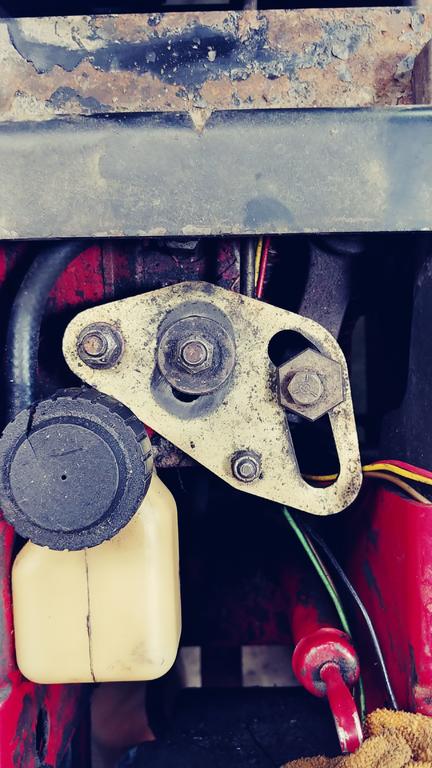

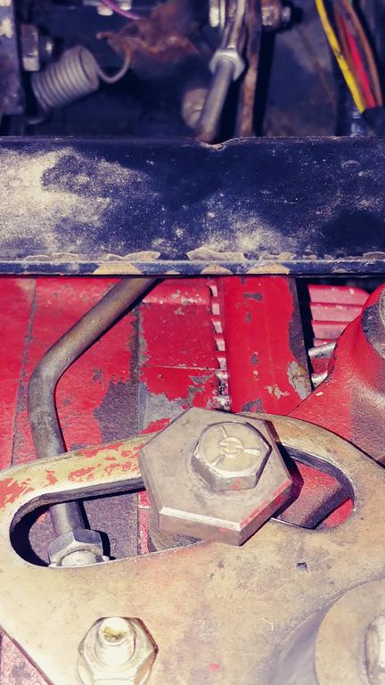

Ralph S 342 #16 Posted April 2, 2019 I put the 1100 in and everything is fit up and the control linkage needed tweaked a little but it functions just fine. I do have to make a bypass hose to eliminate the lift cylinder. I have Lowell the wheelhorse man, from Minnesota making it up for me as soon as I get the measurements. Fingers. Crossed. Share this post Link to post Share on other sites

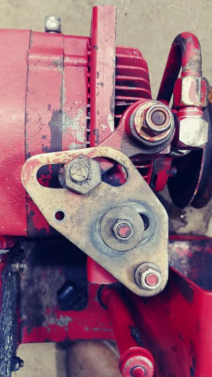

Ralph S 342 #17 Posted April 2, 2019 On 3/22/2019 at 4:38 PM, Dirtdog524 said: just find a good 1100 series transmission . very few changes need to be made for it to work The 1100 is installed with a few little tweaks of the controller linkage. All I need now is a cylinder bypass hose made up. Lowell the wheel horse man is going to make one once I send him the measurements. Here is a picture of the linkage. Share this post Link to post Share on other sites
Ralph S 342 #18 Posted April 2, 2019 On 3/22/2019 at 4:38 PM, Dirtdog524 said: just find a good 1100 series transmission . very few changes need to be made for it to work Share this post Link to post Share on other sites
Ralph S 342 #19 Posted April 10, 2019 The transplant went well. there is one thing that nobody mentioned about the job. If anybody goes to try this, remember that you need to have a custom bypass hose made to run from the bottom ofthe pump to the oil filter bracket, It took a minute to figure out but Wheelhorseman helped me out and sent me one. Share this post Link to post Share on other sites
