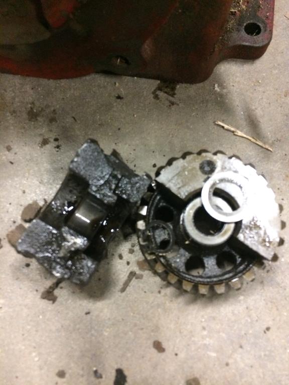

953 nut 63,956 #4 Posted March 18, 2019 Yet another first hand testimonial for the removal of balance gears! Please share some pictures of the carnage. 3 Share this post Link to post Share on other sites

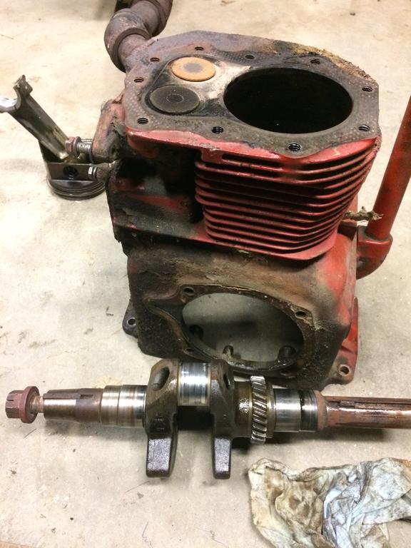

Hacksawhero123 351 #7 Posted March 21, 2019 Carnage pics Mark 1 Share this post Link to post Share on other sites

richmondred01 2,333 #13 Posted March 23, 2019 Look at the bottom of the cylinder apron and see if any chips or cracks. If not you should be good to go. You were lucky I’ve seen them blow out the side of the block. Share this post Link to post Share on other sites
