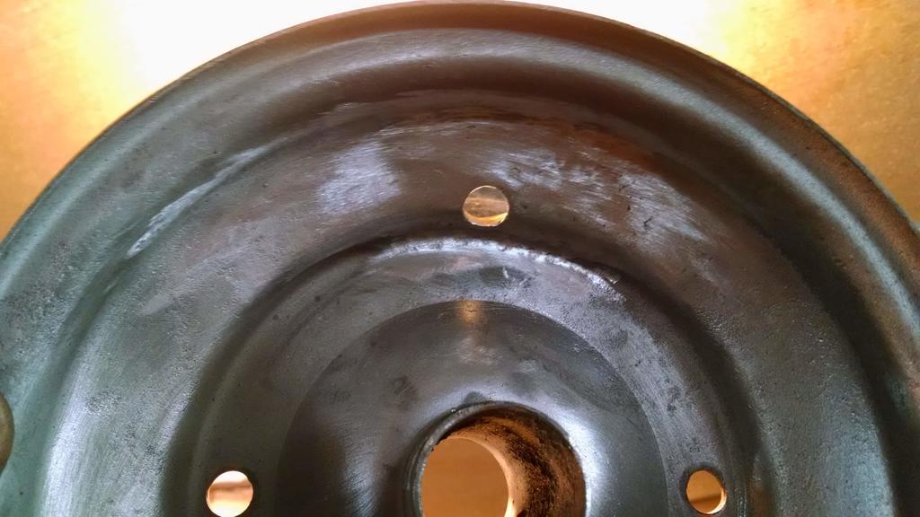

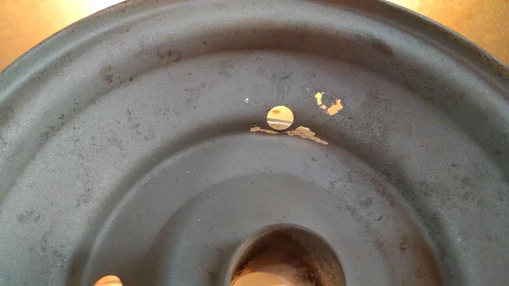

HappyHillbilly 86 #1 Posted March 17, 2019 Hey, folks! One of my front wheels sat with a flat tire for years and part of the rim is corroded. Is this rim salvageable for a restore of the tractor? If so - how? What do I need to do? As for the inside, sealing area, there's one place that looks like it will need a bit of work to get a good seal for a tubeless tire. The bearings appear to be in good shape. As always, thank you for your time & consideration. Later! Mike 1 Share this post Link to post Share on other sites
pfrederi 19,298 #2 Posted March 17, 2019 Clean it up paint it and use a tube 5 Share this post Link to post Share on other sites
HappyHillbilly 86 #3 Posted March 17, 2019 2 minutes ago, pfrederi said: Clean it up paint it and use a tube Thanks. Yeah, I don’t have much of a problem doing that - my main concern is how to cosmetically repair that corroded area which will be visible with a tire on it. Share this post Link to post Share on other sites

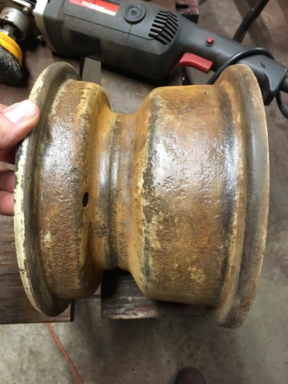

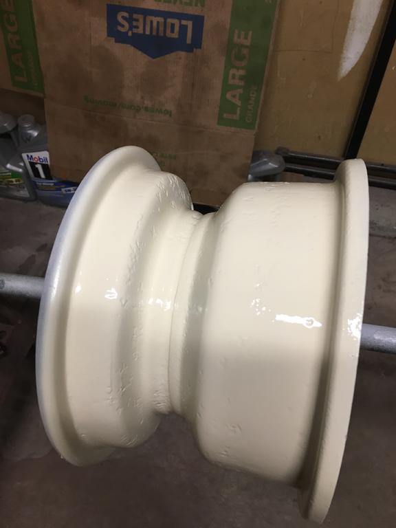

classiccat 548 #18 Posted March 17, 2019 (edited) I was able to get a bead to seat on This old, crusty wheel to seal using JB-Weld / sanding / paint: No tube, no seam sealer and so far no leaks. Edited March 17, 2019 by classiccat 4 3 Share this post Link to post Share on other sites
pfrederi 19,298 #19 Posted March 17, 2019 5 minutes ago, classiccat said: was able to get a bead to seat on his old, crusty wheel to seal using JB-Weld / sanding / paint: No tube, no seam sealer and so far no leaks. Very nice work and outcome...Tube would have been a lot less work 3 Share this post Link to post Share on other sites

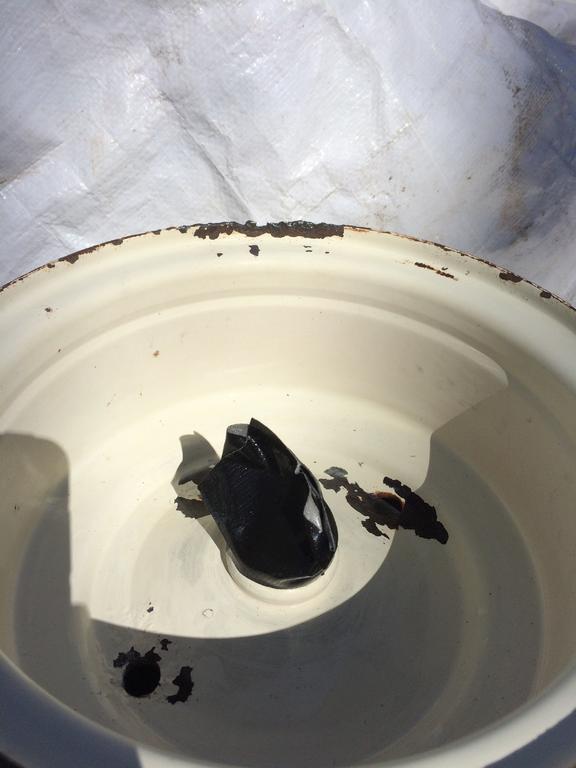

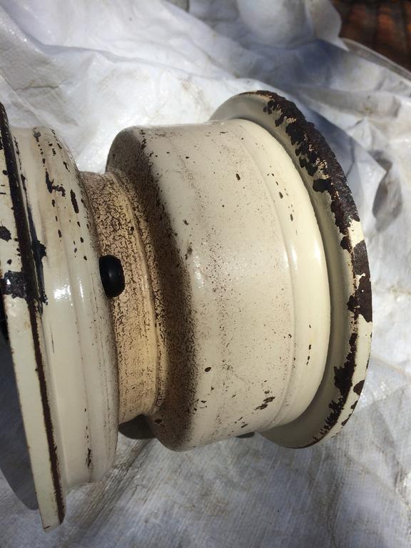

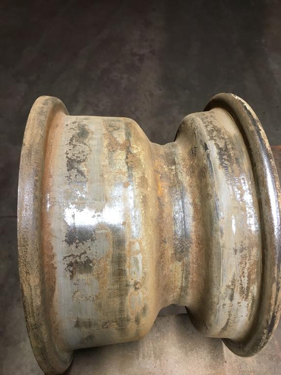

Achto 30,228 #21 Posted March 18, 2019 Almost any thing can be saved. I was able save this rim by doing some "noodle welding" with a wire feed welder followed by a lot of grinding. 4 4 Share this post Link to post Share on other sites
