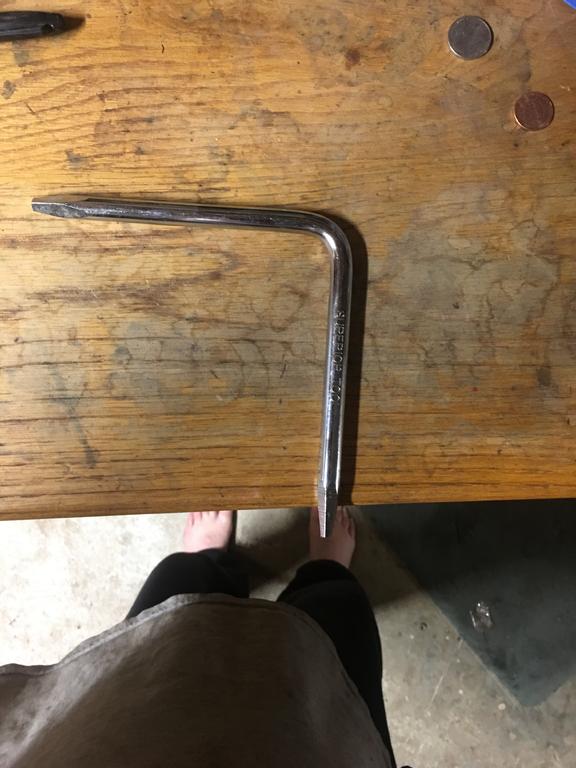

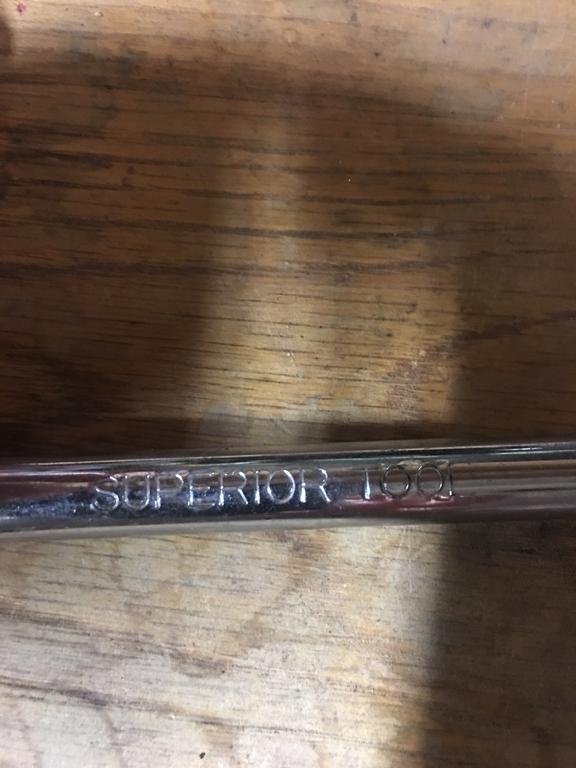

The Tuul Crib 7,340 #3 Posted March 10, 2019 Here’s a tool I have found to be very handy for this to particular thing . It is a plumbing tool I picked up at Home Depot a few years back. Fits perfectly on the drain plug 2 Share this post Link to post Share on other sites
rjg854 12,738 #4 Posted March 10, 2019 It's a faucet seat wrench, that should supply a lot of leverage. Share this post Link to post Share on other sites
pfrederi 19,520 #5 Posted March 10, 2019 1/4" allen wrench clean out teh crud that is in the hole first. 3 1 Share this post Link to post Share on other sites
The Tuul Crib 7,340 #6 Posted March 10, 2019 31 minutes ago, rjg854 said: It's a faucet seat wrench, that should supply a lot of leverage. It worked great for me! Share this post Link to post Share on other sites
