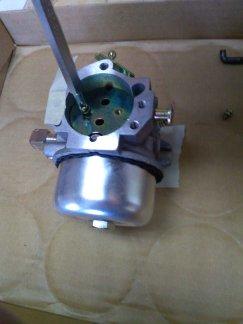

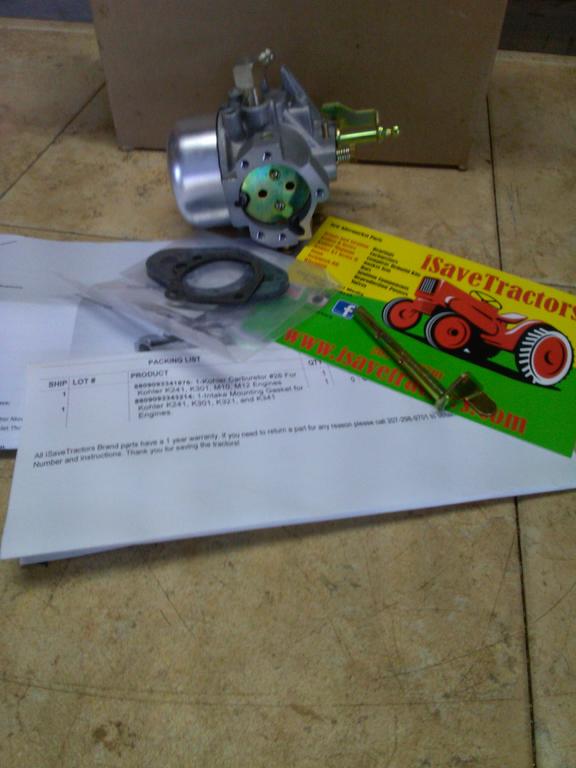

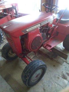

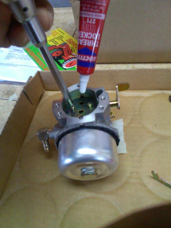

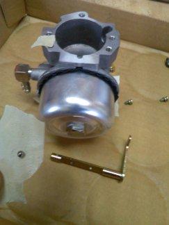

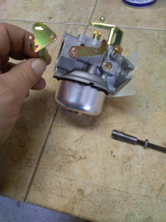

Herder 2,355 #1 Posted March 9, 2019 Carb cleanings and adjustments just weren't cutting it. The old Charger 12 was running like crap. New carb and gaskets sent straight to the door. 1 year warranty The shaft for the choke needed to be changed. Notice the tape on the left side of the carb!! Its there for a reason. That little BB is spring loaded and when you remove the shaft it fly's out, hits you in the eye and causes temporary blindness. Needless to say that BB is imposable to find once you've lost track of it. I use thread lock when reinstalling the screws. Runs like a top. choose files...---------Click to choose files.url 2 Share this post Link to post Share on other sites
