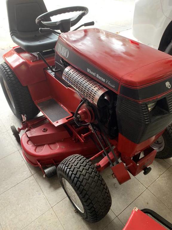

MattL 14 #1 Posted March 9, 2019 (edited) What do you guys think of this deal? It seems a bit high to me.. When I was younger, my friend and I did a somewhat "restore" on his grandads Wheel Horse mower. Really just a good paint job. I don't know what model it was but it was old. Metal seat old. Anyway, I have always wanted one since then. I would love to know what you guys think of this price, and the model in general. Thanks Edited March 9, 2019 by Sparky Removal of Craigslist link 3 Share this post Link to post Share on other sites

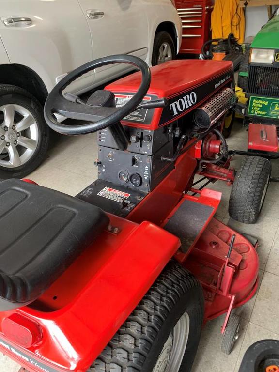

Sparky-(Admin) 24,633 #4 Posted March 9, 2019 Pretty sure that been repainted. I would be skeptical at $1500 and would want to go over it with a fine toothed comb. So here at Red Square we don’t allow posting links to Craigslist, Ebay, auctions etc. I removed your Craigslist link but added a few pics to your post of the 314H. 5 Share this post Link to post Share on other sites

oliver2-44 11,214 #7 Posted March 9, 2019 Sure looks like a rattle can paint job. Even in Texas where WH are somewhat scarce that price tag should be a mint condition tractor. 2 Share this post Link to post Share on other sites
Sparky-(Admin) 24,633 #8 Posted March 9, 2019 1 hour ago, oliver2-44 said: Sure looks like a rattle can paint job. Even in Texas where WH are somewhat scarce that price tag should be a mint condition tractor. Yep, that’s what I thought. Share this post Link to post Share on other sites

Skipper 1,790 #10 Posted March 9, 2019 (edited) No reason to beat around the bush on this. My little inner perfectionist nerd is screaming: RUN FORREST RUN!!! It looks like a very rough lick of paint, with not much (if any) focus on detail or quality. If that's a pointer to how the mechanical side of thing are, ..................................... In my book, a mint really really nice low hour 314H with perfect original paint and RD deck, can't even come close to that price tag. I know some dream about it, but let's be realistic. Doesn't matter how much of a WH fanatic you are, that thing is very very far from a 1500$ tractor. Looks a lot more like a 500$ worker to me. 1500$ should put you up for some of the nice and rare stuff if that's your thing, or it could put you behind the wheel of something bigger and way more decent than that. Just my Edited March 9, 2019 by Skipper 2 1 Share this post Link to post Share on other sites

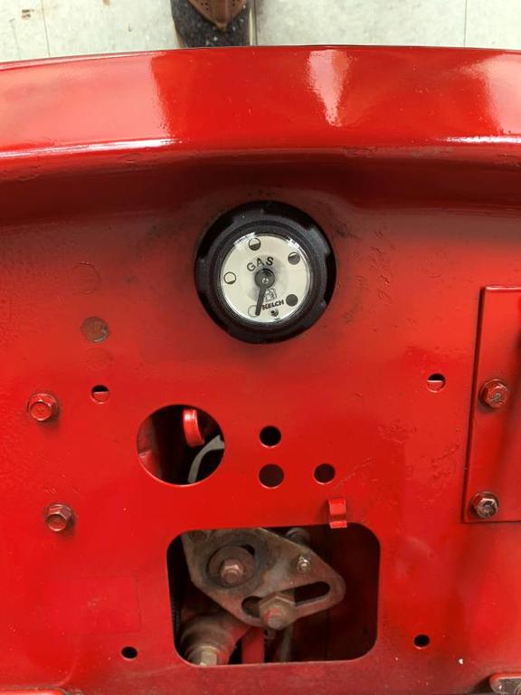

Digger 66 3,524 #12 Posted March 9, 2019 (edited) 8 hours ago, MattL said: Definitely has been "spruced-up" but evidence of grease near the yellow arrow shows that someone has looked after it a bit . The difference in paint color and attention to detail ( green arrows ) is obvious in the rattle can accusation . I'd offer around 800 beaver pelts if the rest of the machine checked out . As stated above : For 1500 bones , you will get a pile of worthless plastic garbage if you buy a modern "tractor" . Edited March 9, 2019 by Digger 66 Share this post Link to post Share on other sites

lynnmor 8,628 #16 Posted March 9, 2019 5 hours ago, Digger 66 said: Definitely has been "spruced-up" but evidence of grease near the yellow arrow shows that someone has looked after it a bit . Of course that is the one place that shouldn't be lubed. 3 Share this post Link to post Share on other sites
