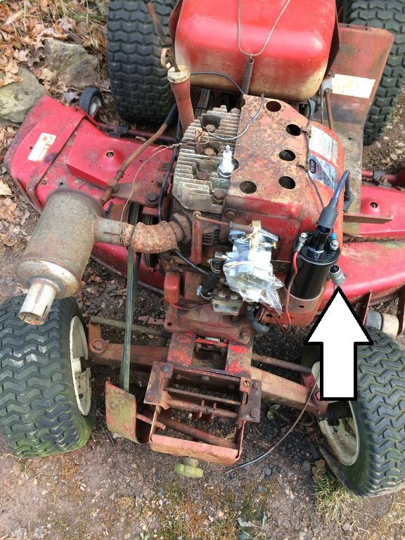

953 nut 63,955 #8 Posted March 5, 2019 The condenser is the little silver cylinder to the right of the ignition coil. Share this post Link to post Share on other sites
wallfish 19,068 #9 Posted March 5, 2019 Just making sure to ID it for him 1 Share this post Link to post Share on other sites
