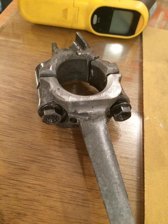

953 nut 69,592 #101 Posted May 1, 2019 Man, that is totally disheartening! The rod cap orientation is a likely to have caused the failure, regardless it is a real shame. 1 Share this post Link to post Share on other sites
HappyHillbilly 86 #102 Posted May 1, 2019 (edited) 45 minutes ago, oldredrider said: That's a heartbreaker for sure. My guess is something wrong with the rod installation. Rod appears to be an oversize (.010). What did the crank mic? Was the rod cap installed with the proper orientation? You'll have to do some investigating to find the reason. Sorry about all that work going south. The rod was for a -.010” crank & installed the same way I took it out. I took a lot of photos as I disassembled to ensure proper re-assembly. With the starter hanging up on the first crank attempt & the block cracking right at the starter leads me to think that the starter gear & flywheel got locked up. But I’m not sure. Oh, well - at least I’ve got s nice showroom engine. I’m gonna JB Weld the 2 pieces of the block back in - put a plate of glass on top of it and sell it as a coffee table. Haha!! Edited May 1, 2019 by HappyHillbilly 1 Share this post Link to post Share on other sites
HappyHillbilly 86 #103 Posted May 1, 2019 (edited) 7 minutes ago, 953 nut said: Man, that is totally disheartening! The rod cap orientation is a likely to have caused the failure, regardless it is a real shame. It would be even worse if I find out for sure it was something this idiot (me) did. I’ll have to go & review my disassembly photos to see if I can tell. Edited May 1, 2019 by HappyHillbilly 1 Share this post Link to post Share on other sites
HappyHillbilly 86 #104 Posted May 1, 2019 OK - the piston, connecting rod and end cap were installed the way they came out, which I believe is the right way because before I tore it down I had it turning over without any clanking. Here's one of my disassembly photos for verification. Share this post Link to post Share on other sites

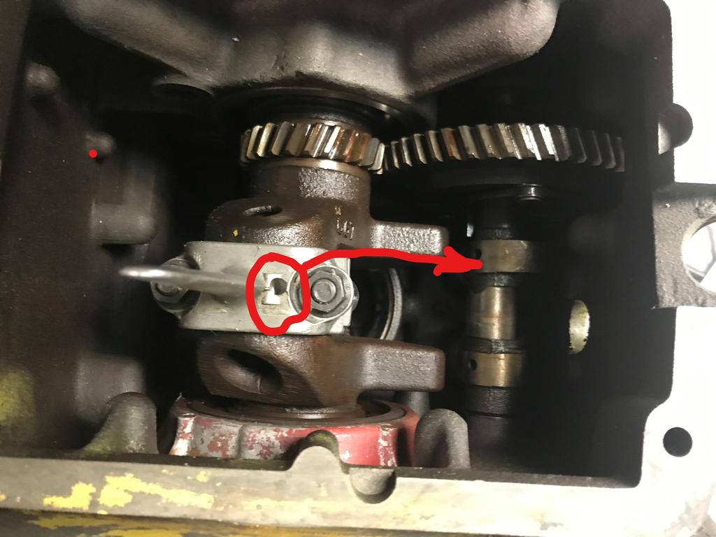

oliver2-44 11,758 #105 Posted May 1, 2019 Do you have a picture with the block upside down looking at the connecting rod and crank shaft . You should verify the oil hole in the connecting rod was in the right orientation so oil was getting to the crankshaft journal. As shown in this picture the oil hole (circled in red) should be on the cam shaft side of the block (arrow point to cam shaft) 1 1 Share this post Link to post Share on other sites

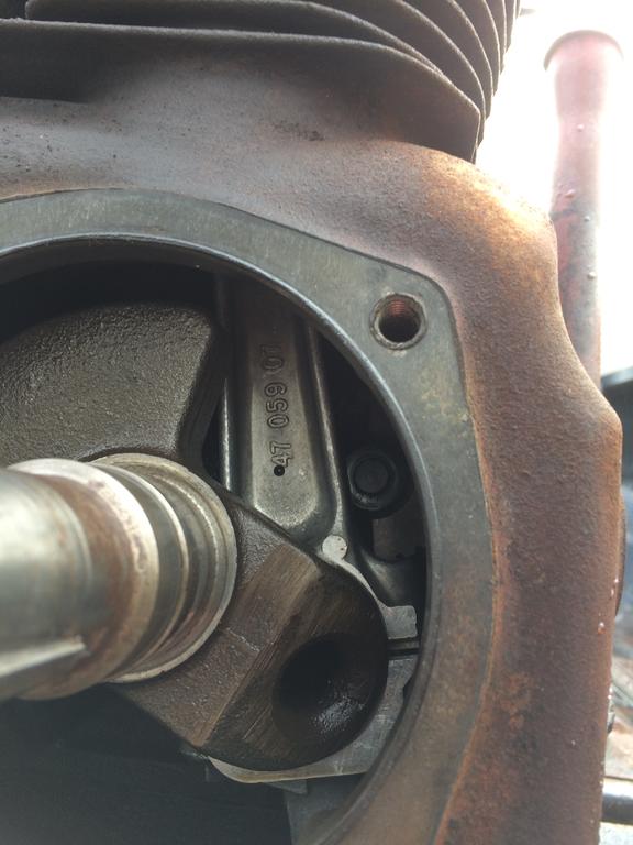

HappyHillbilly 86 #106 Posted May 2, 2019 3 hours ago, oliver2-44 said: Do you have a picture with the block upside down looking at the connecting rod and crank shaft . You should verify the oil hole in the connecting rod was in the right orientation so oil was getting to the crankshaft journal. As shown in this picture the oil hole (circled in red) should be on the cam shaft side of the block (arrow point to cam shaft) No, I don’t have a photo after re-assembly verifying that, just the one of the damage. In the photo below you can see the oil hole is on the left and that there’s a mark on the connector just to the right of it. My disassembly photo shows that mark as being on the left. All of this is as viewed from bearing plate side of engine. I’m 95% sure rod, connector, etc..., were installed & torqued right. There’s no marks, scuffs or bends in the slinger, either. The clattering I heard was not rhythmic like I’d expect from a revolution issue. It was a bit sporadic & appeared to be in conjunction with the movement of the extended starter arm/gear. it was more like; “clang, clang-clang, clang, clang, clang-clang.” i really appreciate ya’ll’s questions & thoughts. Thank you much! Share this post Link to post Share on other sites
