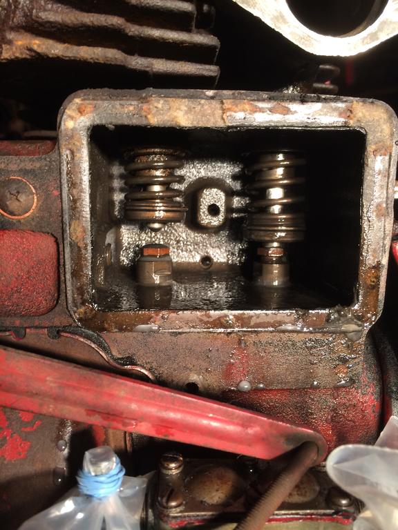

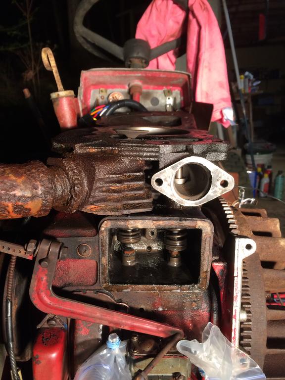

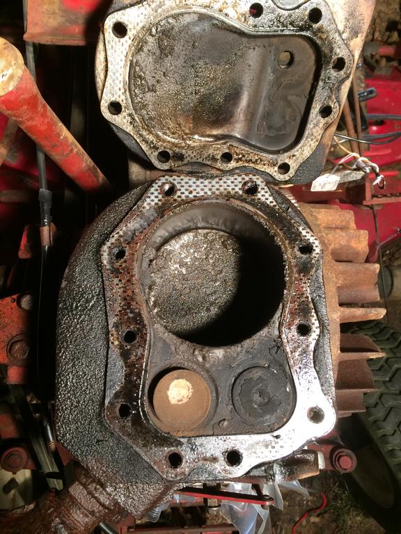

HappyHillbilly 86 #30 Posted March 7, 2019 (edited) I got the head & breather plate removed today. Man, it's not a pretty sight. I know one of the valves is stuck - I believe it's the exhaust valve. Piston & other valve move freely when turning flywheel by hand. I'm going to try to borrow a bore gauge tomorrow. As a former machinist I know you can't get an accurate I.D. measurement with calipers, but, I tried anyway and got a fairly steady reading from various points around the cylinder of 3.7685". Looking at the Kohler manual that's a wee(?) bit over the margin. Cylinder wall looks good, though. But my wife says that looks ain't everything. (she found out the hard way) Edited March 7, 2019 by HappyHillbilly Grammar Share this post Link to post Share on other sites
oldredrider 2,553 #31 Posted March 7, 2019 It is a bit crusty. Should buff out! Seriously, typical of a motor that has set for a long time. 3 Share this post Link to post Share on other sites

HappyHillbilly 86 #33 Posted March 7, 2019 Thanks, "oldredrider" & "bcgold". I was able to get the valve to move up & down with little force but it doesn't look like it's gonna smooth out on its own that way. I'm taking engine off tractor this afternoon and get it inside to clean it up & disassemble it. I can hear Conway Twitty singing "I can tell you've never been this far before. Bum, bum, bum bum,,," Haha!! But I'll make it. Question - What's the best way the pull out the sticky valve without a special tool? It's not gonna take a LOT of pressure to get it out, I just can't twist or pull it by hand. 1 Share this post Link to post Share on other sites
oldredrider 2,553 #34 Posted March 7, 2019 Penetrating oil like Kroil or BG Inforce should loosen up the carbon build up on the valve stem. Patience is your friend! It will come out when the carbon breaks down. 1 Share this post Link to post Share on other sites
HappyHillbilly 86 #35 Posted March 7, 2019 14 minutes ago, oldredrider said: Penetrating oil like Kroil or BG Inforce should loosen up the carbon build up on the valve stem. Patience is your friend! It will come out when the carbon breaks down. Thanks! I'll get me some of one of those. PB has worked so far but it looks like it's just not strong enough for this as I sprayed it good last night. Appreciate it! 1 Share this post Link to post Share on other sites
ebinmaine 80,772 #36 Posted March 7, 2019 I'll second the patience thing. PB is ok for some things but I've gone away from using it. I've had great success with Kroil. Also the old Liquid Wrench. $4-$6 a can is really tough to beat and it works well statistically and in the field. Penetrating oil is like many other things where each of us can have a pretty wicked brand loyalty. Glad to see you are attacking this Engine and Tractor. Keep asking questions.... 1 Share this post Link to post Share on other sites

HappyHillbilly 86 #40 Posted March 7, 2019 22 minutes ago, 953 nut said: Take a look at this thread, it has a lot of great information and even though it is a smaller engine the process is the same. Thank you! I bookmarked that thread. 8 minutes ago, clueless said: Blaster small engine tune up in a spray can, been around for years. I've used it for years on small engines and outboards after they sat for a season or two. Last time I clean the carbon of a kohler head, valves and piston i was out of Kroil, shot some of this stuff on and let it sit awhile, used a plastic scraper and a small brass brush, cleaned up nicely . It's made by the same people who make PB Blaster, just another cheap tool to add to your arsenal if you work on small engines. Thanks! Question: I checked the head for flatness. If I'm not mistaken manual says .003" tolerance - Mine has a few places that are between .003 - .004". That should be OK, 'eh? 1 Share this post Link to post Share on other sites
Ed Kennell 47,403 #41 Posted March 7, 2019 I would rub the head perfectly flat by rubbing it on a piece of 320 or 400 grit emery cloth taped to a piece of glass. After the head is cleaned of all carbon, paint it with magic marker or machine bluing, then rub it in a figure 8 pattern on the emery cloth till all the high spots are removed. 2 1 Share this post Link to post Share on other sites

richmondred01 2,393 #43 Posted March 8, 2019 Standard bore for k341 is 3.750 Ive rebuild countless k series in this shape. yes the k341 is worth Rebuilding. In my opinion the k341 and m16 were the best single cylinder engines ever built. bore the cylinder, most likely the crank will need to be turned, grind the valve seats and plain the head. Replace with quality parts and your engine, at least in my area, should be worth 1000.00. 3 Share this post Link to post Share on other sites
HappyHillbilly 86 #44 Posted March 8, 2019 21 hours ago, Ed Kennell said: I would rub the head perfectly flat by rubbing it on a piece of 320 or 400 grit emery cloth taped to a piece of glass. After the head is cleaned of all carbon, paint it with magic marker or machine bluing, then rub it in a figure 8 pattern on the emery cloth till all the high spots are removed. Thank you, Ed! That sounds like a good idea & I'll do just that. 3 hours ago, Sarge said: Look up a home penetrant called "Ed's Red" - that will quickly break down the carbon in that valve so it can come out easily and will also dissolve the buildup of material on top of the piston. Quite cheap to make decent sized quantities, but be aware of flammability and it will easily evaporate the acetone when you try to store it. Sarge Thanks, Sarge! Unfortunately I can't use Ed's Red - it says in the Safety Notice; "Keep them (chemicals) away from pets and stupid people." Haha! that rules me out. Seriously though, gonna mix me up some. 1 hour ago, richmondred01 said: Standard bore for k341 is 3.750 Ive rebuild countless k series in this shape. yes the k341 is worth Rebuilding. In my opinion the k341 and m16 were the best single cylinder engines ever built. bore the cylinder, most likely the crank will need to be turned, grind the valve seats and plain the head. Replace with quality parts and your engine, at least in my area, should be worth 1000.00. Thanks, "richmondred01". I'll borrow a bore gauge and hope & pray that this one's been bored .020" over and isn't out of round or specs. With my caliper readings being 3.7685" I just "might" be in luck. Ya'll have a great day! HH Share this post Link to post Share on other sites
richmondred01 2,393 #45 Posted March 8, 2019 You can go .030. you have to measure the center of the bore in several places. 2 Share this post Link to post Share on other sites

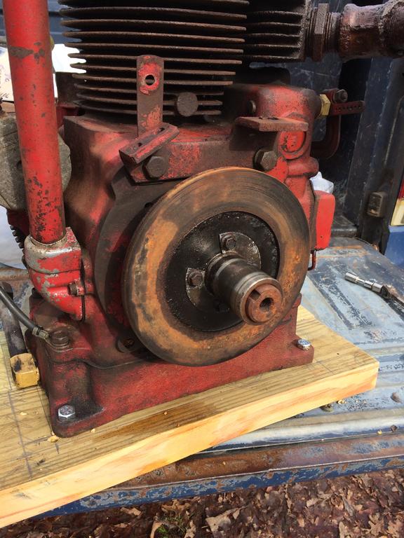

HappyHillbilly 86 #46 Posted March 9, 2019 OK, folks - before I mess something up - how do I get this (brake/pulley?) off? Thanks! Share this post Link to post Share on other sites
richmondred01 2,393 #47 Posted March 9, 2019 That’s the pto disc. remove the four bolts and retainers, disc may be tight but will slide off. The bearing race can be difficult at times. Use heat and pb blaster in key way. 3 Share this post Link to post Share on other sites
richmondred01 2,393 #48 Posted March 9, 2019 Then use a three jaw puller to remove the drive pulley. don't forget the Allen set screws. 3 Share this post Link to post Share on other sites
953 nut 69,571 #49 Posted March 9, 2019 Speaking of Allen set screws, Wheel Horse sometimes used two of them. The first one is down tight on the key and the second one is tighten on top of it as a lock to keep the first one tight. 1 Share this post Link to post Share on other sites
HappyHillbilly 86 #50 Posted March 9, 2019 Thanks for your promptness! Good timing. I was stopped at a traffic light one block from auto parts store to get a pulley puller because I don’t know what happened to the one I had. Richard - Looks like there are 1-2 allen screws behind that disc. There are 2 holes. Thank you two!!! Share this post Link to post Share on other sites
