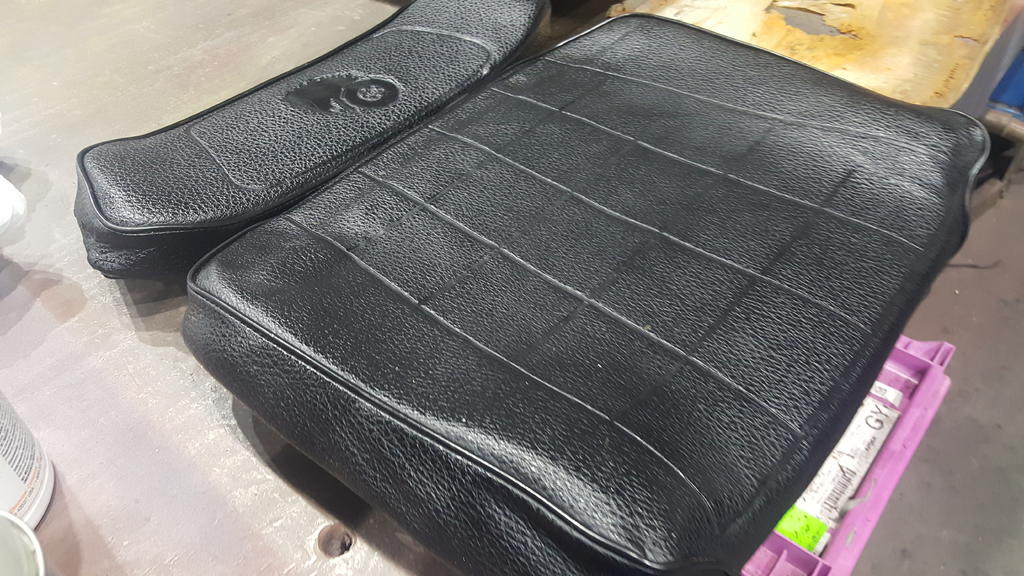

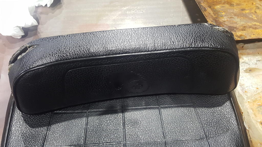

bellevillerod 835 #1 Posted March 3, 2019 I have started to redo a seat on my commando. I have the same rips on mine that I see on many others. Top corners have come apart and allow water in. Other than that the seat is in great shape. I plan on blasting the metal pan and painting it. How have others fixed the corners, I want to keep the back original. 2 Share this post Link to post Share on other sites
Ed Kennell 43,783 #2 Posted March 3, 2019 I have taken the back cushion apart and saved the front. Then sewed in a new piece of vinyl around the outside. 1 Share this post Link to post Share on other sites

SPINJIM 1,986 #5 Posted March 3, 2019 If you don't want to struggle with 'Do It Yourself" sewing, find a furniture upholstery shop or car upholstery shop nearby. There are some jobs that should be farmed out to someone with more experience. The job will turn out better. Jim 4 1 Share this post Link to post Share on other sites
bellevillerod 835 #6 Posted March 3, 2019 1 minute ago, SPINJIM said: If you don't want to struggle with 'Do It Yourself" sewing, find a furniture upholstery shop or car upholstery shop nearby. There are some jobs that should be farmed out to someone with more experience. The job will turn out better. Jim You read my mind, for something this small and me doing the bulk of the work. I can't see that it would cost much at all to have someone with a professional machine and skill set do the sewing for me. The lady who sews my patches on my cycle leathers should be able to knock this out in seconds. A one time done an forget it kind of thing. Now I am thinking that I might want to heat an undo the glue on both and replace the foam as it is on it's last leg. Not much give in the seat on these tractors, might make it ride a little nicer. 1 1 Share this post Link to post Share on other sites

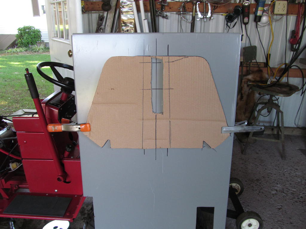

Ed Kennell 43,783 #7 Posted March 3, 2019 One thing I always do when rebuilding these two cushion seats. I cover the edges of the inner plates with duct tape to prevent the damage that you have on your back cushion. My Commando 8 seat built from scratch. 2 3 Share this post Link to post Share on other sites

bellevillerod 835 #10 Posted March 5, 2019 17 minutes ago, Ed Kennell said: I actually don't use any adhesive. I use a hole punch to punch holes about every inch around the edge of the vinyl, the lace it together with a waxed taxidermy chord. I found this way I can adjust the tension on the cushions an keep it taunt when I bolt it to the seat pan. Is this with the original seat material or with new vinyl? I am thinking it might want to rip the 50yo vinyl when pulled taunt. Ed this is the seat bottom I'm talking about, I am taking your advice and having new vinyl sewed to the upper seat back. The lower cushion just needs new inner foam the vinyl is excellent with no rip's. I'm soaking the old foam in a cleaning solution now and am going to see if it's savable to reuse with some added foam to give it the height and cushion it once had. Share this post Link to post Share on other sites
