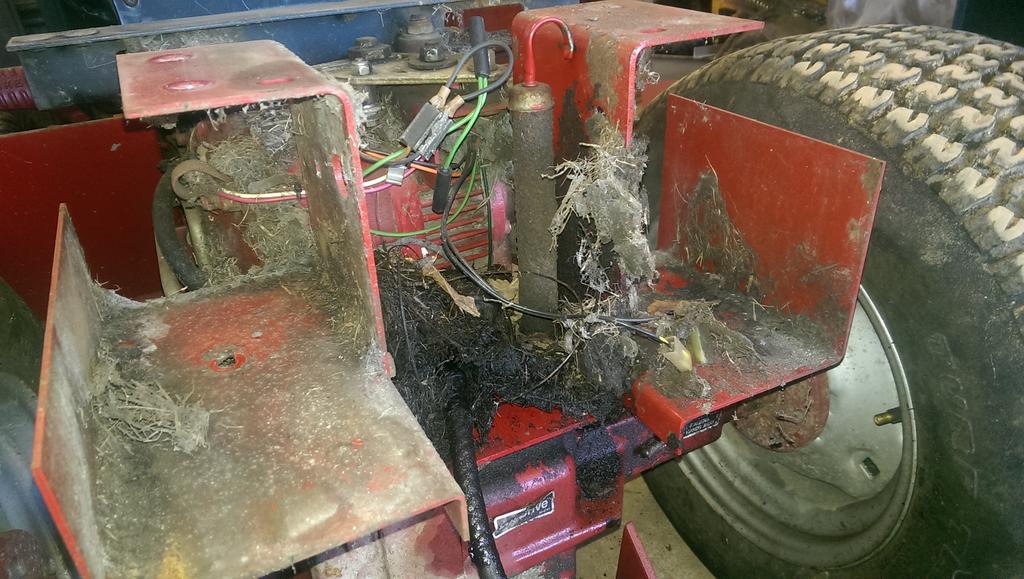

lynnmor 8,628 #13 Posted March 4, 2019 Since you had so much hay, be sure to pull the seat, then fender and the gas tank. That hay will rust the heck out of the seat support. Clean up and sandblast the seat support if necessary, then paint. I actually do this every fall after the grass season so that the snow season doesn't keep it wet. Share this post Link to post Share on other sites
WVHillbilly520H 10,378 #14 Posted March 4, 2019 1 minute ago, lynnmor said: Since you had so much hay, be sure to pull the seat, then fender and the gas tank. That hay will rust the heck out of the seat support. Clean up and sandblast the seat support if necessary, then paint. I actually do this every fall after the grass season so that the snow season doesn't keep it wet. Or so doesn't turn out like this one... 1 1 1 Share this post Link to post Share on other sites
Lee1977 7,553 #15 Posted March 4, 2019 (edited) It looked a lot worse then that one. Had 1/2" of grass on top of the gas tank that had already turn into a solid mass. I got the rear fender area then i pulled another panel off the dash tower. If a Wheel Horse every needed saving this is one of them. I think it would have been completely rusted out in another 3 or 4 years. Edited March 4, 2019 by Lee1977 2 1 Share this post Link to post Share on other sites
