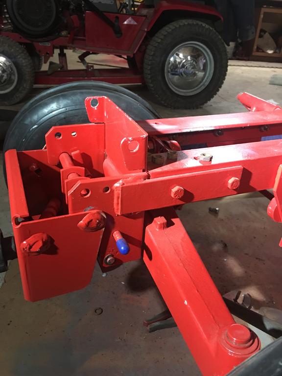

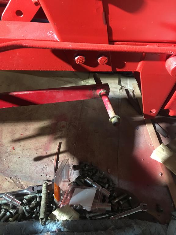

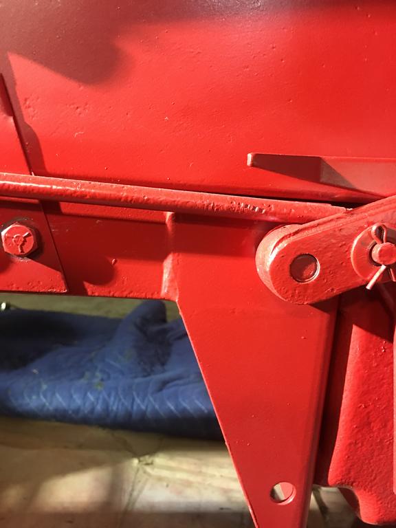

The Tuul Crib 7,340 #1 Posted March 2, 2019 Things have been going pretty smooth up to now. I was looking at the lift arm to attach on the frame and realized there are no holes on this frame. Now the tractor is a 1967 model 1067 a somewhere down the line the PO got the attachment to put on the frame in front to use a newer style mule drive and use a newer deck. That all fit great. Now today when I got to lookin closer I can’t use the lift arm because there are no holes. I guess I can disassemble every thing and drill the necessary holes. But I’m thinking if they made the bracket for the mule drive in front what do you suppose they had in mind to use a newer lift arm in the rear? What are the two holes below this point do? 1 Share this post Link to post Share on other sites
ebinmaine 76,036 #2 Posted March 2, 2019 I don't have the answer for you but maybe @Stepney could help? 1 Share this post Link to post Share on other sites
Racinbob 12,440 #3 Posted March 2, 2019 I see no reason you couldn't use the older lift arm. That's probably what they planned. The lower holes are for certain attachments. A side sickle bar mower is one that comes to mind. 1 Share this post Link to post Share on other sites
Lee1977 7,464 #4 Posted March 2, 2019 Some was asking that same thing a week or so ago and no body gave an answer. I think you need to pull the belt guard and drill some holes if you want to use the lift bar. I would locate the holes and drill a 3/16" hole each side first, it will make drilling the larger holes a lot easier. The bushing side is 5/8" and the 1/2" hole doesn't go all the way through on the later models. You will have to drill the shaft for a carter key and washer on the inside of the frame on the right side. Share this post Link to post Share on other sites
Ed Kennell 43,915 #5 Posted March 2, 2019 My guess is, his plan was to just use a chain directly from the lift lever to the deck. 1 Share this post Link to post Share on other sites
Stormin 9,987 #6 Posted March 2, 2019 The two holes in the first photo, do take a sickle bar. Share this post Link to post Share on other sites
The Tuul Crib 7,340 #7 Posted March 2, 2019 12 minutes ago, Stormin said: The two holes in the first photo, do take a sickle bar. I’ve often wondered what they are for . They have to have a porpus! Share this post Link to post Share on other sites
Stormin 9,987 #8 Posted March 2, 2019 There you are. Share this post Link to post Share on other sites
The Tuul Crib 7,340 #9 Posted March 2, 2019 29 minutes ago, Stormin said: There you are. What attachment is that? Share this post Link to post Share on other sites
Stormin 9,987 #10 Posted March 2, 2019 Sickle mower. Rear mount. 1 Share this post Link to post Share on other sites
Stormin 9,987 #11 Posted March 2, 2019 Look up my topic. Sickle bar fun. Restorations etc 2017. Share this post Link to post Share on other sites
Stepney 2,357 #12 Posted March 2, 2019 I've been pondering this situation for some time now. Came to find through old paperwork that WH offered a special offset lift rod to use the newer decks, in conjunction with the newer lift assembly. If you use the original lift rod on the newer deck, it will hit the steering support. On my 68 Electro 12 it was missing the hand brake and rods. The holes that happened to be there fit a C-160 lift bar perfectly and the original C trunnion rod worked. It lifted a deck as designed.. but now the holes for the hand brake/tensioner are occupied. On a gear drive, I don't see why you cant make those holes. Or just make up an offset rod. I have not yet found anyone with dimensions of this special offset rod. The other way to do it would be a chain down to a lower point on the rear of the deck. As I understand it, doing this may cause it to lift off kilter. I have yet to get in the shop and really get my hands on mine. 2 Share this post Link to post Share on other sites

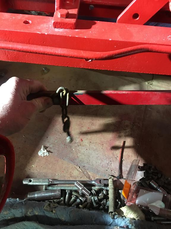

squonk 44,967 #14 Posted March 3, 2019 I rigged up a chain to lift a modern deck on my 1267. And having that bracket on the front also lets you run the newer style snowblower and if you have a worn out mule, you make a clip,on front weight out of it! Share this post Link to post Share on other sites

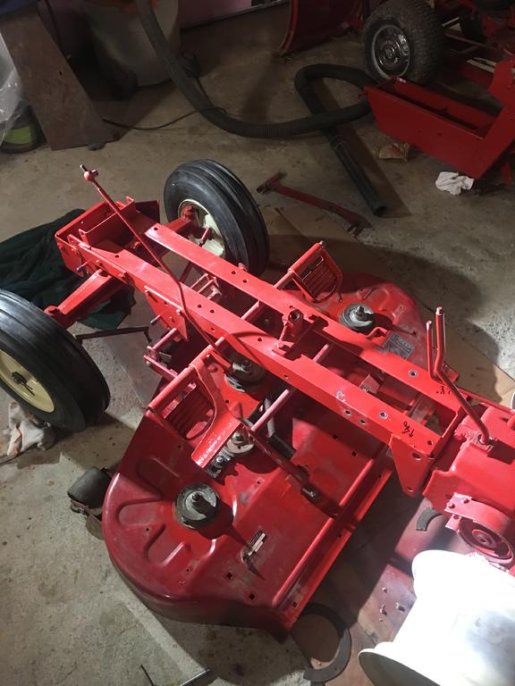

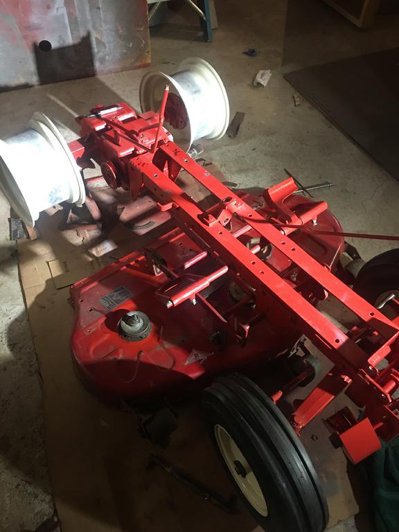

The Tuul Crib 7,340 #15 Posted March 3, 2019 I have not yet found a part number or a pdf for this adapter for the mule drive. I’m thinking it must have meen made by someone and they must have known what they were doing. Now this morning I attached this deck off of my 414-8 and everything lines up. Share this post Link to post Share on other sites

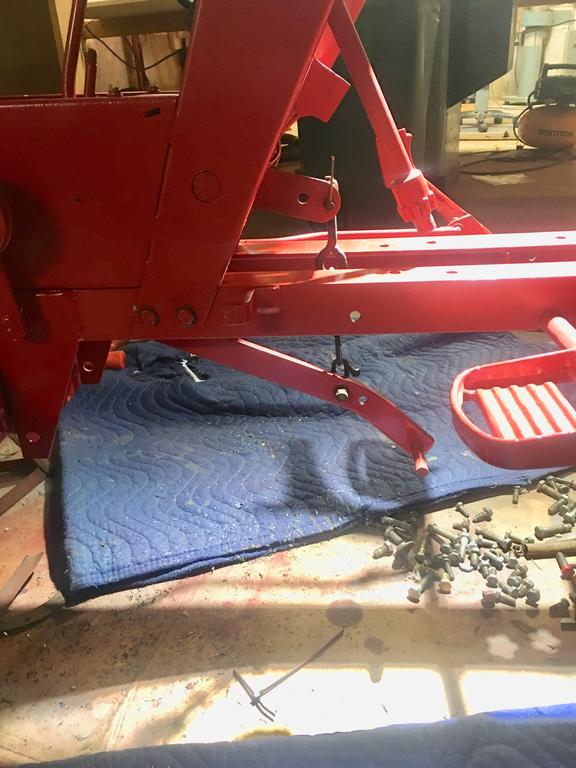

The Tuul Crib 7,340 #17 Posted March 3, 2019 Just got done drilling the holes necessary and putting lift arm in place. It all lines up perfectly. New meets old!! 1 2 Share this post Link to post Share on other sites
